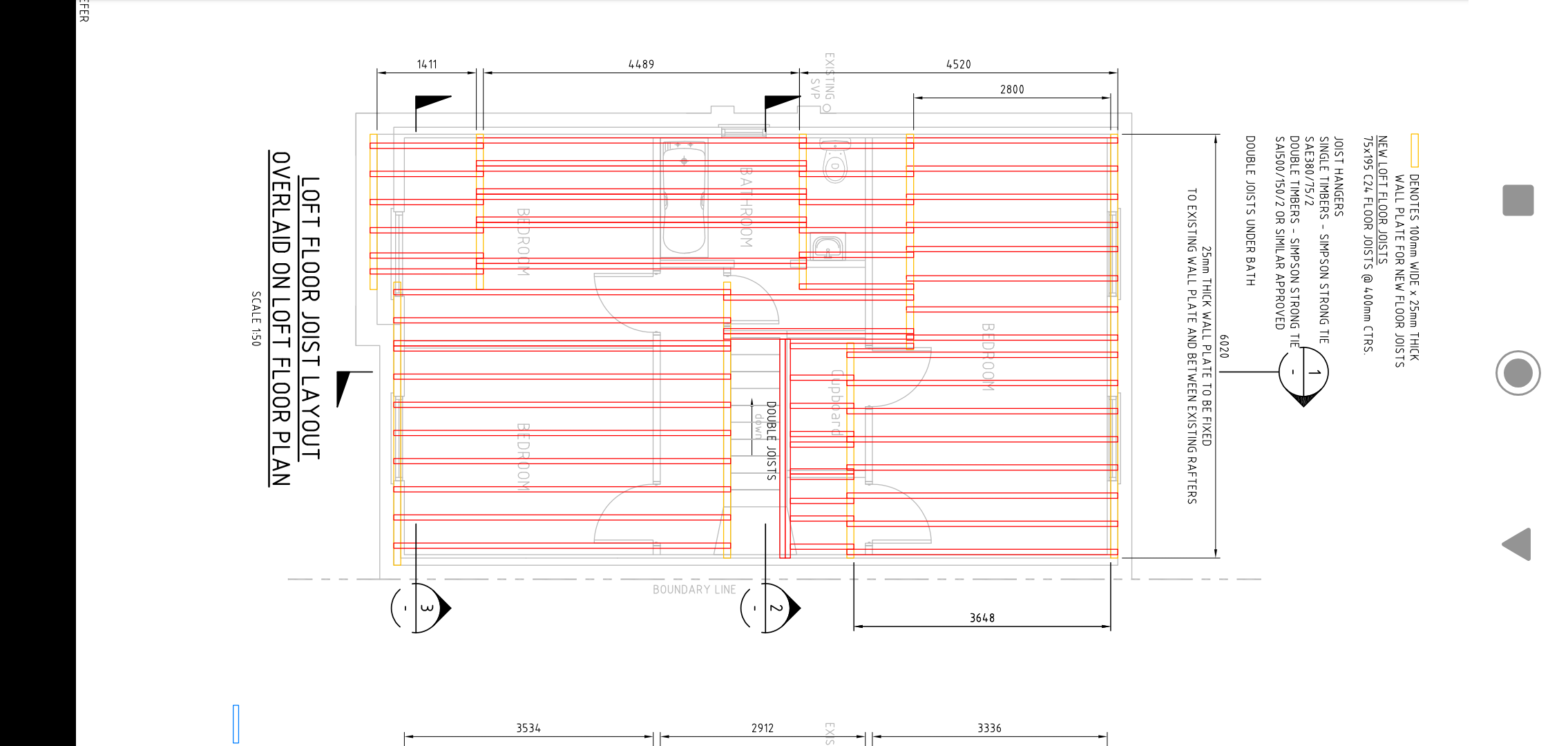

DIYjake Posted May 10, 2020 Share Posted May 10, 2020 I have a dormer bungalow that was built in 1969. I've had structural drawings made up to extend the front and rear dormers out as far as possible. The current joists are 100x150 at 400 centers. The drawings specify for the joists to be 75x195 and raised 25mm and to be doubled up below the bathroom. The longest span is 4584mm. One of the carpenters/builders has said that doubling up the current joists will be substantial enough and has been in contact with building control who seem to agree but haven't yet visited I have a gut feeling that it should be done to drawing. Any thoughts? Link to comment Share on other sites More sharing options...
tonyshouse Posted May 10, 2020 Share Posted May 10, 2020 Yes, if you are very clever you get away without raising them up the 25mm , humps up and secured to existing ceiling joists, wires are usually the problem Link to comment Share on other sites More sharing options...
nod Posted May 10, 2020 Share Posted May 10, 2020 SE will tend to over spec Your joiner is probably right But BC will want you to follow the drawing you have Link to comment Share on other sites More sharing options...
PeterW Posted May 10, 2020 Share Posted May 10, 2020 SEng is correct - the 100x150 isn’t deep enough for that span to not bend in the middle - 195mm is barely good enough but assume he’s got you bolting them together ..?? Link to comment Share on other sites More sharing options...
bassanclan Posted May 10, 2020 Share Posted May 10, 2020 If you look at the Trada span tables 195x75 is just enough to span 4.96m If you want to reuse existing joists at 100x150 I would sat doubling up will be fine, but I'd want them glued and bolted together which may take more labour than simply putting in new correctly sized timbers. Also double check the joists really are 100x150. That is suprisingly beefy for the 60s. Link to comment Share on other sites More sharing options...
DIYjake Posted May 10, 2020 Author Share Posted May 10, 2020 Thanks for the input all. I've told the likely builder that I want to stick with the drawing for peice of mind more than anything, I don't fancy this biting me down the line by not going to drawing Sorry, the joists are 150x50. No idea why I put x100. Link to comment Share on other sites More sharing options...
