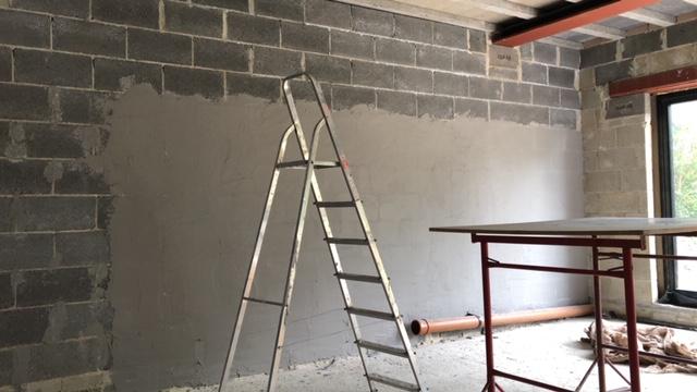

Cambs Posted May 5, 2020 Share Posted May 5, 2020 55 minutes ago, epsilonGreedy said: No not heard of that before, I will look at the video later. With a big tub priced around £100 I think the sealant would be best used for treatment of specific areas such as service penetrations or joist ends. I think I have 200 m2 of internal block wall. One of my next jobs is to get an airtight seal on the block walls shown in the picture below. I’ll be doing a parge coat using Gyproc Soundcoat Plus at about £7 - £8 a 25kg bag (assuming I can find it somewhere, at the moment) which will cover 5m2 at 6mm thick. It’ll be behind plasterboard, so my dodgy plastering skills will be well hidden! I looked at Blowerproof and PassivePurple but at about £10/m2 it’s too expensive for large areas. Link to comment Share on other sites More sharing options...
DaveH Posted May 5, 2020 Share Posted May 5, 2020 I'm in the process of applying parge coat to my walls at the moment. It's easy enough to apply with a hawk and trowel and doesn't need to be too smooth as it will be boarded over and covered up. Like plaster (or any gypsum product) the shelf life isn't very long so only buy when you're ready to use it. I negotiated Gyproc Soundcoat for £5.80 per bag from CCF. 1 Link to comment Share on other sites More sharing options...
