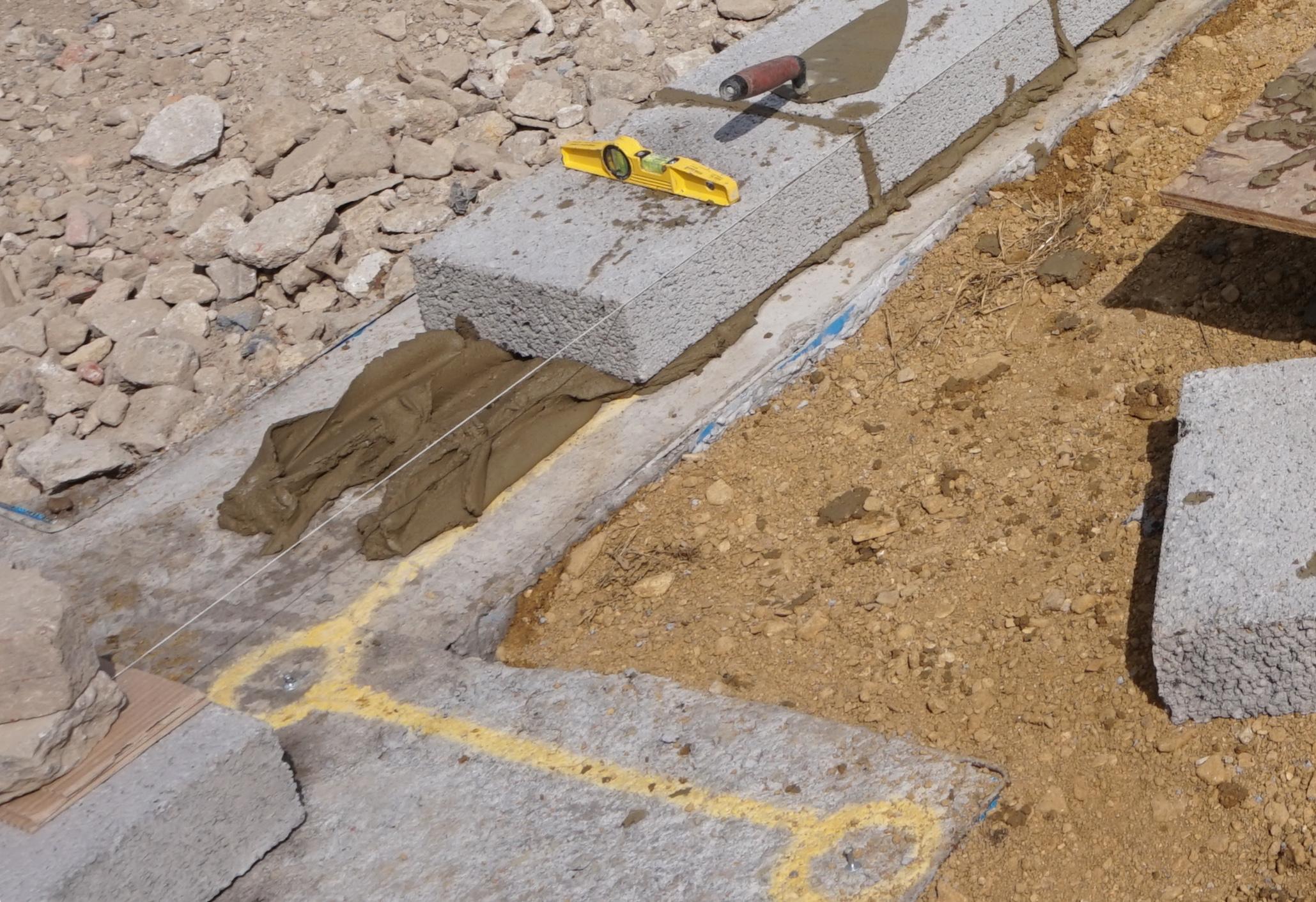

dnb Posted May 3, 2020 Share Posted May 3, 2020 ...you get all the corner blocks bedded in, double check the measurements at the end and find the last diagonal (and only the last diagonal) is short by 10mm? Grrr. That's an afternoon I won't get back. Link to comment Share on other sites More sharing options...

dnb Posted May 4, 2020 Author Share Posted May 4, 2020 I did the original survey at ground level and all was good to 3mm when the 1st course of blocks went down. The error has most likely crept in from the beam and block floor - made to nearest 25mm if you are lucky... It is all manageable, just a lot of messing around I didn't want to do swwing as i am the builder until who knows when... (can I sack myself? ?) Going to chase perfection again tomorrow. Link to comment Share on other sites More sharing options...
dnb Posted May 6, 2020 Author Share Posted May 6, 2020 (edited) I found out tonight that my daughter has named all the corners of the house. Presumably this is like a racing circuit, so she can commentate about where I am rushing to with my tape measure. We have Datum, Garage, Hammer, Digger, GRRR and Cursed. The last probably because I moaned about it never being right. The largest error is now 4mm (and this is within measurement error given the length) so happy days. A bit of trig indicates my corner angles are: cursed corner 89.992deg garage corner 90.004deg digger corner 89.964deg GRRR corner 89.962deg Hammer corner 90.058deg datum corner 90.026deg Of course, this assumes I have measured correctly to the accuracy of my class 1 tape. Edited May 6, 2020 by dnb 5 Link to comment Share on other sites More sharing options...
