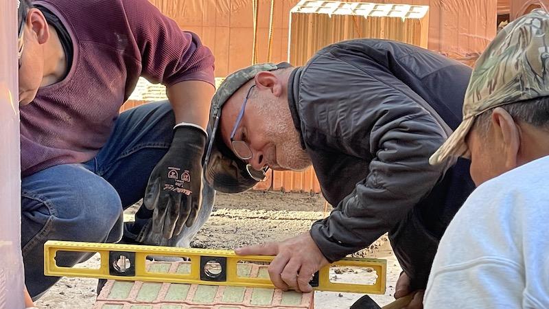

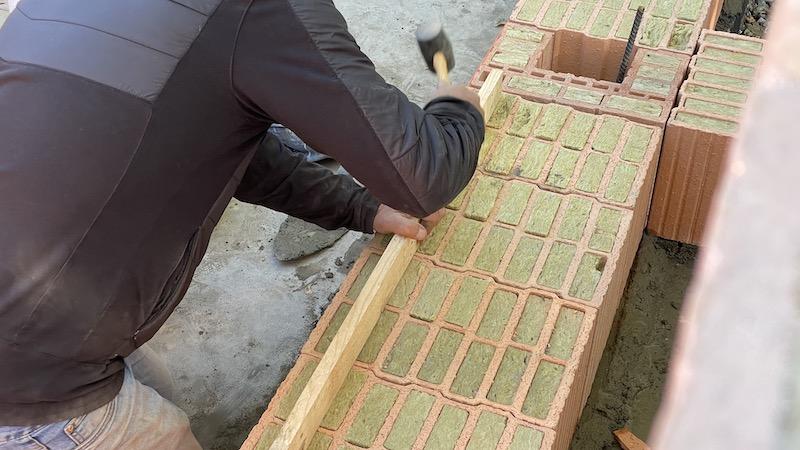

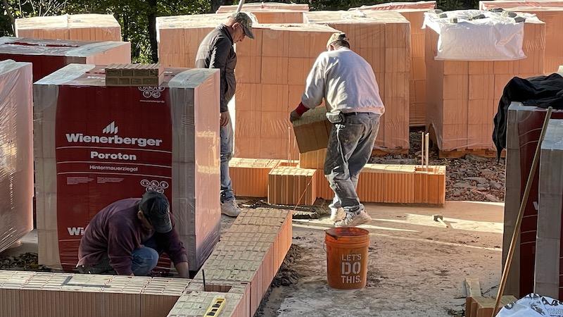

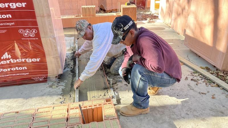

Gary in New York Posted September 26, 2022 Share Posted September 26, 2022 (edited) I'm too tired to think coherently tonight, but here are some pics: Spent 3 days getting the 1st course right, training masons to work precisely. The next layers went up so quickly I didn't get any early pictures Edited September 26, 2022 by Gary in New York Add captions to pics 2 Link to comment Share on other sites More sharing options...
