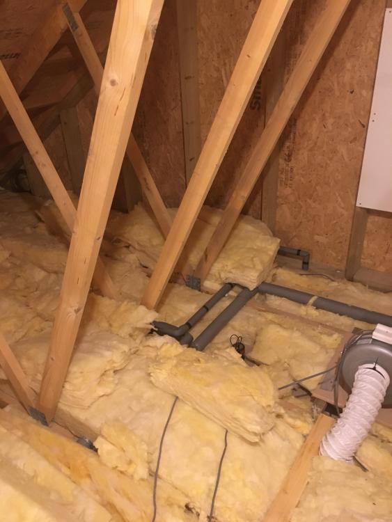

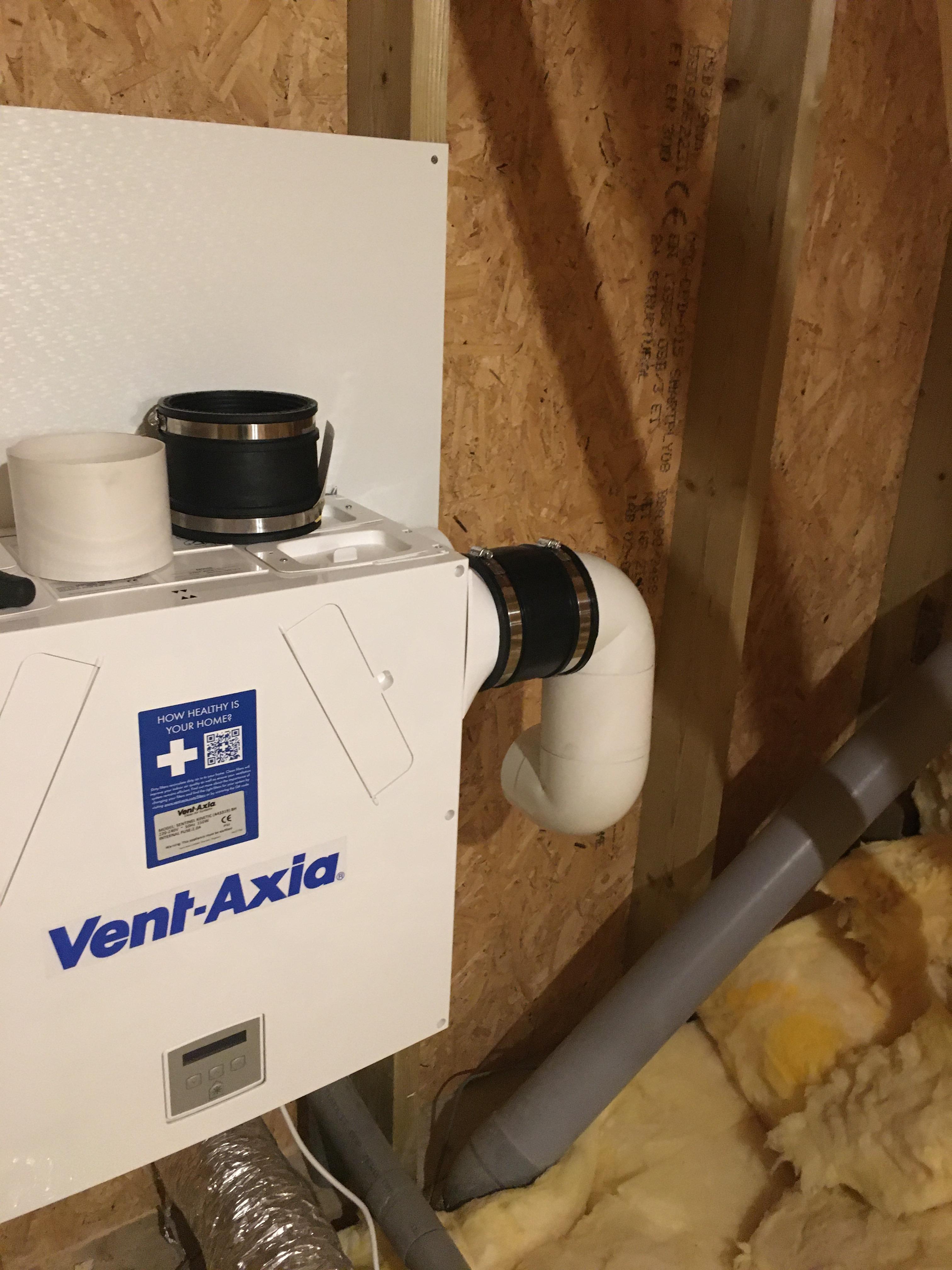

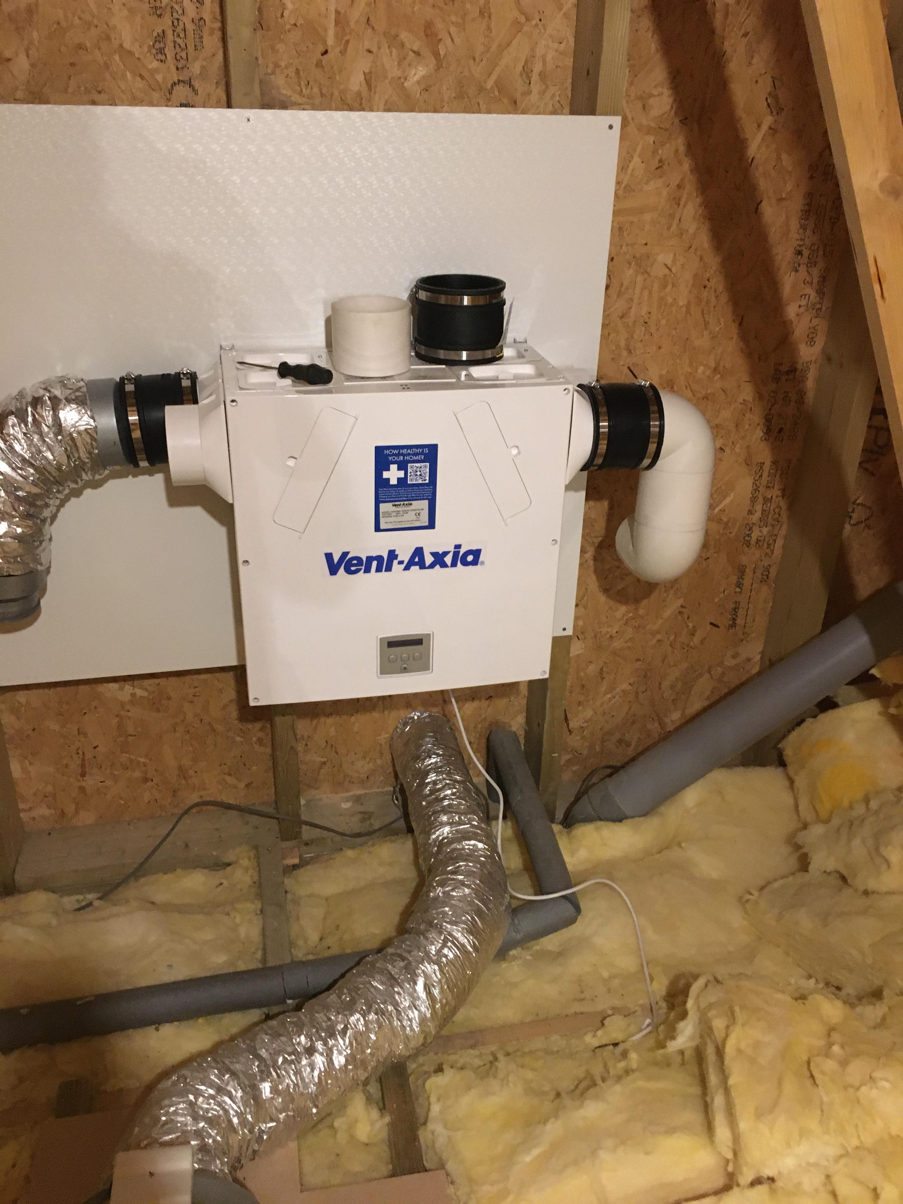

Ok, so I have fitted the unit, & all the pipe work etc.
I have run the system to test it & there seems to be very little extract flow, inlet is fine at 30% & 50% etc. The extract doesn’t feel like it gets any better with boost etc.
There is plenty of flow from the exhaust side. All pipe work is correct & tight.
I have opened the inlet valves around 3 turns open.
The summer bypass doesn’t activate & it doesn’t seem to detect humidity.
Any ideas or suggestions?

You can't 'feel' negative pressure/flow as easily as the supply.
Are you feeling it at the port on the MVHR unit or at the end of a duct run?
Once you cover an extract duct the flow drops to zero and it certainly doesn't feel as though anything us happening compared to an inlet where there is a rush if air pushing behind it.
There are also separate settings for the extract compared to inlet, so you may get have to check the values also are at 30% and 50% as a starting point to match inlets.
@JFDIY it feels fine at the port on the unit, just way less at the extract valves. I will have an anemometer next week so I should be able to see what it is actually doing. Just seemed very little on the extract.
