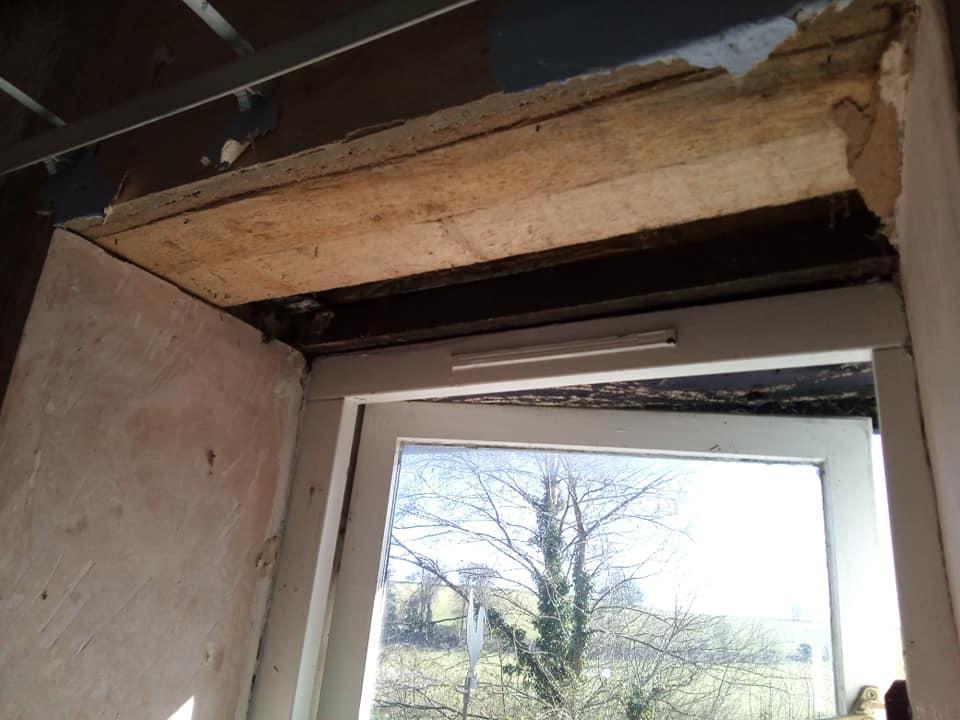

So I'm current renovating out bedroom, we moved in a few months ago. I noticed on one of the window recess top had been nailed hardboard. Well that has to go I thought, I didn't think the would be a big gapping hole behind it! Put my hand up and about ten stones came out about the size of ya hand.
looks like a bit of 8x2 as a lintel - what is that supporting ..??
Woodworm.
I think what you think are wormworm holes is a wood fibre board that's been plastered over. Above is the loft, the window is only about 600mm wide and the walls either side are about 2ft thick stone. Realisticly it's supporting nothing as nothing would fall down. I suspect it's been there for 15 years as is.
What I've now done is water proof the external wall with some flashing roll I had then back filled the whole with the stones and mortar after creating a sort of cage out of wood, then put some more flashing tape accross and screwed some plasterboard over the lot. The inside of that wall and another is being battened, insulated, boarded and skimmed.
Did you notice the window hits the roof board so won't open more than a few inches ?
In fact the floor under that window had almost rotten though from a leaking water tank.
