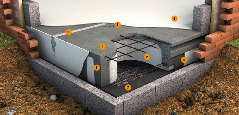

MrP Posted November 22, 2016 Posted November 22, 2016 Hi all, Saw this used for the first time on site today and very impressed. It appears to have addressed some of the thermal bridge detailing commonly associated with beam and block floors and looking through the tech specs it offers some pretty impressive thermal performance along with the practicality of trad foundations and beam and block construction. Also dead quick to install, as the panels come straight off the back of the wagon with a hiab and then it only needs grouting up - i reckon you would have a reasonable sized house done and grouted in half a day. http://www.creaghconcrete.co.uk/spantherm/ho-it-works.html?p=277 Not sure on prices etc. - will be interesting to see if they are competitive.

vfrdave Posted November 23, 2016 Posted November 23, 2016 (edited) I got a price for a house that was previously designed for our site (I have since redesigned):- 196m2 Spantherm375 £8232 For comparison the same area in hollowcore 150mm £5840 Edited November 23, 2016 by vfrdave Premature submission
