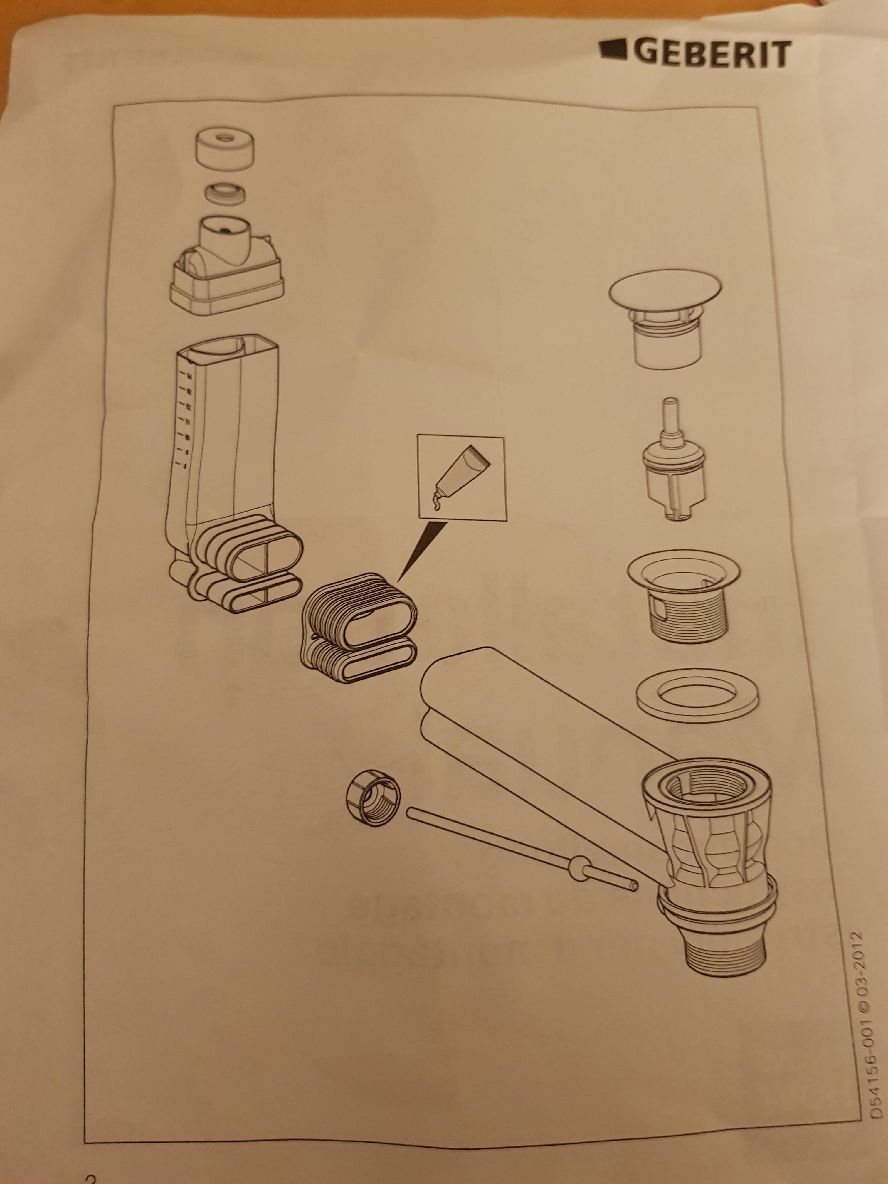

Pete Posted March 17, 2020 Posted March 17, 2020 Has anybody used one of these Geberit combined waste/ overflow system? We have two of these and not sure whether to use them or not. The problem is the sink does not have an overflow unless this system is used but I do not really want a pull up lever on the taps. I think you can get a separate rotating knob but have not managed to source one yet. The only other option is not to use this and just put in a pop up waste and hope nobody leaves the tap running. Any ideas of what people have done would be very much appreciated. TIA
ToughButterCup Posted March 18, 2020 Posted March 18, 2020 What's the Geberit part number Pete (of the overflow that you have) ? I have the same problem ...I'll dig around on reuter.de. Ian
Pete Posted March 18, 2020 Author Posted March 18, 2020 Sorry for late reply Ian. Code is 261.535.00.01, ta 14 hours ago, AnonymousBosch said: What's the Geberit part number Pete (of the overflow that you have) ? I have the same problem ...I'll dig around on reuter.de. Ian
Temp Posted March 19, 2020 Posted March 19, 2020 Perhaps possible to replace the chrome waste with a regular plug on a chain type type and remove all the geberit lever mechanisim? Worth a look if you already have it. Not quite the same but we used wall mounted taps. We couldn't get the basin we wanted without a tap hole so used a waste pull to fill it up.
