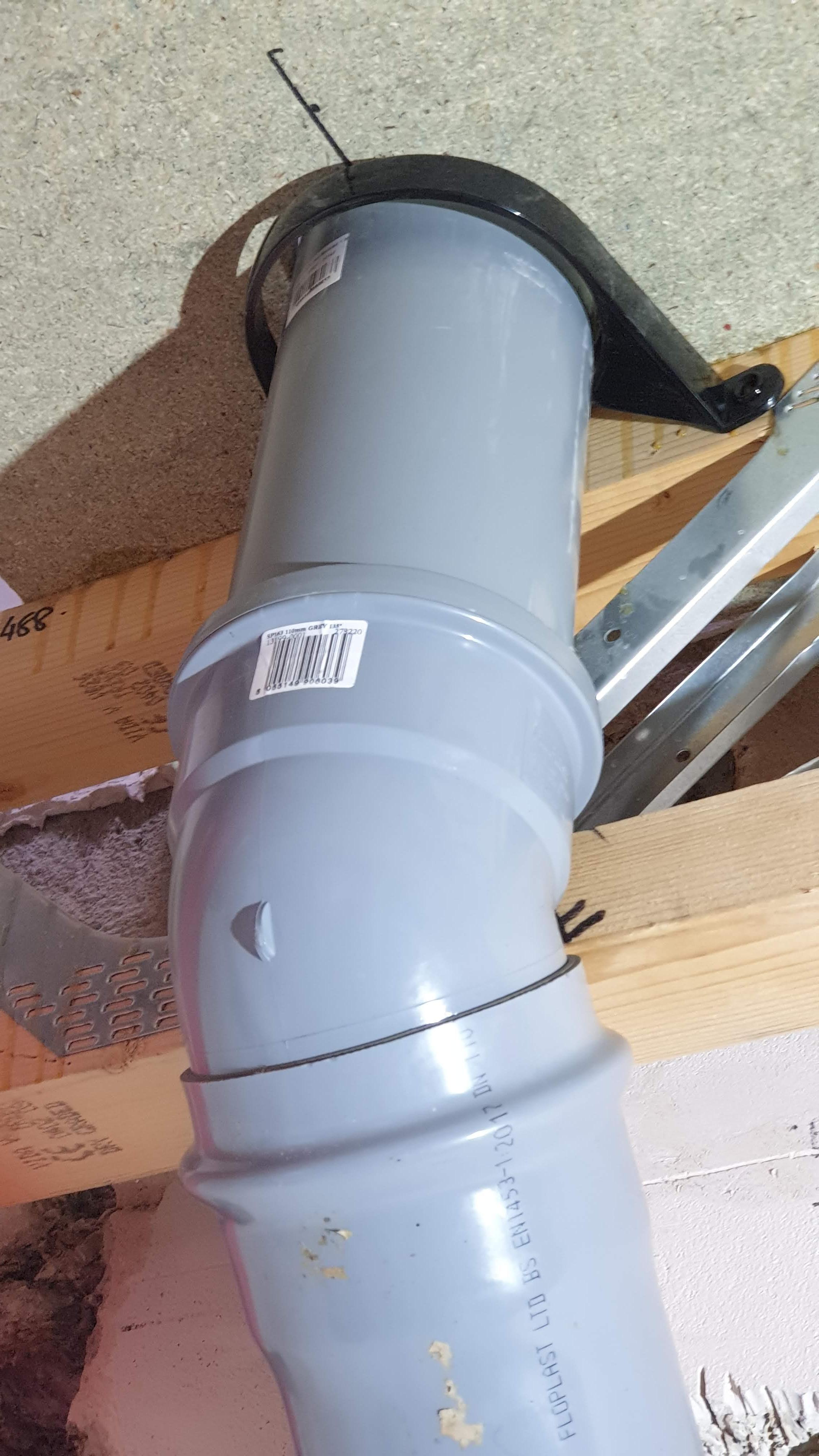

Fixing soil pipe brackets: bit stumped ....
Have a look at this ....
The down-spout (?) is too close to the top chord of the POSI to fix the clip properly. And if there's  one thing that YooChube has taught me, its that the fixings for the soil pipe need to be pucca.
Should I;
  • pack out the gap between the pipe and the clip and fasten,
  • put a noggin between the top chords of the adjacent POSIs and fix the pipe clip to that,
  • enlarge the hole in the ceiling (floor above) and move the pipe 50mm or so such that the clip can be fixed (won't be seen in the bathroom above)
Where's @Onoff when you need him?
Put a noggin between the joist and turn clip sideways from current position to fix to it
Pack between pipe and joist face and/or fitting and joist face and use some builders band screwed to the joist.
Thought of that: there's not enough space between the pipe and the joist to reach the clip hole.....

Twist the clip 180- degrees - then fit noggin
Or
Will the clip fit on the 45 bend?

Off out again to poke around and see.....

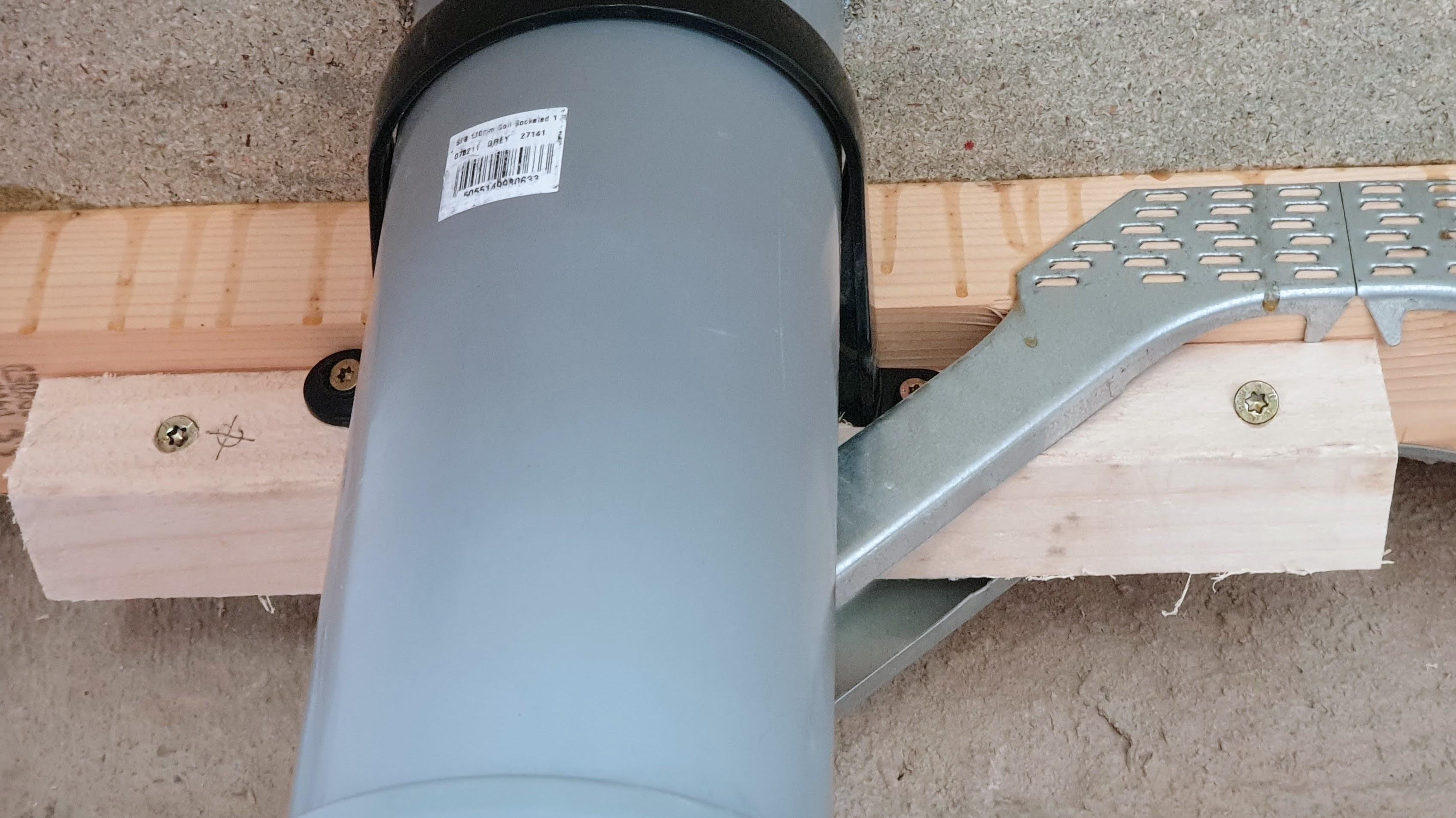

Managed to cut and fit a noggin in between the metal joists and to screw the clip to that.
Really pleased because having bent and crooked hands actually helped! It's an ill wind and all that ...
Just because I can, I'll fit some builders band tomorrow when it arrives. ?
