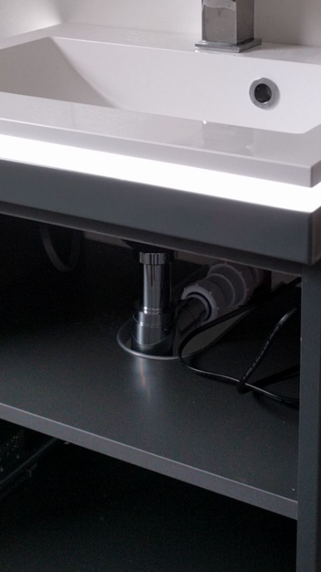

Shortly fitting the en-suite. It will have a counter top Basin.  Underneath will be open shelving, so I will use a chrome waste and trap.  This trap in all probability https://www.toolstation.com/bottle-trap-in-chrome-plated-brass/p85046
Here is a pretty picture of the trap
The chrome pipe will pass through the back wall into a service void where it will join to solvent weld waste pipe to the drain stack.
HOW do I join the chrome pipe to the solvent weld pipe? Preferably with an elbow fitting  Is is as simple as an elbow compression fitting?

Q1, yes, just a simple 32mm compression fitting. Do NOT lube up the compression side that goes onto the chrome tail. That needs to be dry fit to get the rubber to ‘grab’ the chrome surface.
Q2, dunno. ? Suck it and see, but the trap should just screw straight on.
Q2, yes, the trap screws in to the waste. The trap will be telescopic so you can get the fall right then tighten the compression ring on the bottle. Don't lube as trap will just fall down over time.
Btw, you need to make sure the overflow slot on the waste lines up with the slot in your sink. Took me three attempts to get one deep enough to match the slot in my sink. I would have thought it would be standard dimension but obviously not.
This is how ours ended up. Chrome pipe in to compression coupler, can't remember the rest!
