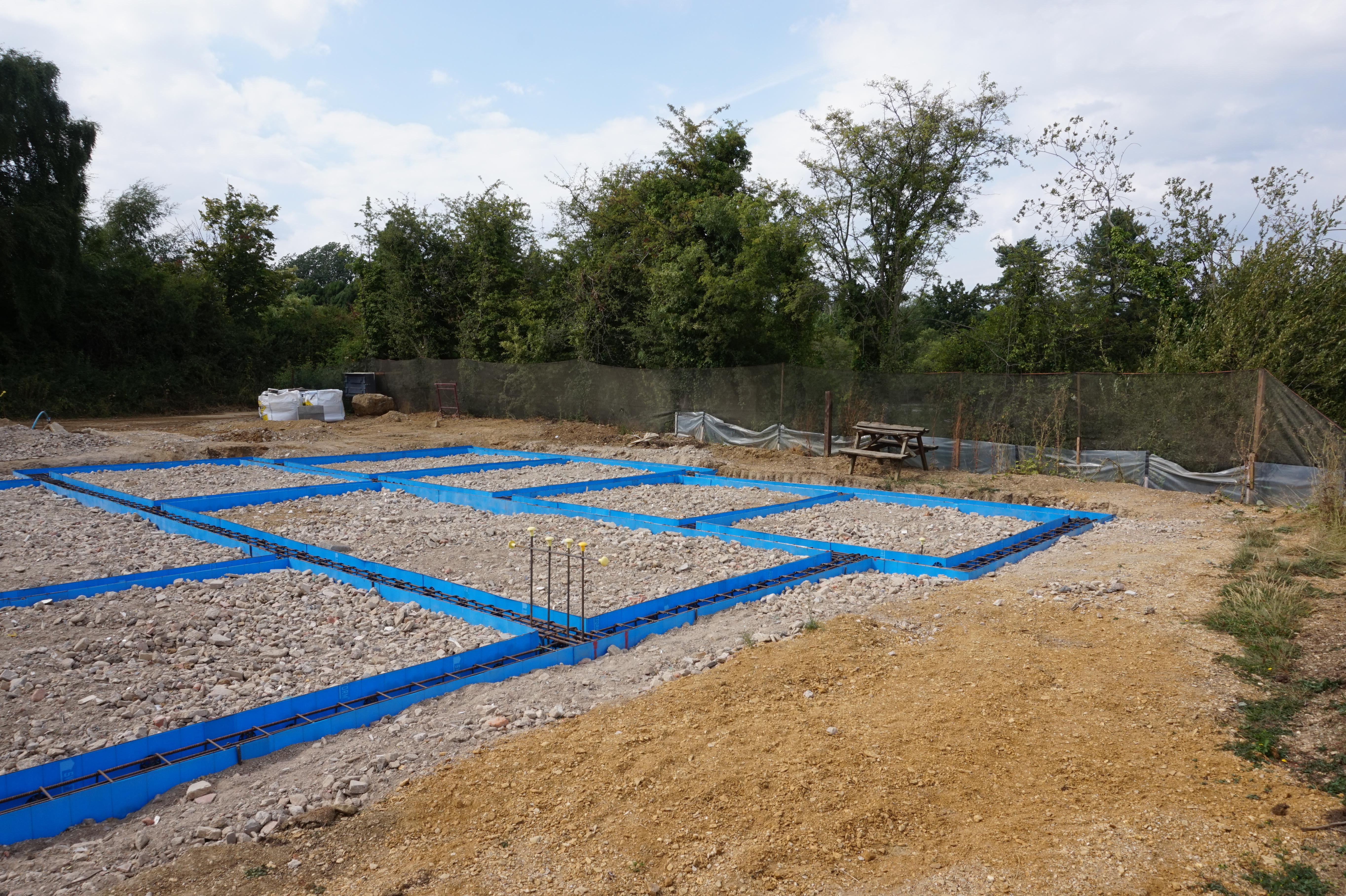

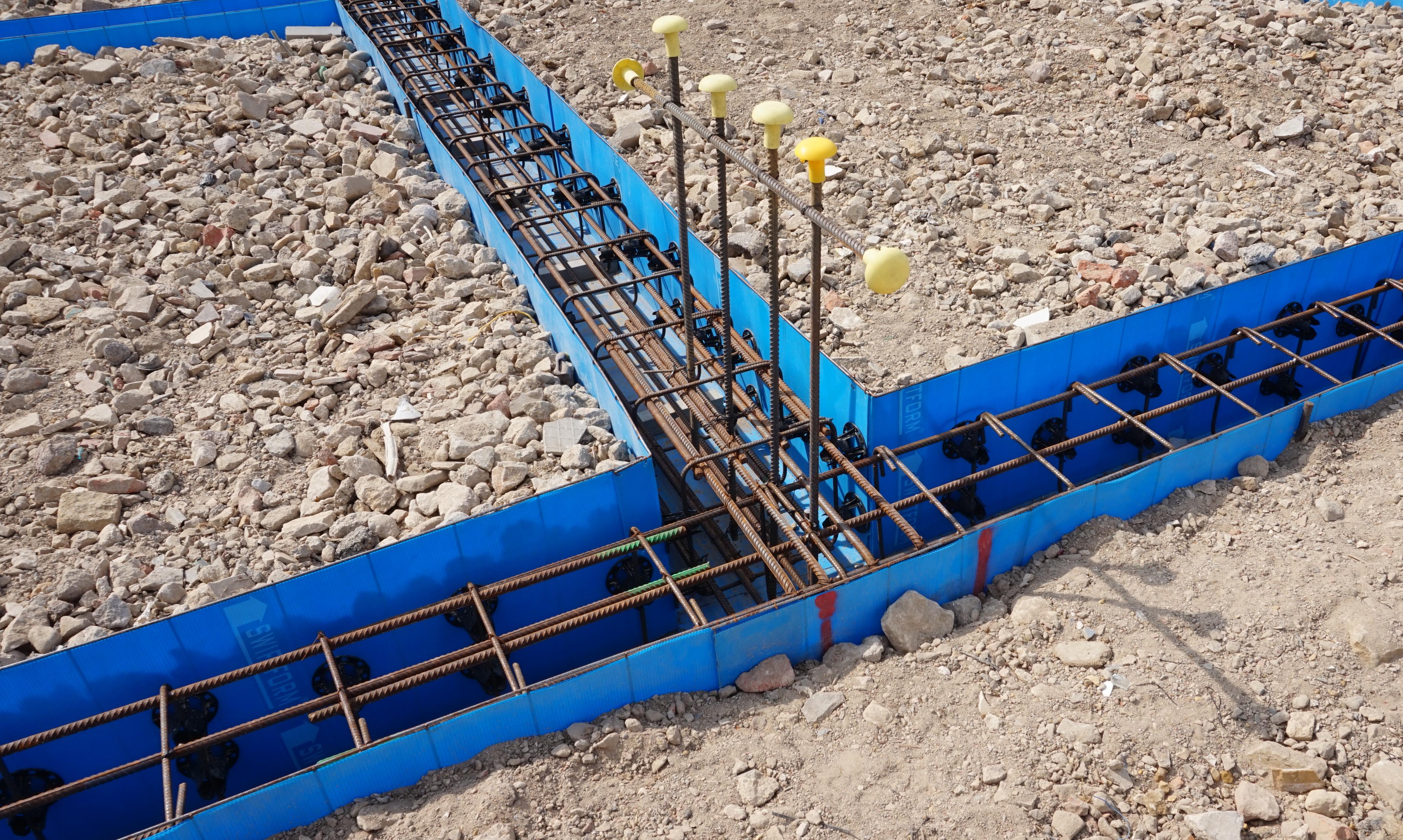

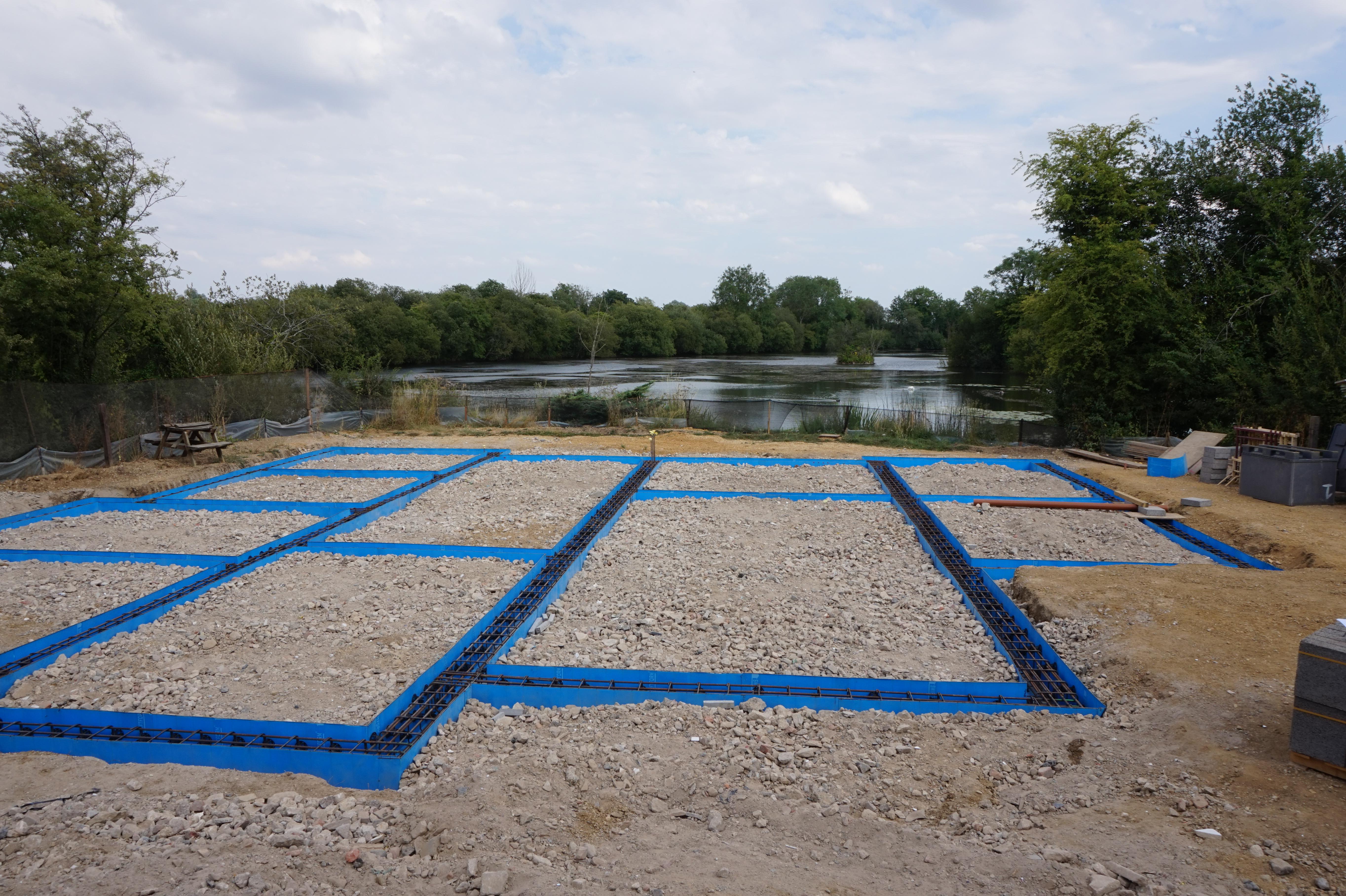

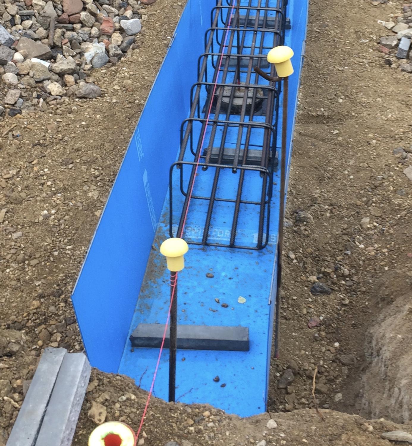

Russell griffiths Posted February 26, 2020 Posted February 26, 2020 i used this stuff @eandg SWIFTFORM its a bit more ore complicated than just having to pour some concrete. Theres a fair bit of jiggery pokery to get it all square and joined together at the corners, then you need to put the steel in and tie it all together. Then it looks like this ready for concrete.
