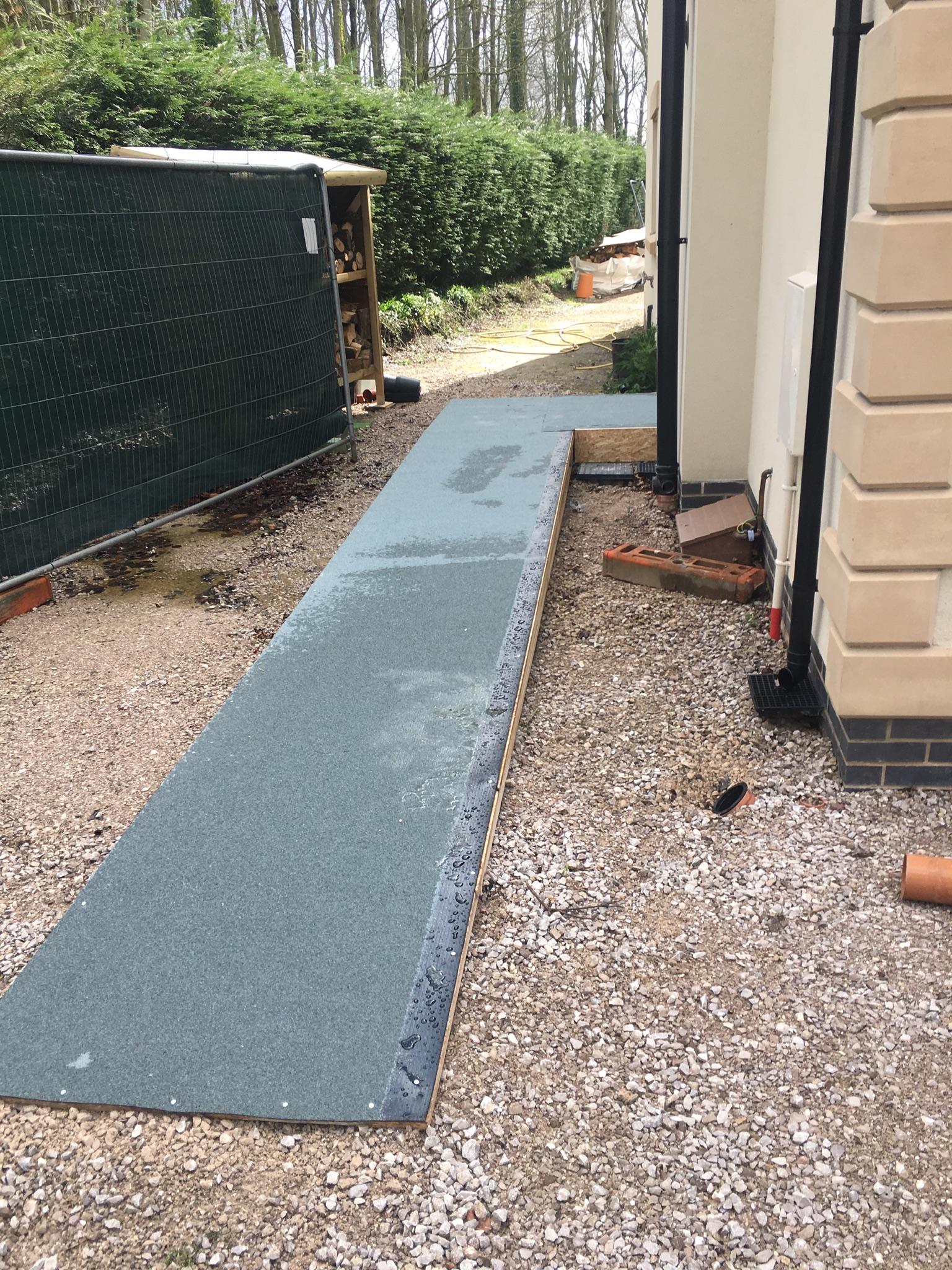

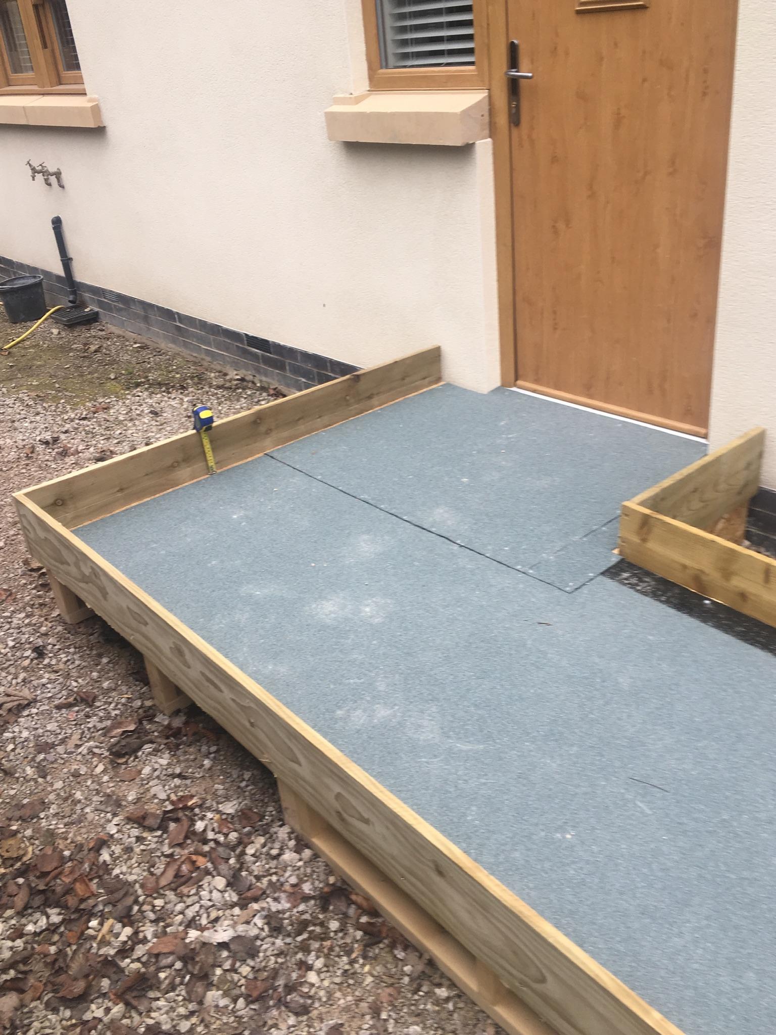

nod Posted February 23, 2020 Share Posted February 23, 2020 We moved in with a Electric and gas cert No landscaping to the outside Temporary disabled ramp Local authority BC where happy to sign us off Cill Three years from that day 1 Link to comment Share on other sites More sharing options...
