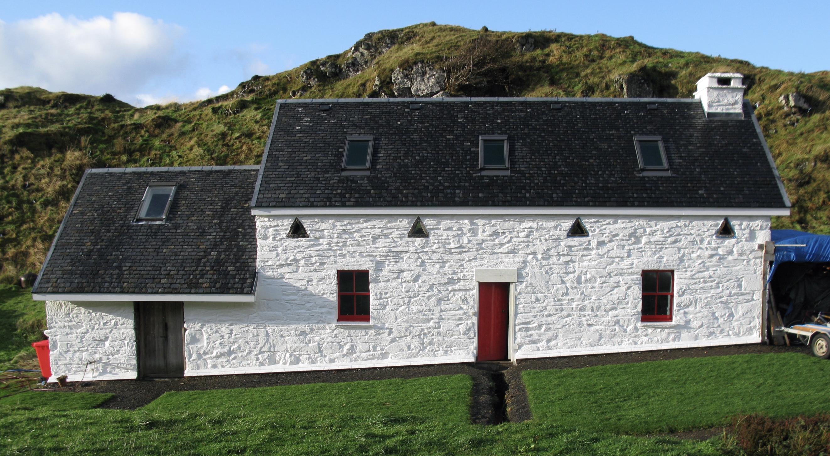

Good stuff, as always starting from scratch looks so much easier, quicker, cheeper, etc etc ....... I see the supervisor is a chicken so none of the usual monkeys on site.
‘what part of the world are you in ?  I am trying desperately to get back to my cottage renovations so that I can get it rented out........  but family, life and everything unexpected are hindering my good intentions....... keep the photos coming!

Thanks CPD. Your cottage looks lovely.
