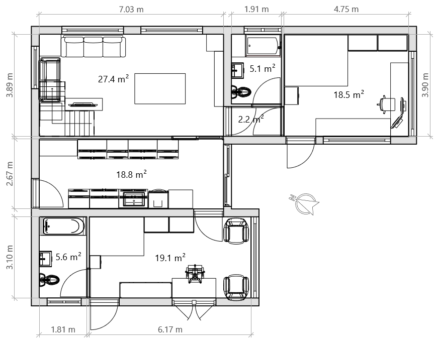

Falesh Posted February 10, 2020 Posted February 10, 2020 I am having trouble deciding between SIPs and ICF for the walls of our planned house. The image below shows a possible layout, but please note that this is a work in progress and more an indication of our needs rather then a finalized plan. This house will be built in York in case my region has an impact. The main considerations are as follows: Sound Proofing The two bedrooms need to be very well soundproofed. The bedroom at the top right is going to be mine and I sleep till midday or later due to my disability. That means I need a very quiet room both from external and internal noise. My father will be having the other bedroom and would also like to have reasonable internal soundproofing so we can have our own guests and not disturb each other too much. Durability Because I am unable to work and my father is retired we need to make sure this house will last without needing costly repairs down the line. This is where my concern for SIPs comes in due to the possiblity of panel degredation. My other concern with regards to this is that SIPs seem reletivly new and I worry that local builders may not have the skills to build with SIPs in a way that promotes longevity. Cost Obviously cost is a big factor too. We will be selling our current house before we start the build so how quickly the house can be built once the money becomes availible will have an impact due to less time we need to rent. Any extra soundproofing that one system needs will have to be added to its cost. Any advice would be greatly appreciated!
scottishjohn Posted February 10, 2020 Posted February 10, 2020 (edited) If sound is important then ICF with concrete would seem better than sips --but ask suppliers for values and maybe triple glazed asit looks like you have quite large window area in that bedroom? are you self build or turn key --? as you mention speed of build as being a factor - the biggest thing that will hold the job up is YOU not getting spec correct to start with and asking for things to be changed again your chosen suppler /builder should be able to give accurate times sending plans to a couple of sips and ICF companies should give you prices and time scales if you are going to leave building to them Edited February 10, 2020 by scottishjohn

PeterW Posted February 11, 2020 Posted February 11, 2020 Firstly I’m not sure about that layout as it’s not easy to see where the main entrance is, and having bedrooms off kitchens isn’t ideal. It is also a large galley kitchen for what is a very small house - do you have planning permission yet ..? Adding some sort of circulation space may reduce your costs here if you make it squarer than it is now. For sound, it depends where you are and the sound levels. Timber frame with pumped cellulose is very good at stopping sound from external sources, coupled with decent triple or acoustic glazing and you will have warmth and sound reduction. Internally you can “airlock” pairs of doors so you don’t get sound travelling through a single door, but that all relies on the doors being closed !! Having them at 90 degrees to each other also helps, as does a soft panel / material to absorb sound in a corridor.
