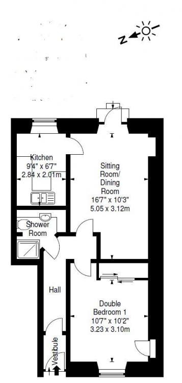

Zurg Posted February 7, 2020 Share Posted February 7, 2020 (edited) Hi ASHP - £6396 exl VAT UFH - £2969 exl VAT I'm renovating a 45sqm, 1 bed ground floor, Victorian mid-terrace, off-gas. I am hoping to replace old storage heaters and installing UFH throughout the property with an ASHP. Heat loss calc - I only have the supplier's calculation as below - it's a old building so not sure on wall U-values - stone walls approx 0.4m thick for the external - might be similar for the party walls but not 100% sure! Heating SCoP: 3.18 Based on regional weather data in line with MIS 3005 Hot water SCoP: 2.88 Total building heat requirement: 11617.0 kWh based on: 45 m² Heat output by heat pump: 14183.0 kWh for heating and hot water Electricity required to power heat pump: 4907.0 kWh Backup electricity: 71 kWh Free energy from Heat Pump: 9276.0 kWh Hot water cylinder re-heat time: 123 314 minutes (typical) minutes (max) Heat Pump MCS Certificate No. MCS HP0003/48 Living in Scotland so hoping to qualify for HES Loan to cover install, RHI payments ~£4,500 based on government calculator. Currently have suspended timber floor so installing UFH between joists. I received this quote from NuHeat but without them visiting the property. I have had 2 visits from different installers who are due to send their quote next week, but I was wondering if anyone wouldn't mind casting their eye over this quote and if - I feel it's more expensive than it should be, considering it is not including install - but perhaps I am deluding myself ? Let me know if any other info is helpful, too. Thanks! ASHP - £6396 exl VAT 1 NIBE F2040-6 (typically capable of heating a property with 4.5kW heat loss at design operating conditions, in compliance with MCS standards) air source heat pump kit, charge pump, and associated fittings. 1 Docking assembly for air source heat pump with Nu-Heat hot water cylinder, buffer tank and supplementary electric heating 1 EnergyPro® 200 litre unvented stainless steel HP cylinder for use with NIBE ASHP, including fittings and G3 kit. (Please note that the cylinder warranty does not cover private water supplies, e.g. boreholes. Please speak to your Account Manager if this required.) 1 100 litre (stackable type C) buffer tank assembly with four tappings and one immersion tapping, with immersion heater 1 Electric metering kit for one single phase heat pump and two additional immersion heaters 1 Includes delivery of heat pump and tank by carrier to UK mainland only 1 On-site support package, as detailed in your Quote Summary UFH - £2969 exl VAT 1 Wilo Para SC7 pump (EuP compliant) with valves 1 Isolator pack for Optiflo manifolds 1 System expansion vessel 1 6-port Optiflo manifold module with zone valves, flow meters, isolating valves, temperature gauges, pressure gauge and wiring centre - view details 4 Dial thermostat - view details 1 Dial thermostat and remote sensor for wet rooms 390 Metres of 14mm Fastflo® heating tube with oxygen diffusion barrier - view details 12 14mm x 2mm Eurofitting nut, tail & olive and pipe bend support 43 m² DPJK14 floor components - 25mm tracked polystyrene panels with heat transfer plates and pipe staples. For use with Knauf BrioDec (by others) 1 Commissioning accessories pack 1 Design specification, manuals and documentation - view details 1 Delivery to UK mainland only following receipt of full payment and acceptance of CAD drawings. Edited February 7, 2020 by Zurg Link to comment Share on other sites More sharing options...

Ferdinand Posted February 8, 2020 Share Posted February 8, 2020 (edited) I agree this is tight, but otoh you only need insulation on one or two walls in each room, so something like Insulated Plasterboard with 50 or 60mm of Celotex incorporated will only cost about 3 inches in one dimension - the long dimension ? - and give you virtually modern standards. I think the plan is the right way round - lounge sun in the evenings, bedroom in the mornings. I think that knocking through kitchen to lounge would be a very beneficial and perhaps not very expensive (probably) thing to do. I think a possible big advantage you have is being the northern half of the semi, which will reduce potential temperature swings summer to winter - especially during short intense heatwaves. A downside is that you may be a little starved of sun, so I would think about a seating area outside in a sunny corner of the yard if you have one. In my experience people prefer the Northern half. Remember ventilation as well as insulation. Best of luck. Ferdinand Edited February 8, 2020 by Ferdinand Link to comment Share on other sites More sharing options...
Zurg Posted February 10, 2020 Author Share Posted February 10, 2020 (edited) Thank you for your replies, really appreciate all your advice. We will look further at wall insulation. The floor will be insulated with Kingspan at 100mm between the joists, the UFH pipework and screed. We've not moved into the property - just spending our evenings/weekends there - so don't know about the current heating system demand for the home. Is the quote roughly what you'd expect a heat pump and UFH to cost, then? If ASHP works out too expensive to install, we will upgrade the storage heaters instead. Yes - purchased the flat exactly for its outdoor space - sunny mornings in the private (for a city, anyway) back of the property and there's a garden in the front for the evening sun, too. And yes - understood more insulation would decrease potential income but not the running costs! We still have the EPC from the purchase that will last us for application. Thanks, everyone. Edited February 10, 2020 by Zurg Link to comment Share on other sites More sharing options...
