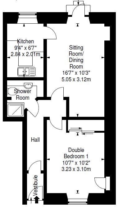

  6. Hi @newhome Thanks for your reply. Sure, I don't think I have any questions yet but any suggestions very welcome. I've not moved in yet so a number of things I'm not sure of until I can get in and measure and get a better look at the structure. I attach the original floorplan, and can update with some redrawings as we make them. Thanks!
  7. Hi I've recently purchased a 1bed "colony" house in Edinburgh. For those unfamiliar with colony houses, these were homes built throughout Victorian Edinburgh and were designed as homes for the skilled working class, more details about them here if you are interested. Mine is a 1 bed ground floor, 45sqm altogether, with a small front and back garden. It's currently fitted with electric storage heating that I am hoping to remove and replace with a small air source heat pump and install underfloor heating throughout. I found this forum through my ASHP researching and have found it really useful so far. I also want to change the internal layout, so the largest rooms are for the kitchen and living room. I wish to move the bathroom to the opposite side of the house and turn the current kitchen (small, narrow) to a very small double bedroom! This requires a couple of walls knocking down and rebuilt. I won't have the keys to the property until late November so works can't start yet but I'm trying to do as much research before then. Thanks all, looking forward to asking lots of questions as I have them...!
