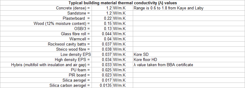

Jeremy Harris Posted February 9, 2020 Share Posted February 9, 2020 Depends very much on the moisture content, I believe. I used a value of 0.15 W/m.K for dry wood when I was looking at heat loss, a value that I got from here: https://www.engineeringtoolbox.com/thermal-conductivity-d_429.html I think (that gives a value of 0.147 W/m.K for dry wood across the grain). I collected together some lambda values for building materials in this list, that may help: Link to comment Share on other sites More sharing options...

Ian Posted February 9, 2020 Share Posted February 9, 2020 @Alslo be careful you don’t mix up K-Values, R-values and U-values when doing your calculations. If the K-value of timber is 0.15 and you have a 380mm thickness as in your 15” thick timber logs then the R-value will be 2.54 m²·K/W and the U-value will be 0.39 W/m²K Link to comment Share on other sites More sharing options...
