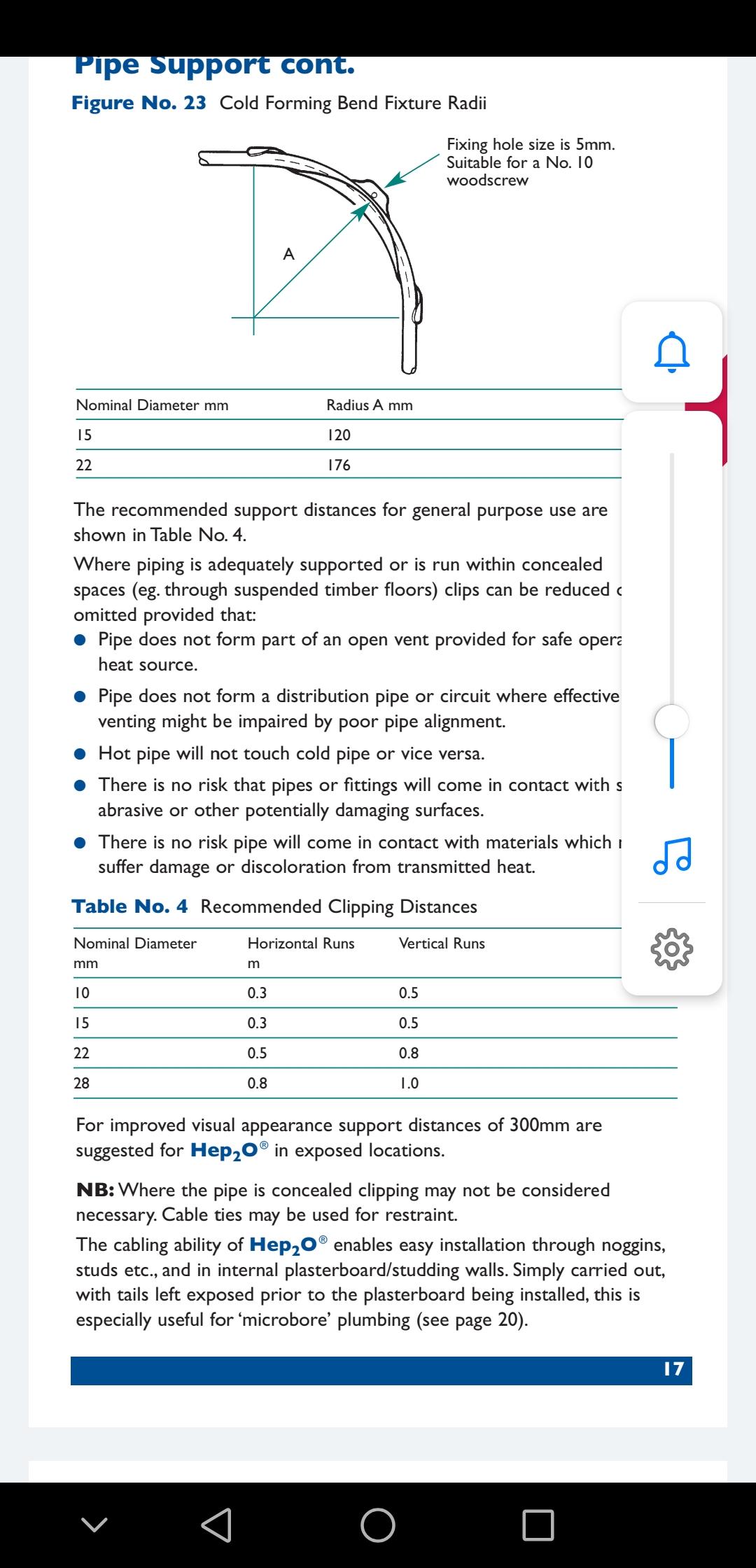

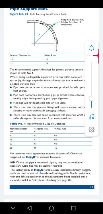

ToughButterCup Posted January 30, 2020 Posted January 30, 2020 Laying HEP Pipe between POSI joists today. Both 22 and 15. How frequently should the pipe be clipped to the joists please? Every meter or so? Thanks Ian.
Construction Channel Posted January 30, 2020 Posted January 30, 2020 https://www.google.com/url?sa=t&source=web&rct=j&url=https://www.jhplumb.com/system/brand_attachments/1035/original/Hep2O%C2%AE_installer_guide.pdf&ved=2ahUKEwjhla_0qqvnAhX4SBUIHfHaD0sQFjAAegQIAhAB&usg=AOvVaw1oaVJlic8d6Hy4kts1kWfI It says every 300mm but I went every 800mm after discussing it with my plumber. 1
ToughButterCup Posted January 30, 2020 Author Posted January 30, 2020 So that's every other POSI... 400 centres Ta Ed!
