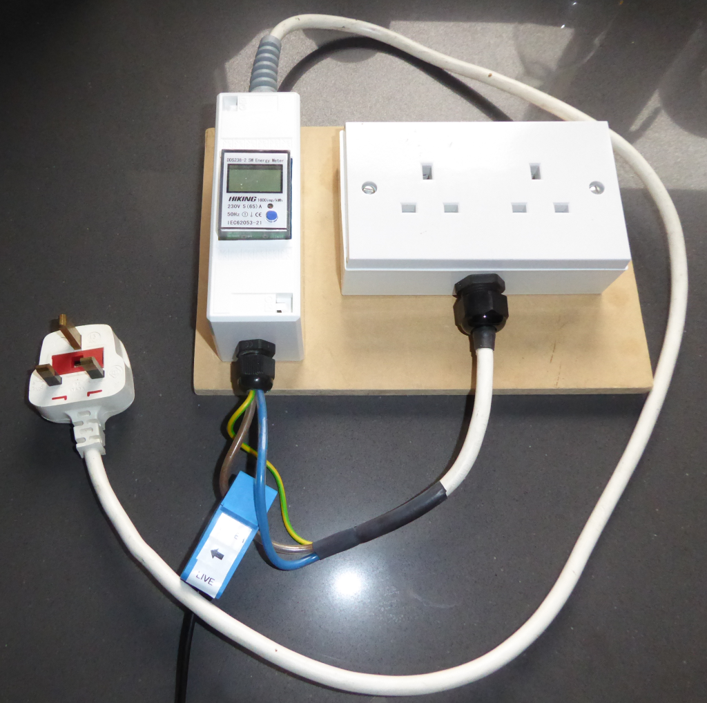

Jeremy Harris Posted January 30, 2020 Posted January 30, 2020 The only way to accurately know the electrical input is to measure it. As the power factor (PF) may well not be unity for a heat pump, measuring just voltage and current independently may not give an accurate indication of input power. Fitting an simple energy meter, one that has a power display as well as energy, to the supply to the heat pump will give an accurate measure of input power. Small, DIN rail mount energy meters like this are fairly cheap and seem to work well. I have one fitted in a small enclosure on a test lead that I made up: I have a similar one connected in the supply to our air source heat pump, and find it pretty useful. It not only gives the energy (in kWh) that the heat pump uses, but also displays voltage, current, power factor and instantaneous power. I think the one above cost about £15 or so. 1
Anton Posted January 30, 2020 Author Posted January 30, 2020 Thank you all for the information. I understand that I would need the power factor to obtain electric consumption of the heat pump on a daily basis. Thank you for Jeremy for that idea. I was just wondering if I can do anything with the heat compressor frequency to understand its electric consumption without any access to the other data mentioned like the power factor.
