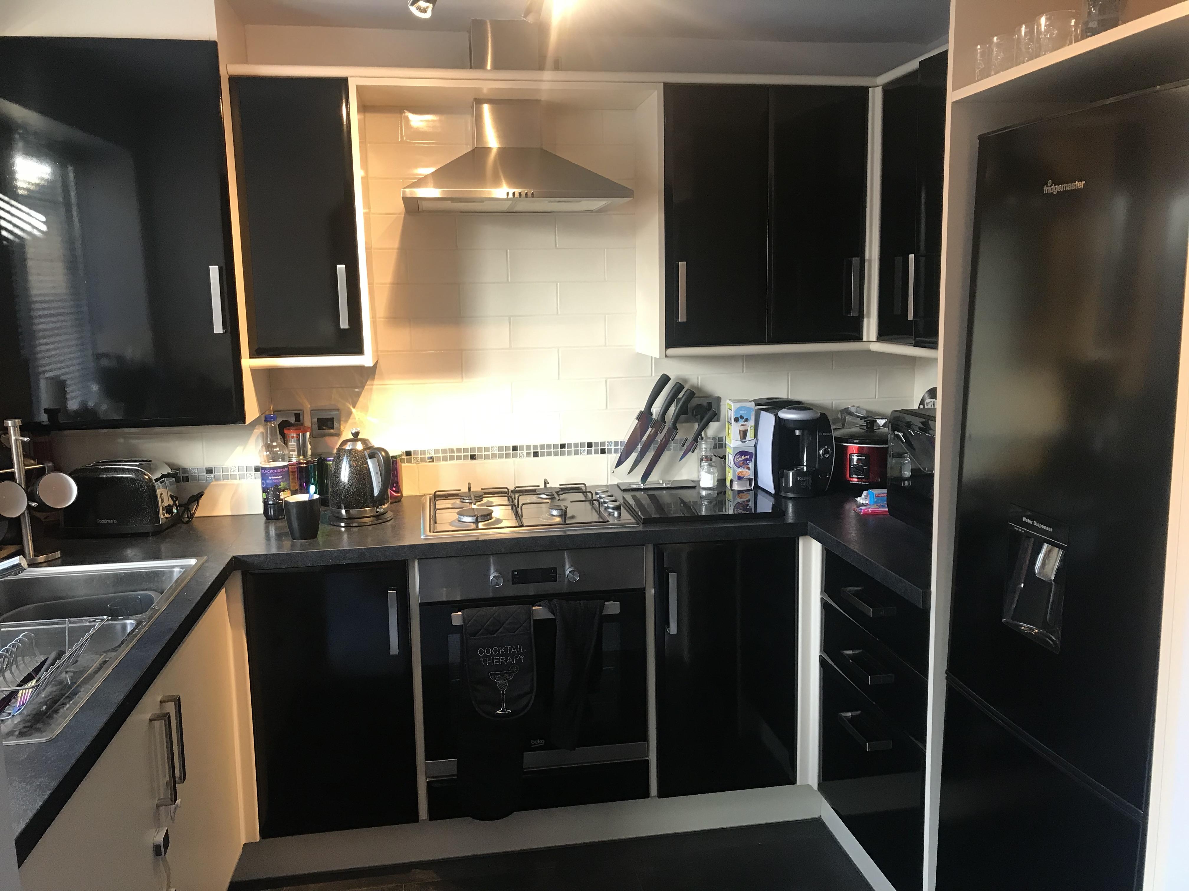

SiBee Posted January 28, 2020 Posted January 28, 2020 Any one used this stuff? looking to freshen up a kitchen which has beech effect melamine fronts. The usual diy sheds stock liberon v33 cabinet paint and it gets decent reviews. I bought a trial pot and did a quick test (paint brush only) on a well prepped surface and it didn’t cover very well with two coats. Anyone used similar and can recommend. Looking for a dark grey/ anthracite colour.
Onoff Posted January 28, 2020 Posted January 28, 2020 I wonder if Bedec Multi Surface Paint would be good for this? https://bedec.co.uk/bedec_products/multi-surface-paint/ I've only ever used their Bedec Barn Paint and it honestly covers like nothing else I've ever used. 1 coat of satin black and new scaffold boards were.....well black! Did 3 coats in all. You might phone them and ask. Who knows, you might get a sample pot!
bassanclan Posted January 28, 2020 Posted January 28, 2020 It's really not worth doing on melamine fronts. Just don't bother. You can do it on solid wood and at a push veneer, but it's not worth if otherwise, you'll never get a good finish.
bassanclan Posted January 28, 2020 Posted January 28, 2020 Brushes are not yoyr friend for painting cabibets you need to sand the surface, then prime with a dense mini roller, then denib, then 2 coats of topcoat with a denib in between if needed. Only using brushes on mouldings. Even better is a spray finish. For wood cupboards durable oil based eggshell is my go to product. I like Johnsons, but Leyland Trade is nearly as good. Acrylic based is ok, but not for heavy useage areas like kitchens.
nod Posted January 28, 2020 Posted January 28, 2020 Our son raped he’s Even the fridge Took him two evenings
SiBee Posted January 29, 2020 Author Posted January 29, 2020 Thanks for the replies. Sanding has started so continue I must?changed from the original colour choice of anthracite to white though which we think might appeal to more people. Besides that, most of the house is a shade of grey. With proper prep, correct ambient temperatures maintained and quality rollers and cutting in brushes with doors and drawers laid flat I will be giving myself a fighting chance of finishing to an acceptable standard. Decided on the liberon v33 in white after using a few samples from our trade outlets.
