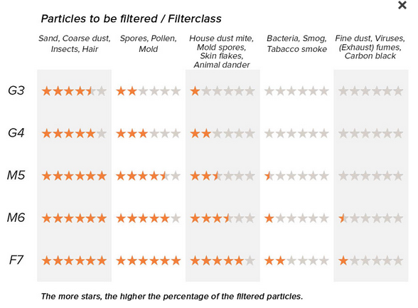

So, first newbie question, how important is the filter type supplied with MVHR units? Most I've seen are G3 or G4, some with F7 optional. From googling, G4 is a finer filter, but is likely to be more restrictive than G3.
But in practical terms which is better, or does it make little difference?
G4 is the standard dust filter. F7 is the upgrade option and a much finer filter, and so captures more fine particles such as pollen.

We just bought a new supply of filters for our Vent Axia. They were G4 rather than G3 ones. I found this during my searches:

Do the higher grades of filter cause significantly more resistance to the airflow?
Broadly the numbers for 20mm filter I’ve seen are a pressure drop of 40/80/120Pa for G3/M5/F7 respectively

There was little difference between the G3 and G4 ones we bought - the G4 were slightly thicker and felt more substantial. Doen't seem to have impacted on the flow rate
