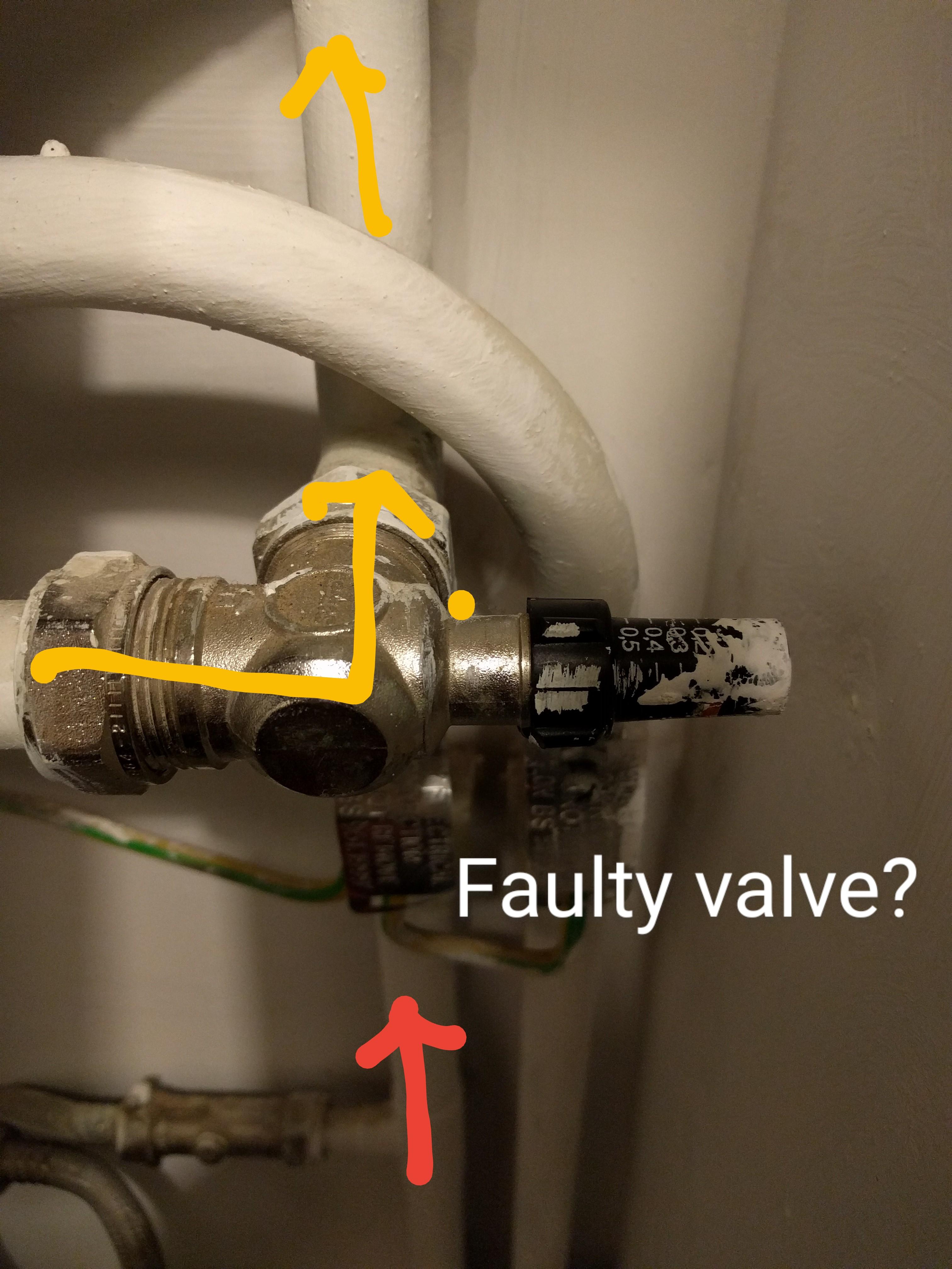

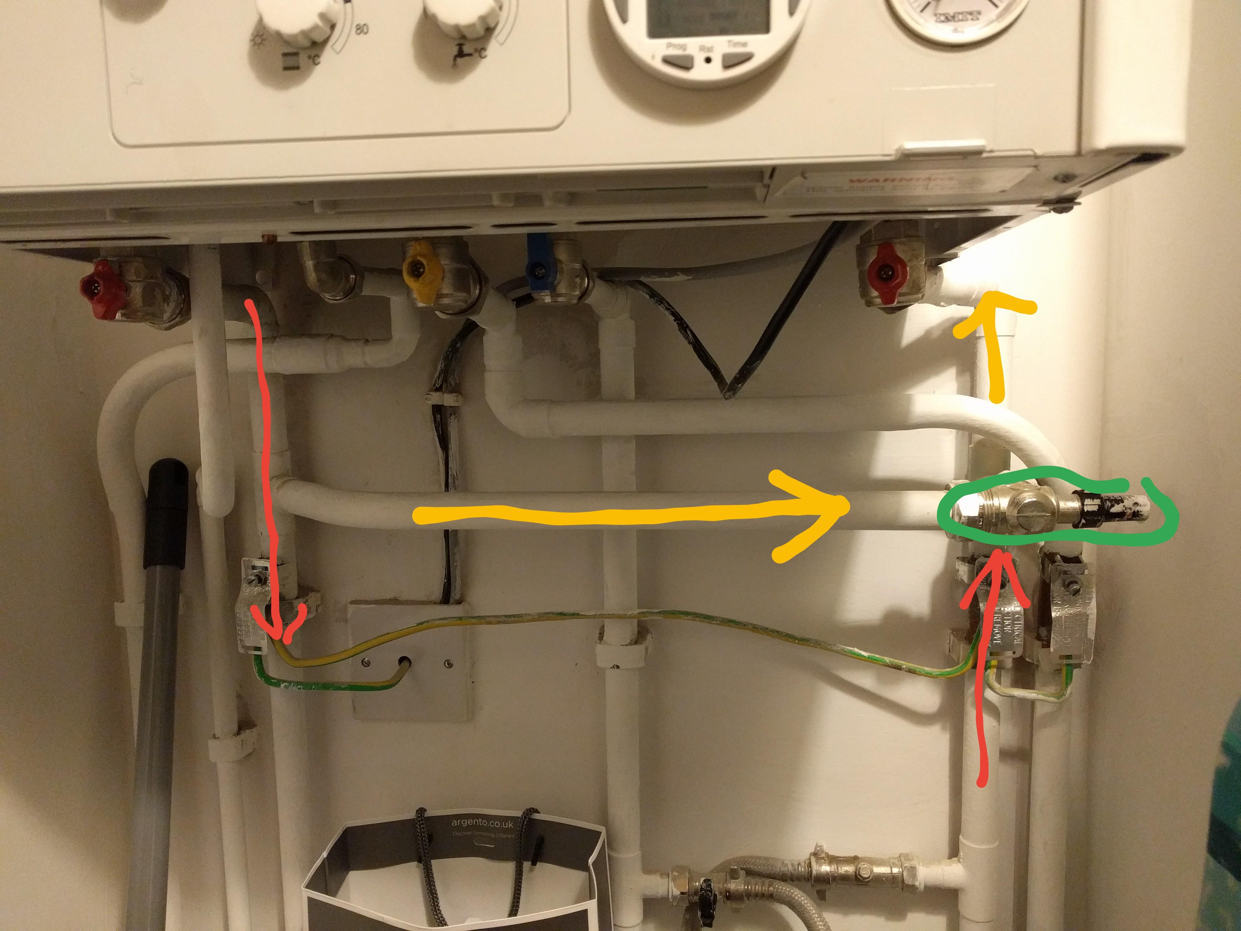

Conor Posted January 17, 2020 Posted January 17, 2020 (edited) We've just moved in to our rental accom and the combi boiler has been dodgy since day one. Tripping out after just a couple hours of running. Last night, it failed to heat the rads at all. From what I can see, the boiler is heating the CH water as normal, but instead of circulating around the system (red arrows below), it's flowing through a bypass (yellow arrow) and causing the boiler to shut off after just a few seconds. I'm guessing this valve (green) is at fault? Is there anything I can do easily (like adjust it?). Valve ranges from 0.5 to 0.1, I'm guessing it's some sort of prv? Or am I going to have to ring the land lady?, Edit: from a quick search it seems to be a faulty automatic bypass valve. I tried it fully out (0.1) and fully in (0.5) and doesn't make a difference.... Oh, and it drops water now... Edited January 17, 2020 by Conor
ProDave Posted January 17, 2020 Posted January 17, 2020 The automatic bypass will pass water when the normal water flow route is shut. IF for example all radiators have thermostatic valves, and all rooms are up to temperature, then water will not flow through the radiators and the bypass is doing it's job. Go and ensure at least one radiator has it's TRV turned up to maximum and try again. 1

Conor Posted January 19, 2020 Author Posted January 19, 2020 All sorted. Was, as I suspected, a failed bypass valve. Plumber just cut and capped the bypass pipe as there is a rad in the hallway with no TRV that will act as the bypass. 2
