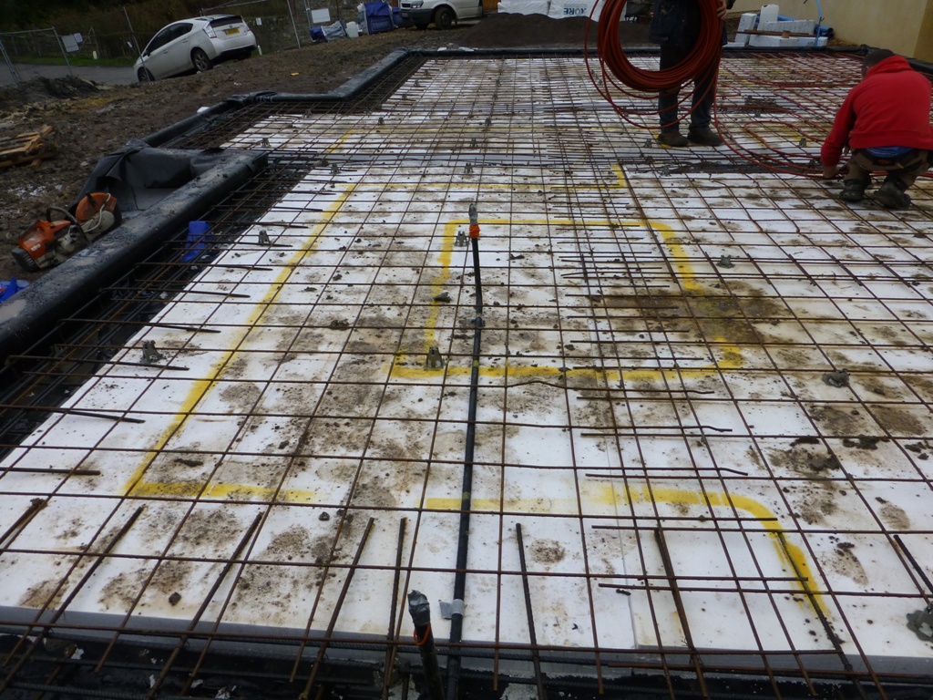

Dreadnaught Posted January 16, 2020 Posted January 16, 2020 Basic question if I may. Anyone with an MBC-style raft will be able to answer in a flash I expect. With an insulated reinforced concrete raft foundation (200mm concrete over EPS), how does a conduit run to a kitchen island (or, for example, to floor sockets in the sitting area) for electrical cabling? Possible answer 1: does the conduit penetrate all the way through the raft and the EPS into the soil beneath, like a service penetration, and then re-emerge elsewhere in the build next to a wall? Possible answer 2: does the conduit penetrate laterally throughs the raft spanning from a wall to the island without penetrating the EPS?
Jeremy Harris Posted January 16, 2020 Posted January 16, 2020 I just ran 25mm electrical conduit through the slab like this, with gentle bends on either end to make it easier to pull the cables through: Before the pour, the conduit was cable tied to the steel mesh to hold it in position. 1

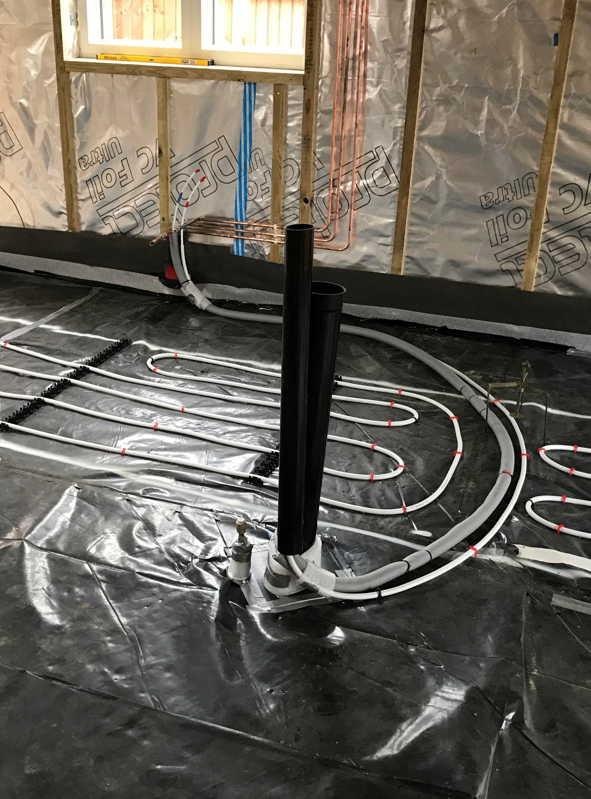

RandAbuild Posted January 16, 2020 Posted January 16, 2020 Don't forget about drainage & water if you're thinking about having a sink on the island too 1

Dreadnaught Posted January 16, 2020 Author Posted January 16, 2020 (edited) 20 minutes ago, RandAbuild said: Here's ours Oh, is that image in preparation for the pour of a screed? Edited January 16, 2020 by Dreadnaught
Dreadnaught Posted January 16, 2020 Author Posted January 16, 2020 32 minutes ago, Jeremy Harris said: I just ran 25mm electrical conduit through the slab like this, with gentle bends on either end to make it easier to pull the cables through: Thanks @Jeremy Harris. The other end seems to come up in your double-stud wall. Am I right? Why was that?
Jeremy Harris Posted January 16, 2020 Posted January 16, 2020 4 minutes ago, Dreadnaught said: Thanks @Jeremy Harris. The other end seems to come up in your double-stud wall. Am I right? Why was that? The wall end of the conduit comes up inside the service void, just inside the twin stud wall, and the cables then run vertically up to the isolator switches on the wall above. 1
RandAbuild Posted January 16, 2020 Posted January 16, 2020 (edited) 8 minutes ago, Dreadnaught said: Oh, is that image in preparation for the pour of a screed? Yes, that's before the final screed. We did not have an MBC insulated slab though. Ours was a 'Jetfloor ' - insulated blocks between concrete beams, overlaid with EPS. The drainage was laid below the Jetfloor (as in a traditional block and beam), but the services were in the screed (including supply for our induction hob). If you have a sink in your island, I presume your drainage would be the same as foul drains below the MBC slab? [You can see we also added a gas supply in case we didn't like the induction hob (we do!)] Edited January 16, 2020 by RandAbuild Additional text added 1
PeterW Posted January 16, 2020 Posted January 16, 2020 I use 32mm solvent weld pipe and a pair of 45 degree bends on each end. Makes it easier to thread 10mm cable through as it can be very stiff. Bring it a fair bit higher than the slab and then just cap it off both ends so it doesn’t get filled with water or concrete. 1
