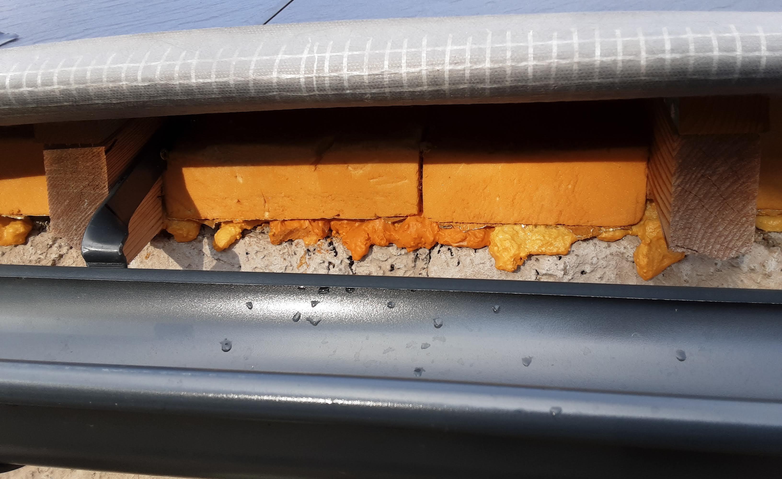

Simplysimon Posted January 12, 2020 Posted January 12, 2020 hi folks, does anyone have a detail for an eaves details for counter and tile batten but without a fascia? i'm trying to get this into my head and am swithering between leaving it open with insect mesh for ventilation, however, worried about the slates lifting and closing it off but can't figure how to finish cutting around the gutter brackets. i'm looking at putting the slates on battens as opposed to nailing through the roof covering as it's not sarking (medite vent) and it doesn't take a nail well. cheers
ToughButterCup Posted January 12, 2020 Posted January 12, 2020 This is what I'm doing.... With the agreement of the architect, trim off the foam, measure and fit board (tanalised) between each rafter, screw into each rafter. Tea.Medals.
Simplysimon Posted January 12, 2020 Author Posted January 12, 2020 On 12/01/2020 at 12:34, AnonymousBosch said: This is what I'm doing.... With the agreement of the architect, trim off the foam, measure and fit board (tanalised) between each rafter, screw into each rafter. Tea.Medals. Expand cheers, unfortunately it's the bit above the roofing membrane i'm looking at, when battened and counter battened there is a void which the wind will get under, great for ventilation, however, not so good for keeping slates in place.
Temp Posted January 13, 2020 Posted January 13, 2020 In the case of tiles... The bottom edge of one row of tiles normally rests on top of the row below, but obviously at the bottom there is no tile to rest on so they usually rest on the top of the fascia. If there is no fascia a triangular batten is used to maintain the pitch. Note the membrane goes over the top of the triangular batten and into the gutter. So in the case of counter battens the counter battens would need to stop above the triangular batten. 1

Simplysimon Posted January 13, 2020 Author Posted January 13, 2020 On 13/01/2020 at 03:46, Temp said: In the case of tiles... The bottom edge of one row of tiles normally rests on top of the row below, but obviously at the bottom there is no tile to rest on so they usually rest on the top of the fascia. If there is no fascia a triangular batten is used to maintain the pitch. Note the membrane goes over the top of the triangular batten and into the gutter. So in the case of counter battens the counter battens would need to stop above the triangular batten. Expand hadn't considered a tilting fillet as i've not slated a roof on battens previously, i suppose it would work, the low pitch isn't an issue and that detail is appalling, for the sake of changing the angle of the fillet.
joe90 Posted January 13, 2020 Posted January 13, 2020 On 13/01/2020 at 18:34, Simplysimon said: same problem of wind getting under the slates Expand Our builder insisted on using slate clips rather than nails in my windy location, also easier to replace slates if needed.
