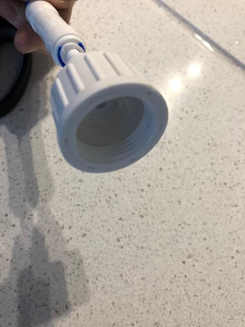

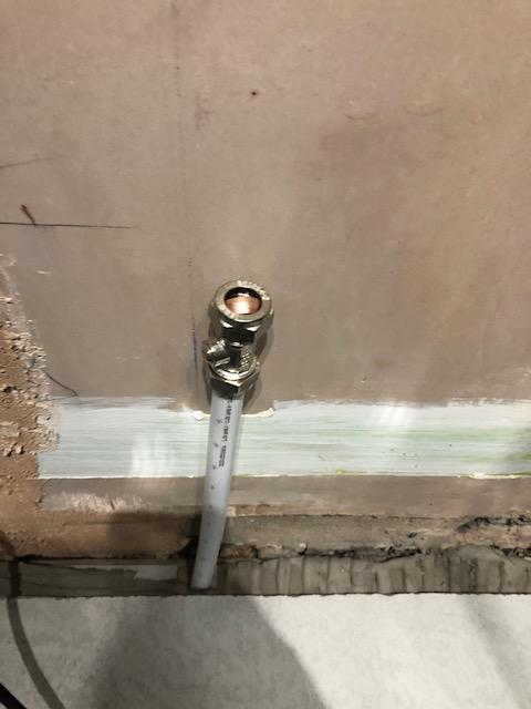

Toppers Posted December 23, 2019 Share Posted December 23, 2019 I have a stab of 15mm plastic pipe with an isolator connected to the mains and need to connect the plastic fitting for a water cooler to it, both fittings are of a different size with the white plastic water cooler one being the larger, what do I need to do to make the connection? Link to comment Share on other sites More sharing options...
Construction Channel Posted December 23, 2019 Share Posted December 23, 2019 You need one of these Europart Universal Straight Compression Fit Valve Tap, 3/4-Inch x 15 mm, Pack of 1 https://www.amazon.co.uk/dp/B0169N9F02/ref=cm_sw_r_cp_apa_i_y7jaEbF9XNWVY Link to comment Share on other sites More sharing options...
Toppers Posted December 23, 2019 Author Share Posted December 23, 2019 12 minutes ago, Construction Channel said: You need one of these Europart Universal Straight Compression Fit Valve Tap, 3/4-Inch x 15 mm, Pack of 1 https://www.amazon.co.uk/dp/B0169N9F02/ref=cm_sw_r_cp_apa_i_y7jaEbF9XNWVY Superb that looks perfect, many thanks. Link to comment Share on other sites More sharing options...
SiBee Posted December 23, 2019 Share Posted December 23, 2019 Can also be sourced from all the usual diy and plumbers merchants. Ask for a washing machine valve. It looks like a 3/4” bsp thread, it’s nothing unusual ? Link to comment Share on other sites More sharing options...
JFDIY Posted December 23, 2019 Share Posted December 23, 2019 Should be able to isolate the supply and swap that isolator to avoid unnecessary joins etc. Link to comment Share on other sites More sharing options...
