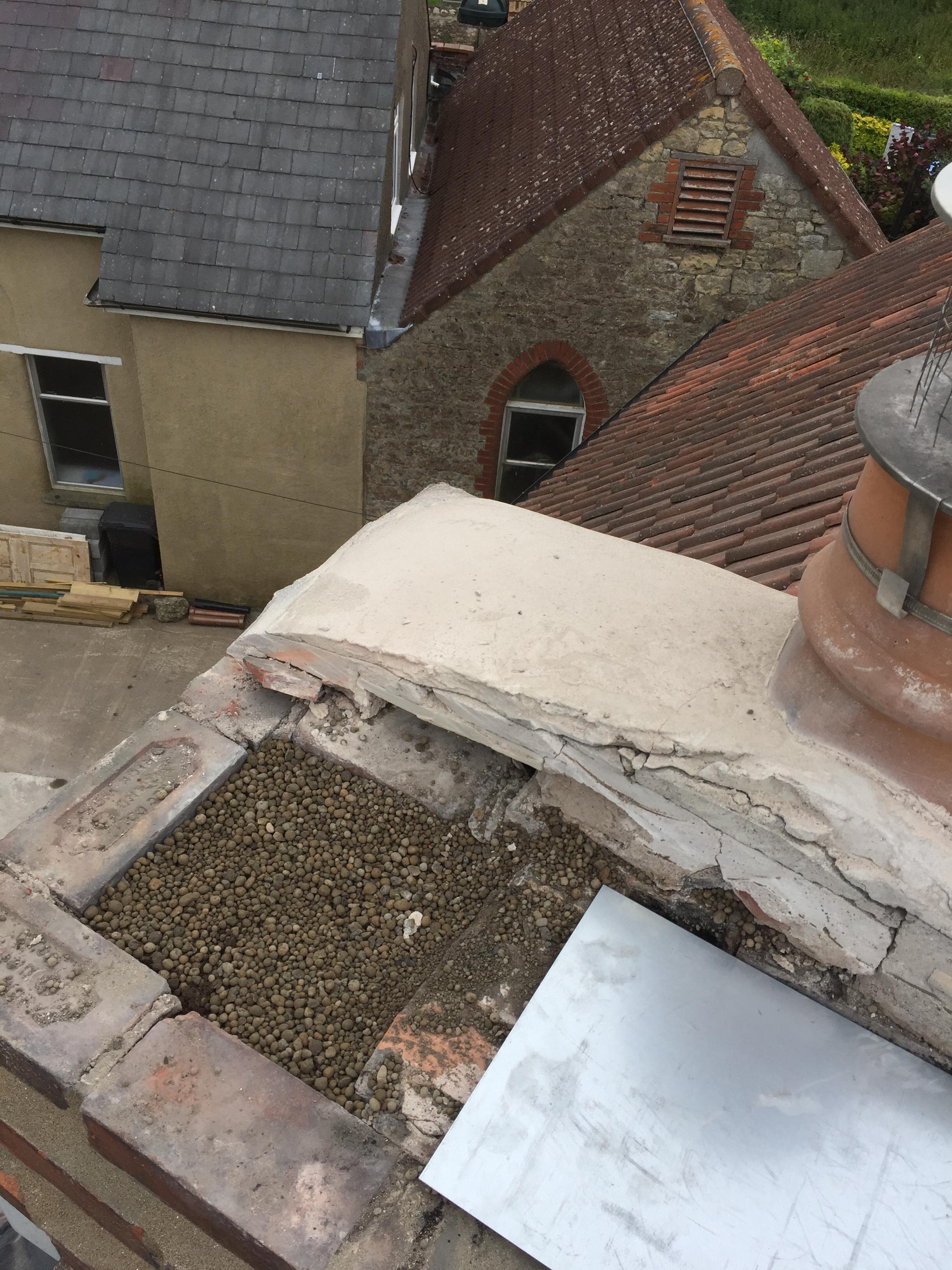

willbish Posted December 5, 2019 Share Posted December 5, 2019 If you have access to the chimney stack or are planning roof work soon (scaffolding) then I would seal the bottom with a steel register plate and fill the void with Leeca. Which is a lightweight blown aggregate insulation. Cap off the top and no need to ventilate as it is fully filled. Alternatively, if you can't get to the roof, then a chimney balloon can temporarily seal the bottom and stop your warm air escaping up the chimney. Link to comment Share on other sites More sharing options...

willbish Posted December 5, 2019 Share Posted December 5, 2019 Completely seal at the top if you are going to fill it. No need to vent unless there is a void, where moisture could be present. This is a picture of mine that I filled earlier in the year. Bear in mind its very difficult to estimate volume when ordering Leeca! Link to comment Share on other sites More sharing options...
