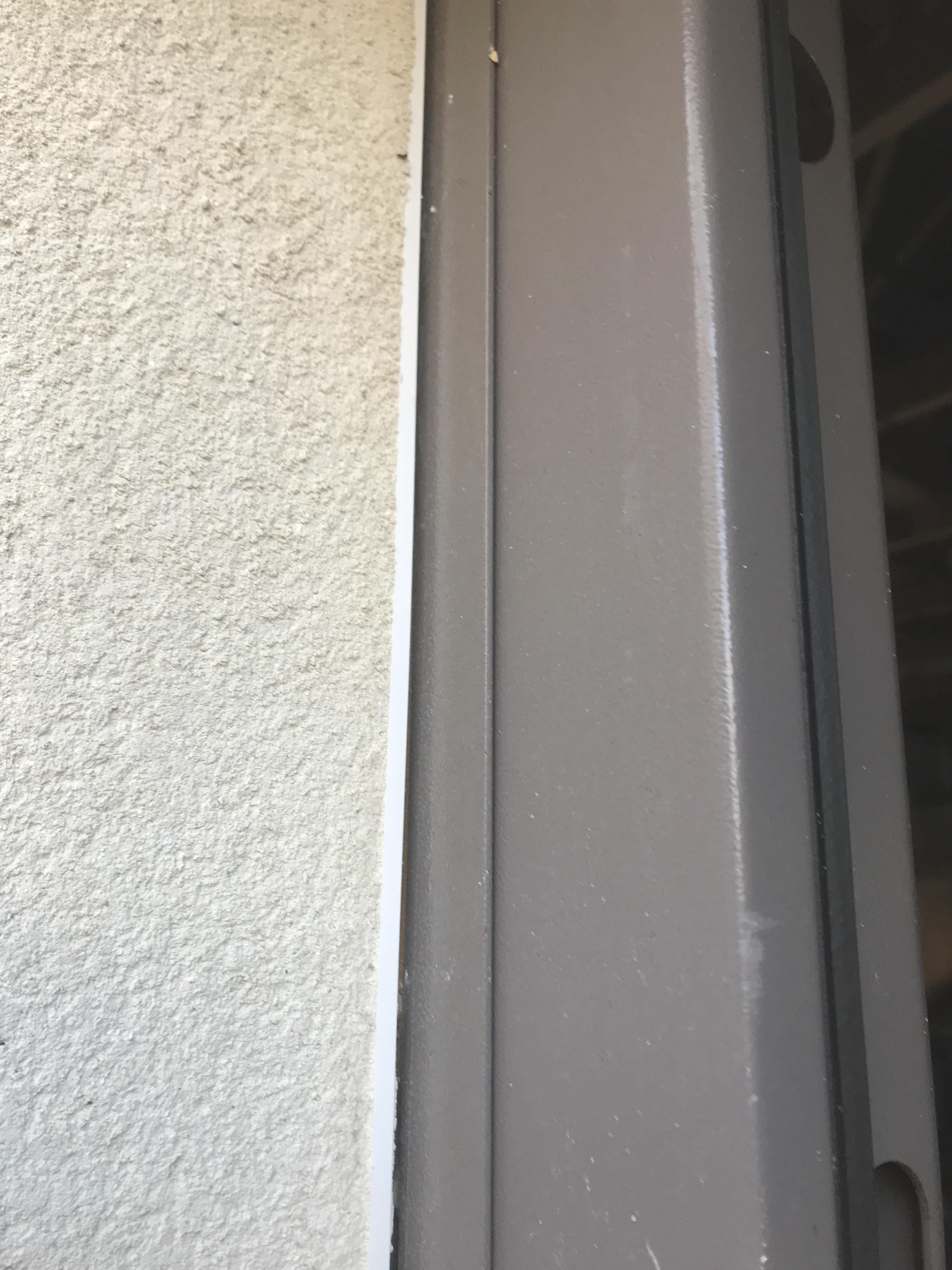

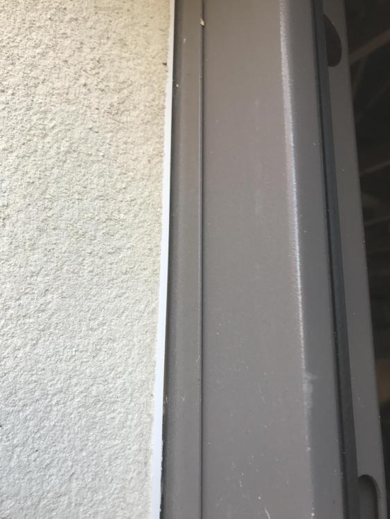

Alexphd1 Posted November 29, 2019 Share Posted November 29, 2019 @nod or anybody else with experience. We have 3-4mm gaps between the beads and window frames. Any recommendations on what to deal it with ? Krend pure white colour. Link to comment Share on other sites More sharing options...
nod Posted November 29, 2019 Share Posted November 29, 2019 We leave all like this They can crack the render in summer if they are tight Or left full Link to comment Share on other sites More sharing options...
Alexphd1 Posted November 29, 2019 Author Share Posted November 29, 2019 I was thinking of running a silicone bead up there such as ct1. Link to comment Share on other sites More sharing options...
Conor Posted November 29, 2019 Share Posted November 29, 2019 You can get window frame sealant, harder than silicone and doesn't fade in sunlight. And can get it colour matched to your frame colour if it's a standard RAL. Link to comment Share on other sites More sharing options...
Mr Punter Posted November 29, 2019 Share Posted November 29, 2019 49 minutes ago, Alexphd1 said: I was thinking of running a silicone bead up there such as ct1. CT1 is really difficult to finish nicely and is prone to discolouring. Link to comment Share on other sites More sharing options...
nod Posted November 29, 2019 Share Posted November 29, 2019 Sealant and K tend don’t go together Better to seal frames before render Link to comment Share on other sites More sharing options...
