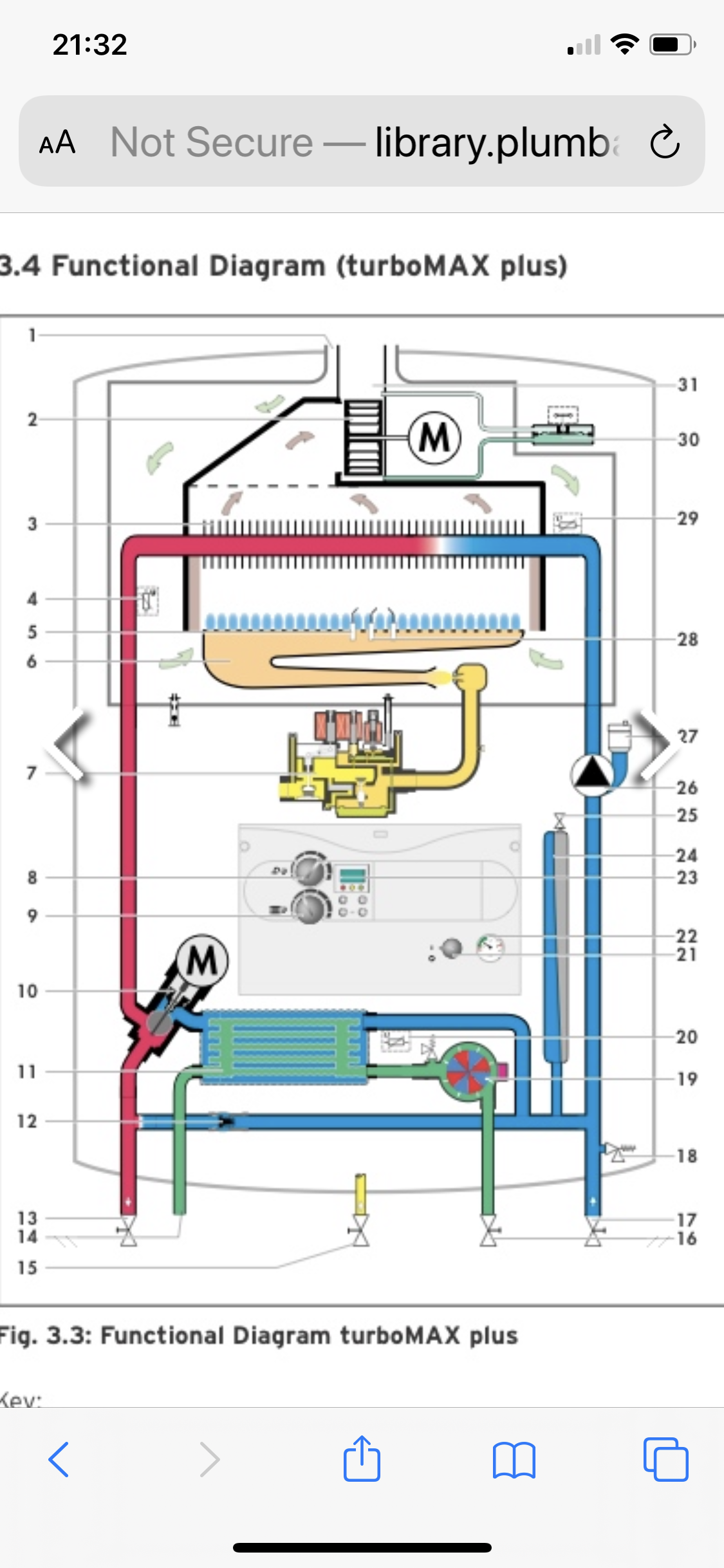

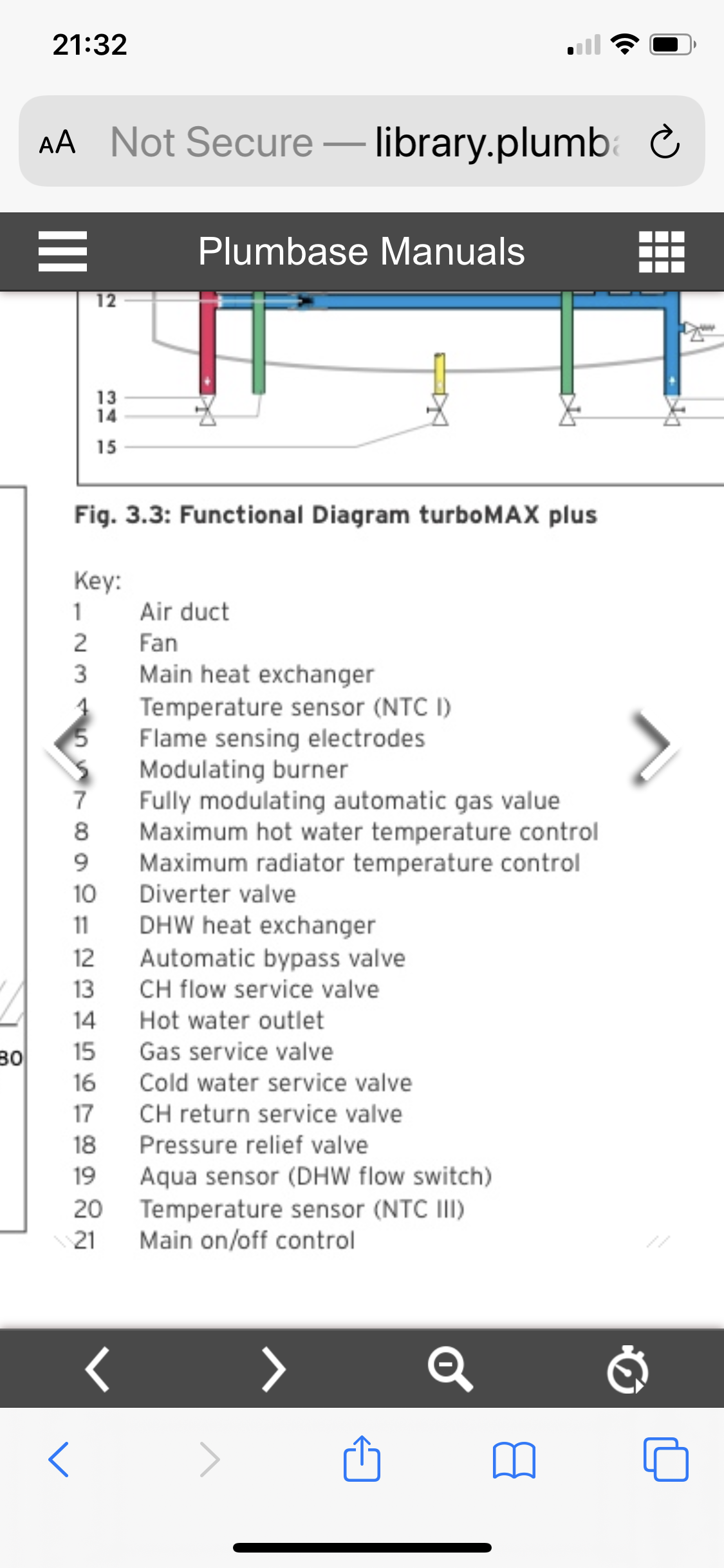

Mulberry View Posted November 26, 2019 Posted November 26, 2019 We've got a 15 year old Vaillant Turbomax 837 boiler, it's a hefty beast and has been pretty reliable. It's recently developed an intermittent fault. I'd say 1 in 10 times, possibly less, it doesn't fire on demand for hot water. There are no obvious errors and often shutting the tap off, waiting a couple of minutes and then going again will get it going. I've not noticed an issue on the heating side, although I realise that'd be less obvious. Any ideas where I could start looking?

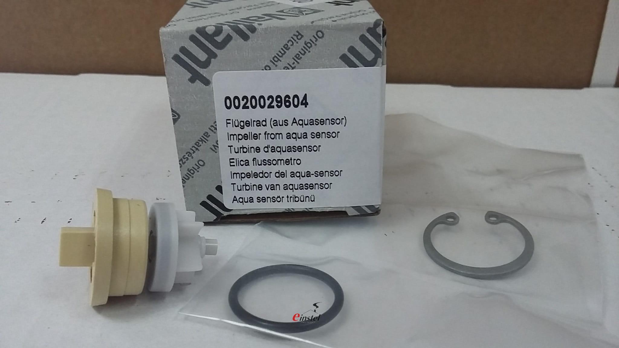

Nickfromwales Posted November 26, 2019 Posted November 26, 2019 It’s a small propeller type spindle that you can buy as a spare for a few £10’s. Easy enough to change too. https://rover.ebay.co.uk/rover/0/0/99?loc=https%3A%2F%2Fwww.ebay.co.uk%2Fp%2F2256002575%3Fiid%3D173512321204 Try that first and go from there ?? 1
Mulberry View Posted November 26, 2019 Author Posted November 26, 2019 11 minutes ago, Nickfromwales said: It’s a small propeller type spindle that you can buy as a spare for a few £10’s. Easy enough to change too. https://rover.ebay.co.uk/rover/0/0/99?loc=https%3A%2F%2Fwww.ebay.co.uk%2Fp%2F2256002575%3Fiid%3D173512321204 Try that first and go from there ?? Nick, Thanks for this, all very helpful. I've done a bit of work on the boiler anyway, so am *fairly* confident. I've had the DHW Heat Exchanger out a couple of times (once to clean it and once to replace it), I'll take a look at this over the weekend. ? 1

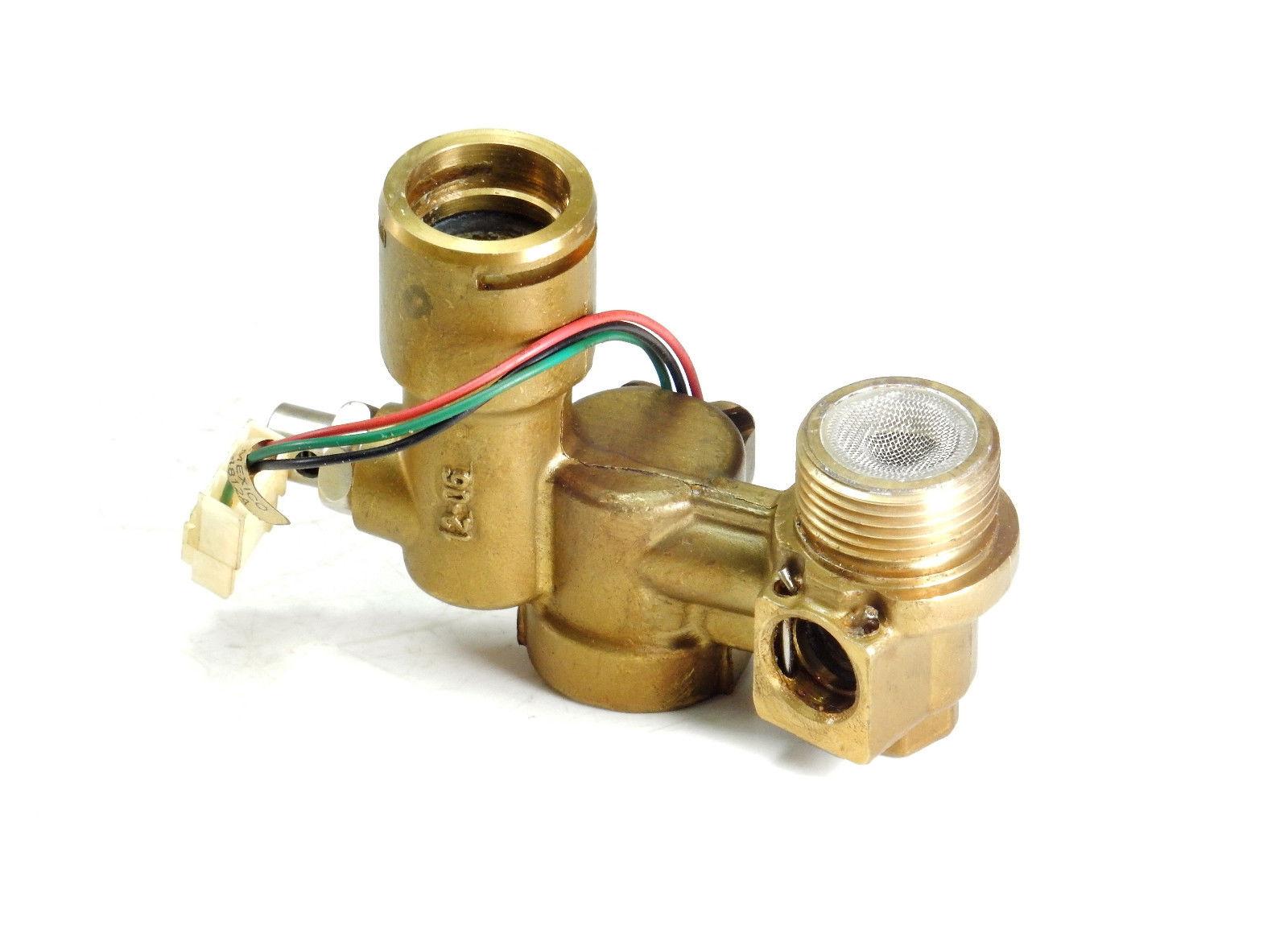

Mulberry View Posted November 27, 2019 Author Posted November 27, 2019 Further to this, I've noticed that some refer to the flow sensor as the small 'impellor' shown above, some as the whole brass affair. Is the impellor part of the larger brass assembly? I'm guessing the impellor itself has no electrics in it, logic would tell me that it either works or it doesn't?
