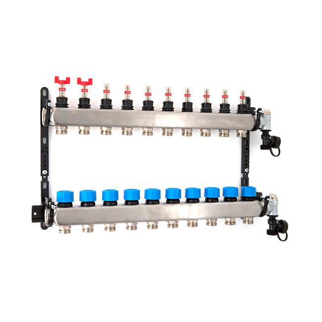

I thought I'd shop around for two 12 zone bare manifolds for my UFH project (no pump or mixing thermostat). It was interesting to see the large variation in cost, over £200.
inta-underfloor-heating-s-s-manifold-12-ports-24341_24341_P_1.jpg.c0d65e4f04f65d157cdba4a4d3eb1fe2.jpg
Screwfix                   £425
Tool Station             £407
Amazon                   £200
Ebay                         £189
BES                          £203
Builders Merchant £441
I'll probably buy from BES as I've used them before and are reliable.
