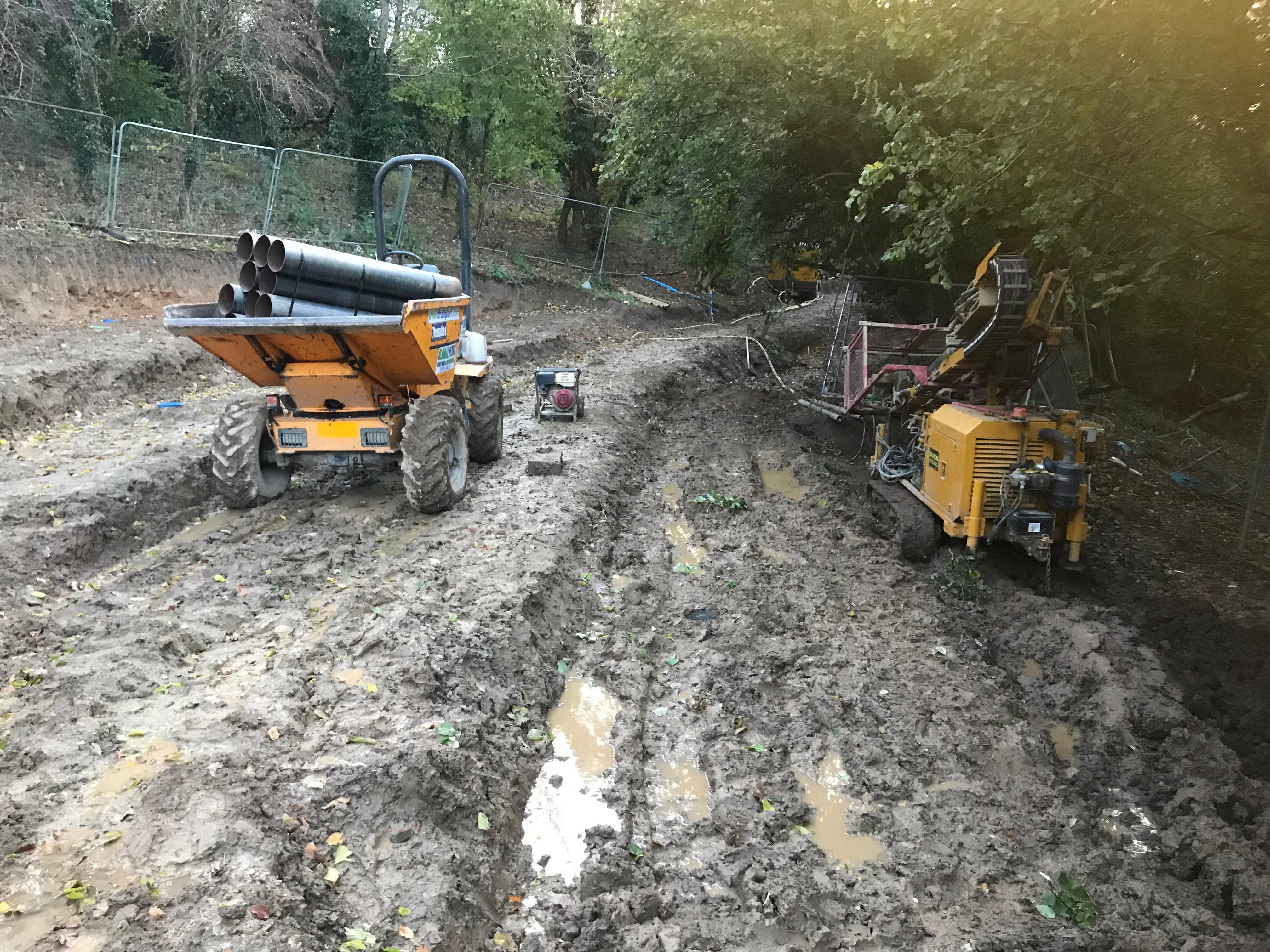

foundations are 41 odex piles driven 5M into the rock, each one is 220mm wide. And price has gone up as grounnd workers have had to come back and help dig out piling machine... re the timber we could have used C16 100x37 (or something like)

and here is a some man porn (sorry ladies, but well, its big and makes a loud noise)
