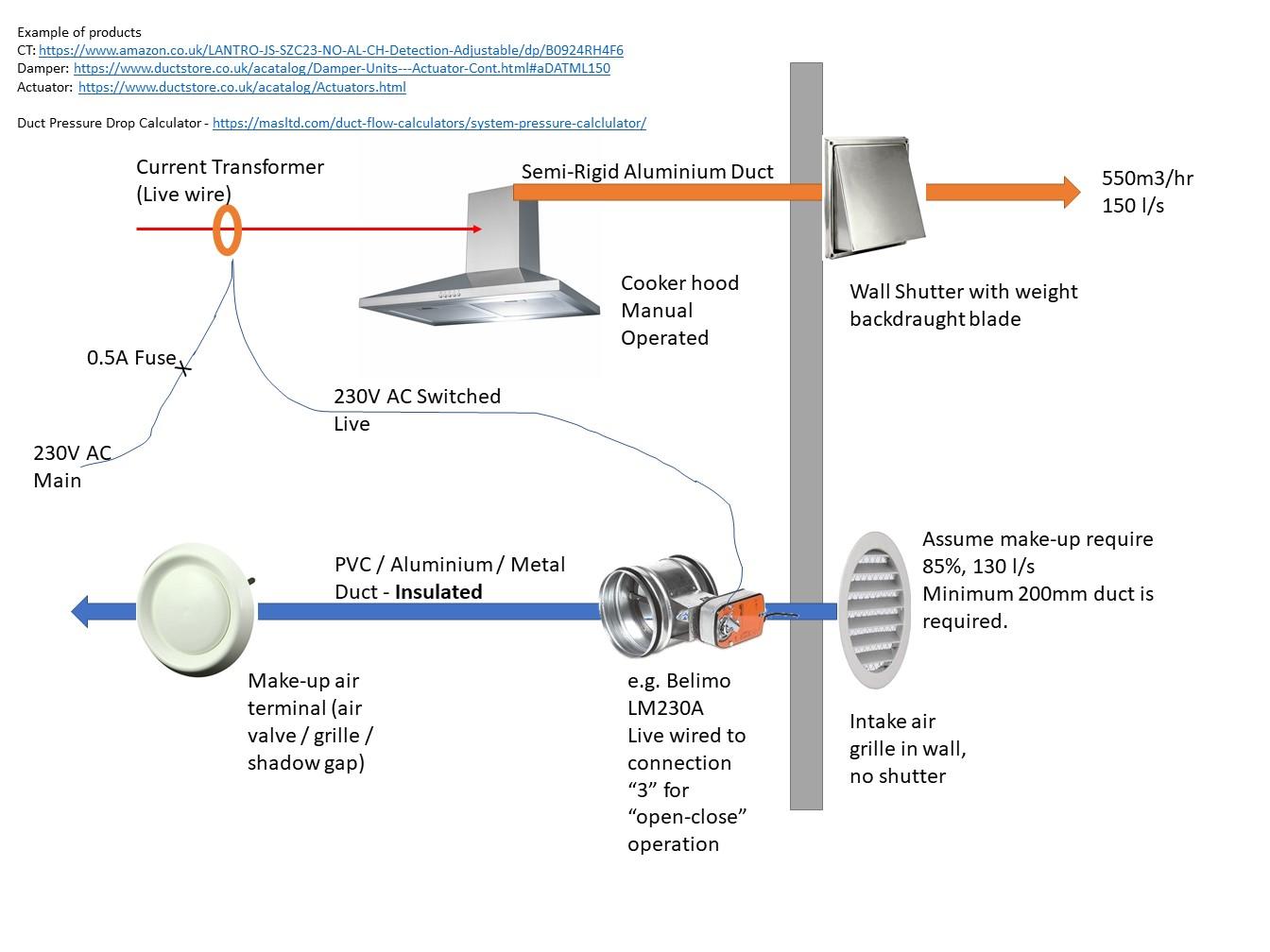

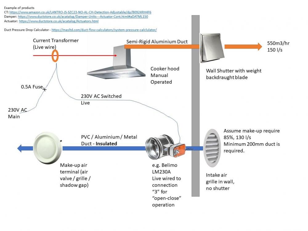

On 06/02/2022 at 20:49, hb1982 said:
I hope the attached makes sense to you.
A standard hood extraction of 150l/s (good quality 900mm hood) is not small for an air tight house. 200mm duct is recommended, 150mm is the absolute minimum.
Good idea. I'm investigating the idea of fitting a heat exchanger in the mix. You think it could work? One question the belimo, is there an automated switch that detectes the pull of current through the cable feeding the hood and switched it on?
TIA
