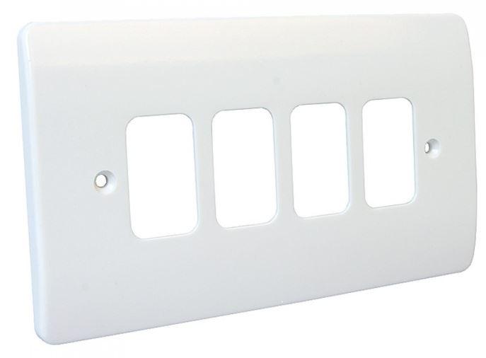

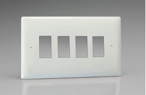

Onoff Posted November 6, 2019 Posted November 6, 2019 Replace the current plate entirely with a 4 gang grid plate either MK Logic or Varilight Powergrid. Fit 3 conventional grid switches and one matching Quinetic wireless grid switch, all either MK or Varilight. Use a Quinetic receiver on this other light you want to control. There is this but it's a faff when compared to the Quinetic solution plus you might need a deeper back box. https://www.tlc-direct.co.uk/Products/LMEST1.html?

Onoff Posted November 6, 2019 Posted November 6, 2019 Varilight Powergrid 4 gang white grid: MK: https://www.tlc-direct.co.uk/tcl/search?query=quinetic+grid+switch&Submit=Search

Onoff Posted January 1, 2020 Posted January 1, 2020 (edited) Erm...going back to your first post you had a 4 gang switch with one spare. You wanted to use the spare way to switch another light? Pick a make, MK or Varilight. Buy a 4 gang face plate. For this other light you want to switch put in a wireless grid switch. No wires on the back, nothing to connect, just clip it in (this is an MK one): Then for this new light you want to switch, you site a Quinetic receiver in the L & N supply to it. The receiver can be up in the ceiling or anywhere else. Nowhere you can jump in? Something like this. It literally jumps into the L&N going to the light. This is a standard receiver or you can use a dimming one. (The little white wire is the aerial): Pair them up and when you press the switch above the light goes on or off. That leaves 3 existing switches. These are the ones wired in. Replace them with "traditional" MK grid switches, like one of these depending on whether it's 1 or 2 way: https://www.tlc-direct.co.uk/Main_Index/Wiring_Accessories_Menu_Index/A_White_All/Grid_System/Grid_System_3/index.html So all switches match but one is wireless and paired with the remote receiver. So why the worry over the lack of neutral in the back box? Edited January 1, 2020 by Onoff
vfrdave Posted January 1, 2020 Author Posted January 1, 2020 1 hour ago, Onoff said: Erm...going back to your first post you had a 4 gang switch with one spare. You wanted to use the spare way to switch another light? Pick a make, MK or Varilight. Buy a 4 gang face plate. For this other light you want to switch put in a wireless grid switch. No wires on the back, nothing to connect, just clip it in (this is an MK one): Then for this new light you want to switch, you site a Quinetic receiver in the L & N supply to it. The receiver can be up in the ceiling or anywhere else. Nowhere you can jump in? Something like this. It literally jumps into the L&N going to the light. This is a standard receiver or you can use a dimming one. (The little white wire is the aerial): Pair them up and when you press the switch above the light goes on or off. That leaves 3 existing switches. These are the ones wired in. Replace them with "traditional" MK grid switches, like one of these depending on whether it's 1 or 2 way: https://www.tlc-direct.co.uk/Main_Index/Wiring_Accessories_Menu_Index/A_White_All/Grid_System/Grid_System_3/index.html So all switches match but one is wireless and paired with the remote receiver. So why the worry over the lack of neutral in the back box? The plan was to put the receiver in the deep back box behind the actual light switch for the one I wished to switch, but I have no neutral there. Lights are all in a vaulted ceiling with no accessible cabling that would allow me to secreet a receiver.
