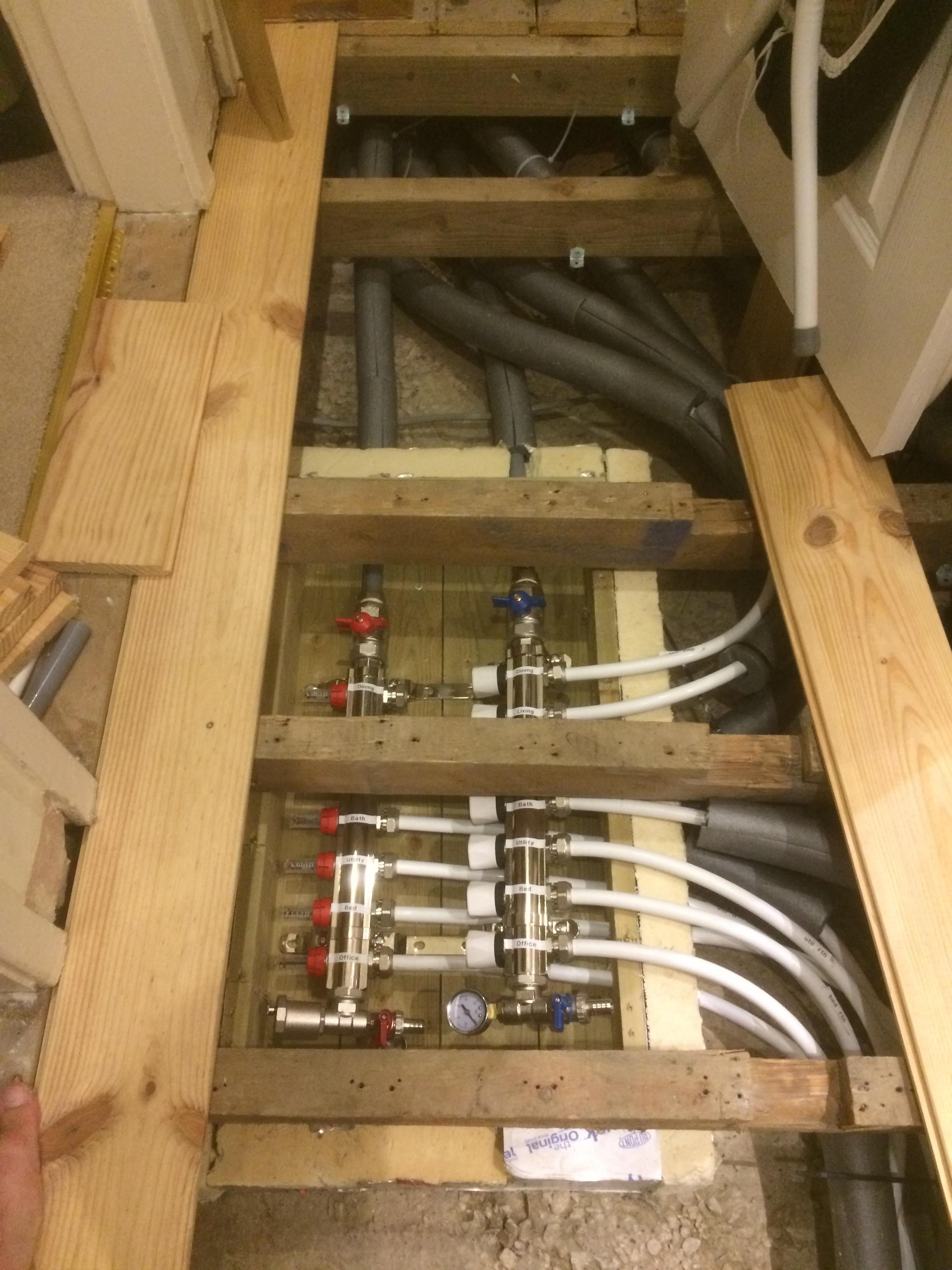

Raks Posted October 18, 2019 Share Posted October 18, 2019 Hi All; We need to insulate the timber joist floor rooms which have curved bay window radiators as part of renovation. While looking for insulation boards, I came across these between joist UFH solutions: https://www.theunderfloorheatingsto...eating-for-between-joists-or-suspended-floors I would like to get your advice and opinions on: - the "spreader plate" and "foil board" solutions seems easier to install but I wonder how efficient they are as there is no "thermal storage" screed. - around 50% of the bedroom floor area is covered with king size bed and furniture so the open floor area is limited. Is this enough for the UFH efficiency? - shall I keep the bay window radiator as a back up on a separate zone? - I was told there are manifolds for central heating with radiator systems as well which makes zone control quite easy and efficient. Is it worth to change pipe works of the other rooms' radiators as well with centralised manifolds? Thanks for your helps Link to comment Share on other sites More sharing options...
MikeGrahamT21 Posted October 18, 2019 Share Posted October 18, 2019 (edited) I can't comment on the underfloor heating product, as I don't have it, but I did recently change the Wall Hung Radiator pipework at my house to a manifold system, and MLCP pipe, and its so much better, easier to control, balance and portion of radiators if I need to remove them for whatever reason. We fed the pipes complete with insulation tie wrapped onto them throughout the entire house, with only a small 20cm2 hole in each room, and one access panel to give additional control, was a few hours work, and a lot of sweat and toil, but I'm really pleased with how it performs. In answer to your question, you can use any manifold, they're all the same, this was an underfloor heating manifold, with MLCP 16mm cones Edited October 18, 2019 by MikeGrahamT21 1 Link to comment Share on other sites More sharing options...

Temp Posted December 31, 2019 Share Posted December 31, 2019 (edited) We have a mix of spreader plates (under oak floor) and pipe in screed (under stone and tile). Both work ok but the spreader plate system warms up faster from cold. What matters more is: 1) How much insulation you can put under it and what's going over it? Put as much as possible under it. If I was building again I would aim for >150mm and 200+ wouldn't be unreasonable. Some people lay 18mm Chipboard and put 14mm engineered wood on top. It would be better to just to use 21mm engineered wood on its own. Chipboard and carpet? Keep the TOG of underlay and carpet to 2.0-2.5 in total. Special underlay exists. Hessian backed carpet is better than foam rubber. 2) how well your house is insulated overall? At the end of the day your bill depends mainly on how much energy the house looses and the fuel used (gas, oil, electric, ASHP etc) 3) and if you both go to work? If house is empty during the day a faster response time may be better. That way you don't spend ages putting heat into a floor only for it to come out when you aren't there. 4) it there much solar gain? If sun comes out can the heating system respond fast enough to the increased solar gain? Edited December 31, 2019 by Temp Link to comment Share on other sites More sharing options...
