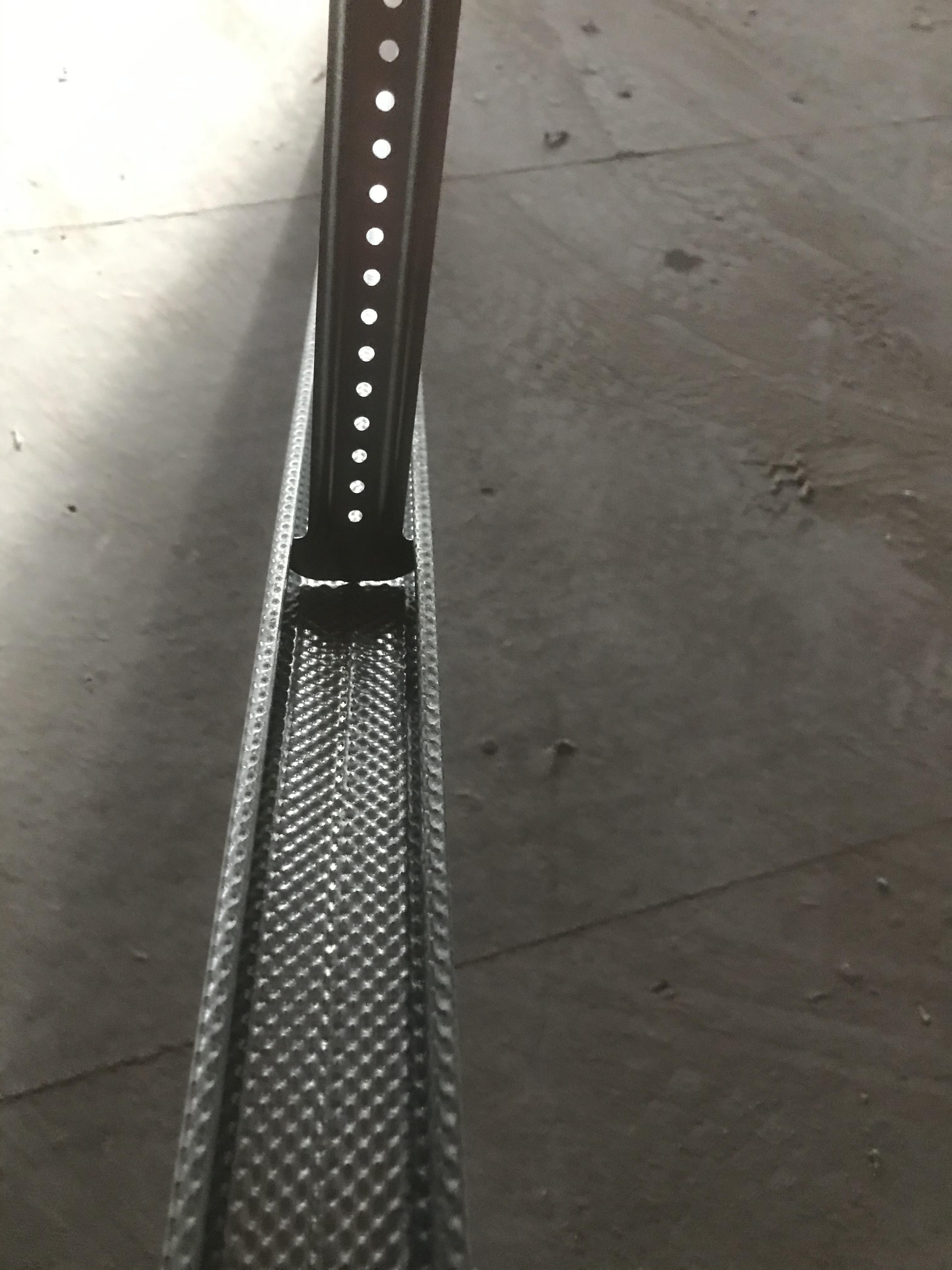

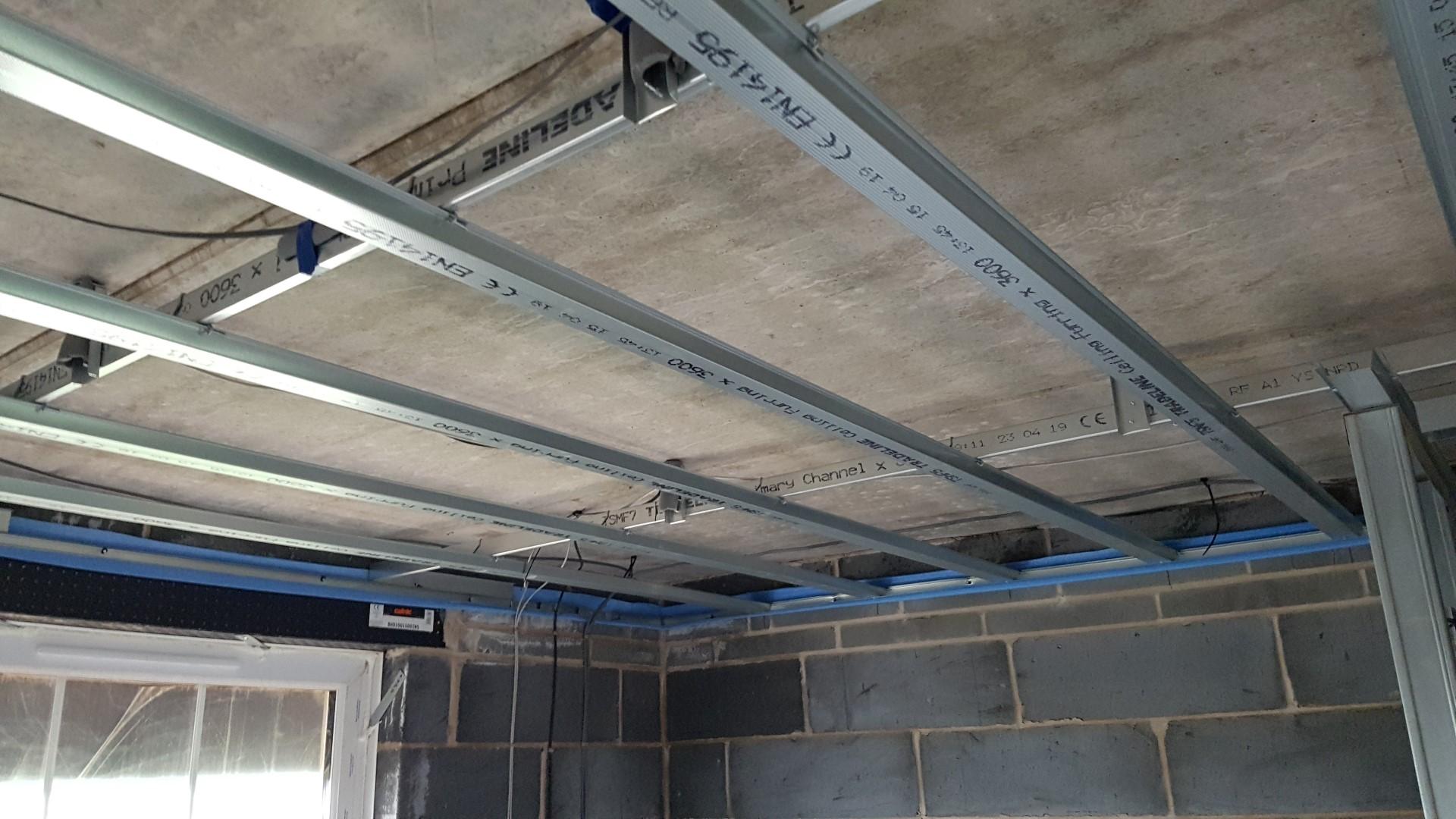

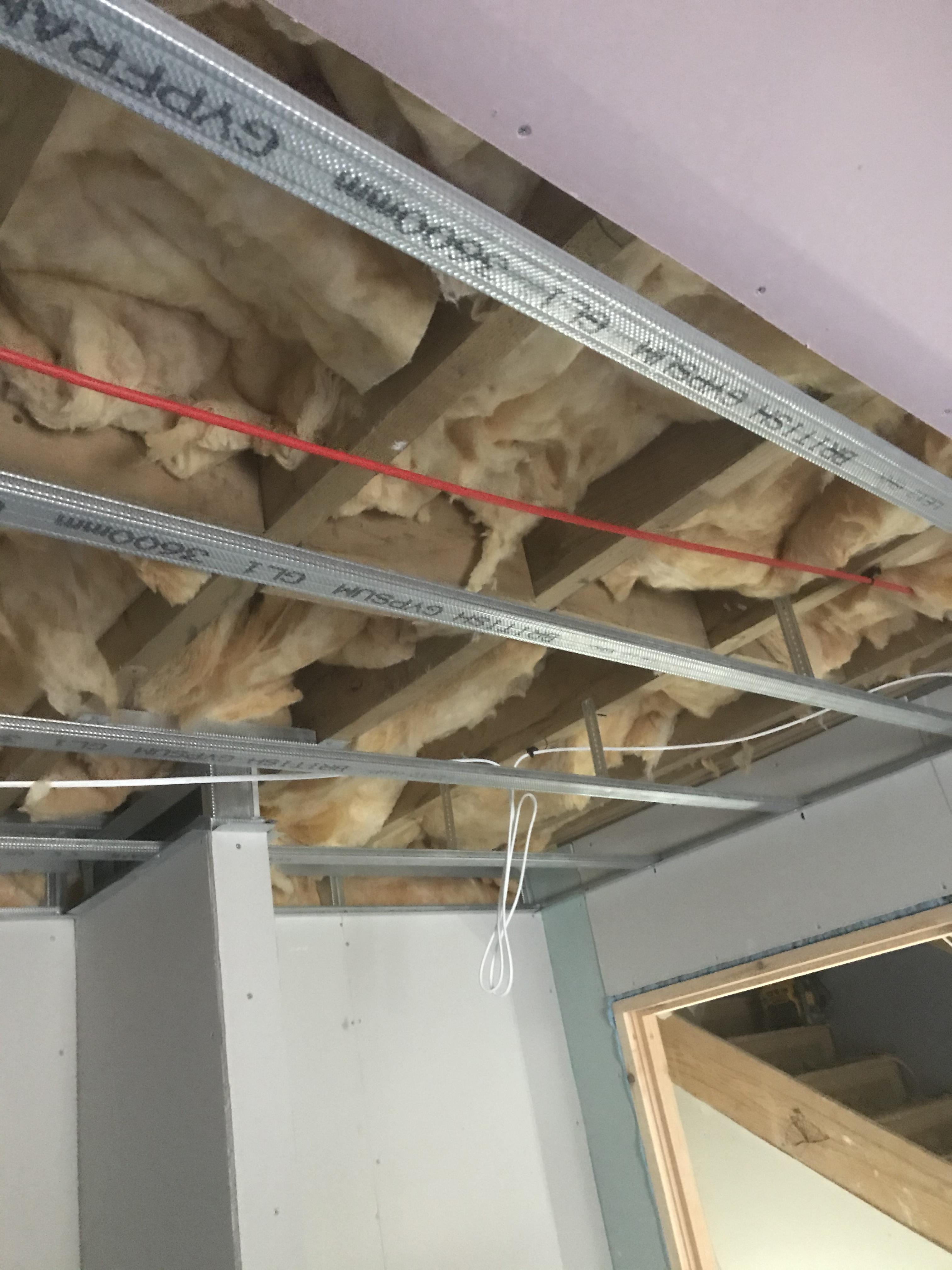

nod Posted October 17, 2019 Share Posted October 17, 2019 Just thought I’d share this with those that are looking for cheap Quick way of soundproofing Pictured is the standard gypliner with push fit brackets These simply screw to the side of the joists in a 400 x 1200 grid pattern Then clip the gypliner stud in place You can create a void from 25 mil to 150 2 Link to comment Share on other sites More sharing options...
Oz07 Posted October 17, 2019 Share Posted October 17, 2019 @nod Whats longest length of that ceiling track? I only ever see 3.6's How much is the overlap if joining together? Do you fix a channel to perimeter? Assume you always use 15mm boards with this as your not going to be able to nog the end joints of boards Link to comment Share on other sites More sharing options...
nod Posted October 17, 2019 Author Share Posted October 17, 2019 3.6 you can join with a bit of track either side Or use the bg jointing clips no overlap Link to comment Share on other sites More sharing options...
Moonshine Posted October 17, 2019 Share Posted October 17, 2019 Am i missing something, but that is still looks like a rigid connection from the ceiling to the joist. If you are going for enhanced acoustics and have the luxury of up to 150mm space available, its better to have a completely independent ceiling or hang the frame from GAH hangers or equivalent, with some insulation above the plasterboard. https://www.british-gypsum.com/products/gypframe-acoustic-hangers?tab0=0 Link to comment Share on other sites More sharing options...
nod Posted October 17, 2019 Author Share Posted October 17, 2019 14 minutes ago, Moonshine said: Am i missing something, but that is still looks like a rigid connection from the ceiling to the joist. If you are going for enhanced acoustics and have the luxury of up to 150mm space available, its better to have a completely independent ceiling or hang the frame from GAH hangers or equivalent, with some insulation above the plasterboard. We are covering rigged ducting and fireproofed beams So we haven’t the luxury of 150 on the whole ceiling In places we have only 10 mil The perforated hangers are so fine You will get only a limited amount of ST https://www.british-gypsum.com/products/gypframe-acoustic-hangers?tab0=0 Link to comment Share on other sites More sharing options...
AdamSee Posted October 17, 2019 Share Posted October 17, 2019 looks good. I can see how it would have some good acoustic performances. I guess it also gives the option of completely overseeing the ceiling with rockwool to help as well. How come you decided to lower your ceiling? I'm was planning on using this system to do my living room ceiling as I need to lower it 100mm to make space for some semi rigid ducting and various other pipes. But I'm still a bit lost as to the best method to fit the perimeter track. Should I dot and dab the walls first getting it nice and flat, then fit the track using some long rawl plugs? Im guessing that as long as I drill through the continuous strip of adhesive at the top of the board, I shouldn't have a problem. The other option is trying to fit to very uneven old brickwork. Link to comment Share on other sites More sharing options...

nod Posted October 17, 2019 Author Share Posted October 17, 2019 5 minutes ago, Moonshine said: For a resiliently hung ceiling you can use a product such as isosonic ceiling strip, which is in a lot of Robust Details, installed as below (E-FC-4 Concrete party floor), however you are always going to need to penetrate the strip to fix the track to the perimeter wall. Its not perfect but minimises the flaking noise from the perimeter walls. I think you are getting confused The system you have googled Is for concrete You can only hang a ceiling from the underside if you fixing into concrete with tap cons knock ins etc With timber joists you most always fix into the sides as the fixing can pull out otherwise I use this system all the time Tends to be on concrete You still need a primary bar Which is 50!mil on top of anything that’s in the ceiling Plus 10 mil for the top hat Another 25 for brackets In short you need a minimum of 100 mill If you have ducting or steels etc Your going to have a build up of 75 mil Plus boards With the clock system you minimum is 10 mil Plus PS Link to comment Share on other sites More sharing options...
Moonshine Posted October 17, 2019 Share Posted October 17, 2019 18 minutes ago, nod said: I think you are getting confused The system you have googled Is for concrete You can only hang a ceiling from the underside if you fixing into concrete with tap cons knock ins etc With timber joists you most always fix into the sides as the fixing can pull out otherwise Nope i actually am not, the GAH were actually designed for timber, see below and also BG system ref (C106026). https://www.gyproc.ie/sites/default/files/C106013.pdf Note that the fixings are sideways into the joist. Link to comment Share on other sites More sharing options...
