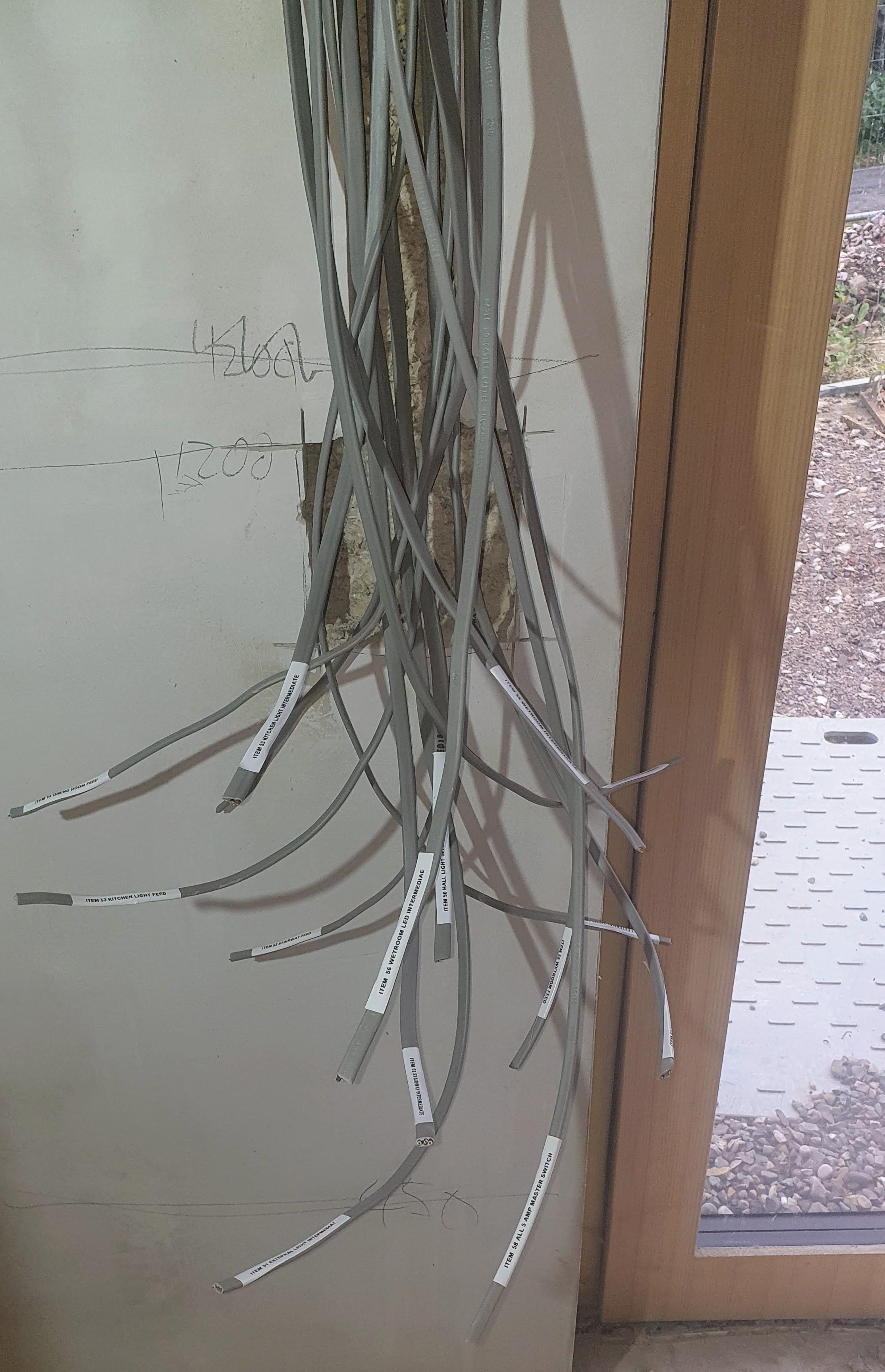

ToughButterCup Posted October 15, 2019 Posted October 15, 2019 ?: that's an emoji of me right there looking at a Scolmore 2 tier, 12 gang Minigrid Module and the associated plate, yoke and backbox. The practice of simplicity at last. But wait, whassthis? Nope, it's not spaghetti, it's the wiring for 7 intermediate switches and 3 one ways. Two bays spare .... Looking at the backbox, I see a mere 10 knockouts. Knees shaking a bit...... Please Dave and Clive ( @ProDave and @Onoff ) please sirs, can I drill a couple more holes in the backbox K.O. (WA512) if I need to too? I promise to drill them exactly the right size, and fit a lovely top specification grommet in each hole drilled. I also promise not do anything unethical, illegal, or untruthful or try to hide anything (but a cheque book) from any tame Part P who walks through the door. Honest.

ProDave Posted October 15, 2019 Posted October 15, 2019 How many cables do you have? You know you can get at least two, and sometimes three through a 20mm grommet.
ToughButterCup Posted October 15, 2019 Author Posted October 15, 2019 Hmmmm. I don't have enough fingers to count that many. ? I think I'll give it a go and get back to you when I have ballsed it all up. Here's yet another steep learning curve I got myself into.
