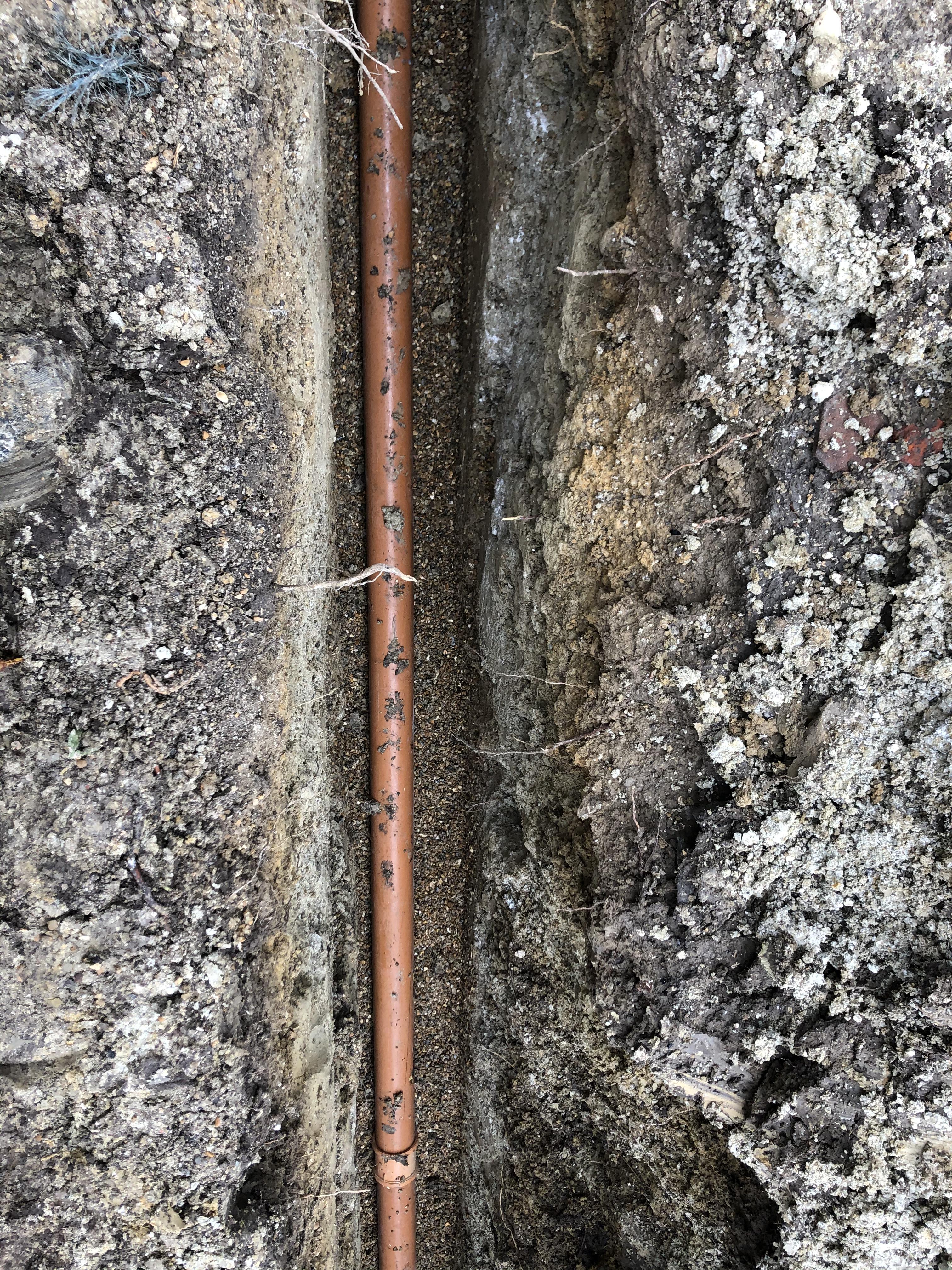

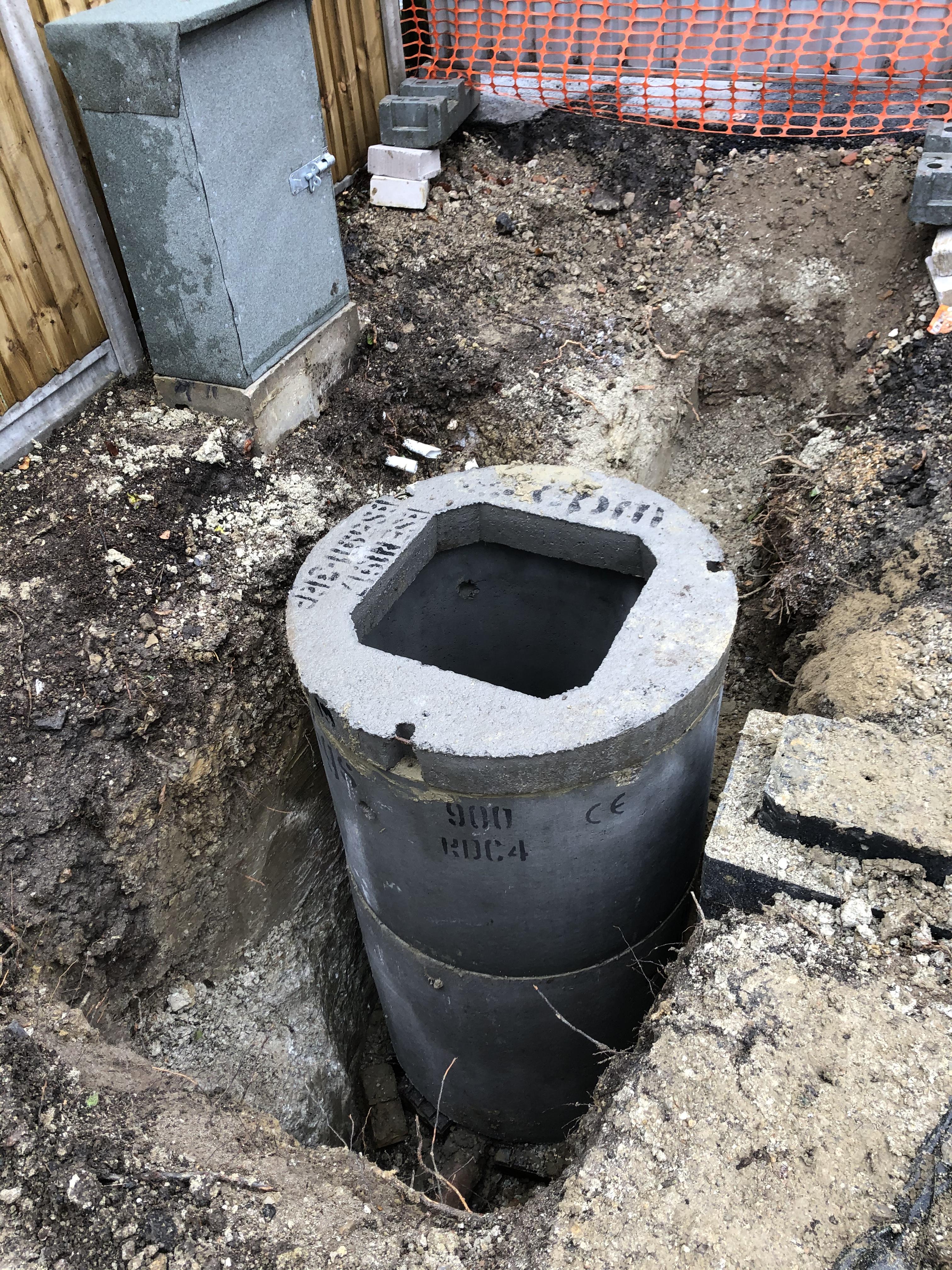

Lee woodfine Posted October 12, 2019 Share Posted October 12, 2019 Well little update. Had the foul drain installed over the last week, 2.5m down in the road and 7m of piperun. A week to complete except for the manhole access on my ground. lots more digging and 1.85m of concrete rings installed my me and my wife. done bloody well I might add. Haha. Just wanting to spread some happiness with progress. ???? 5 Link to comment Share on other sites More sharing options...

PeterW Posted October 13, 2019 Share Posted October 13, 2019 9 hours ago, Lee woodfine said: Well little update. Had the foul drain installed over the last week, 2.5m down in the road and 7m of piperun. A week to complete except for the manhole access on my ground. lots more digging and 1.85m of concrete rings installed my me and my wife. done bloody well I might add. Haha. Just wanting to spread some happiness with progress. ???? Looks good. Have those rings got steel rungs on them ..? It gets very odd with the rules about restricting access over a certain depth and BCO may want something adding to the top of the brickwork so beware. Link to comment Share on other sites More sharing options...

Lee woodfine Posted October 13, 2019 Author Share Posted October 13, 2019 13 hours ago, PeterW said: Looks good. Have those rings got steel rungs on them ..? It gets very odd with the rules about restricting access over a certain depth and BCO may want something adding to the top of the brickwork so beware. Hi, no I got given the choice of st ps or not so went for no steps. It’s 1.75m down to the bottom so a small ladder will get you access. Have got about another 12ish inches to build up yet so just a brick topper to it to fit the cover. Link to comment Share on other sites More sharing options...

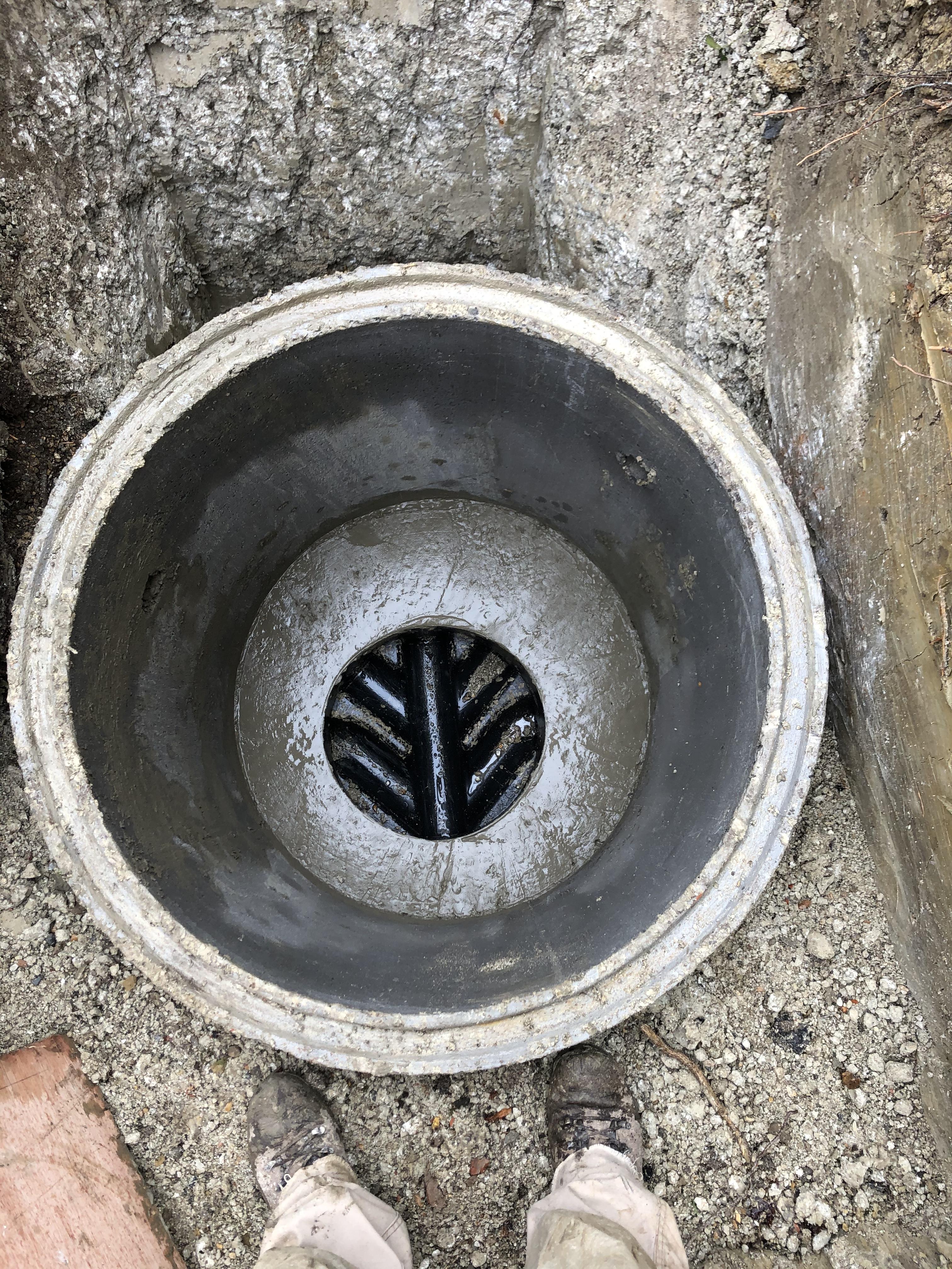

Lee woodfine Posted October 13, 2019 Author Share Posted October 13, 2019 All concreted in and ready for benching up,( this was just before the kid went on). Got the long pipework runs in on my side and never used so much pea shingle before in my life!!!! Link to comment Share on other sites More sharing options...
