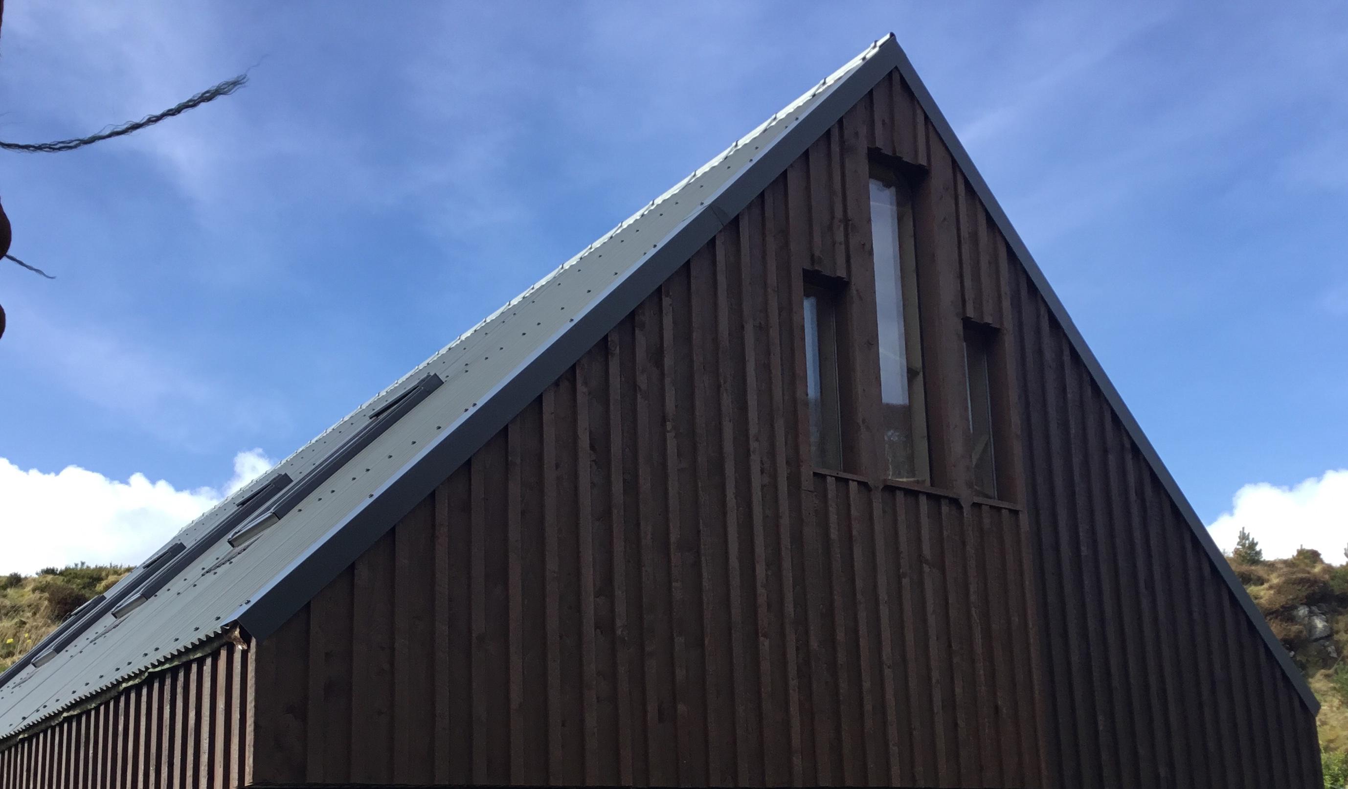

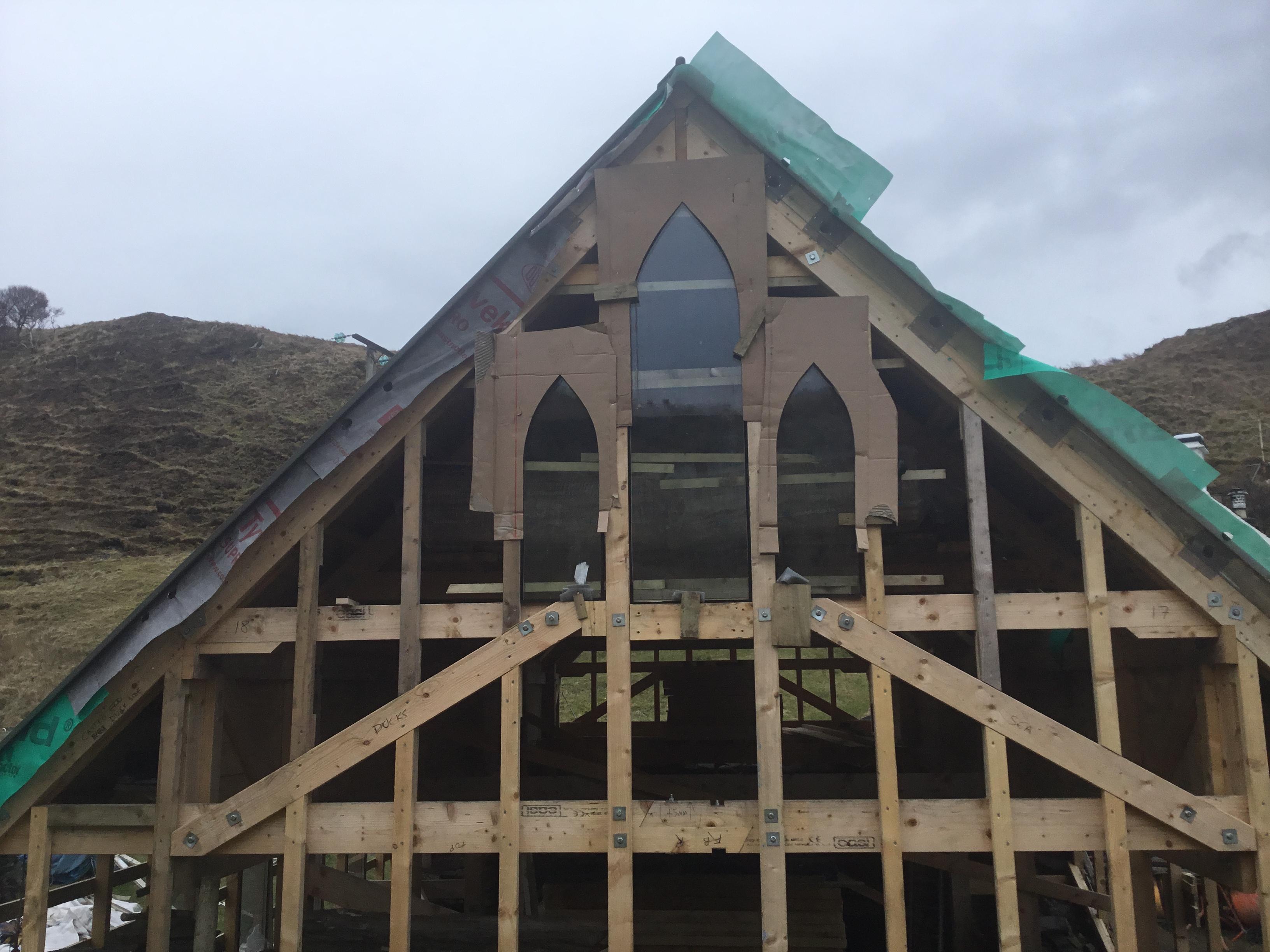

Cpd Posted November 19, 2021 Share Posted November 19, 2021 As your venting above the insulation and I assume above the ply I don’t think you need to worry about venting the ridge. Vent between the ply and tin by using insect mesh along the gap at the bottom, this should provide adequate ventilation. I added some vents along the eves as well…. Probably unnecessary but additional ventilation can’t harm a roof like this. ignore the arched windows…. Was just playing With ideas. You can see the vents running down the eves. Link to comment Share on other sites More sharing options...
GeGe Posted November 19, 2021 Share Posted November 19, 2021 (edited) Thanks @Cpd.... I've always thought you need to have through ventilation, i.e ridge vents widely available for other types of material !? I guess Building Control will raise it when we start building? Might have to go down a proprietary metal ridge profile that allows for breathability, if they insist. Nice cladding BTW! P.s did you go for the EDW flashing for your Velux windows? Edited November 19, 2021 by GeGe Link to comment Share on other sites More sharing options...
Cpd Posted November 19, 2021 Share Posted November 19, 2021 4 hours ago, GeGe said: you go for the EDW flashing for your Velux windows? Yes if memory serves me……. 1 Link to comment Share on other sites More sharing options...
