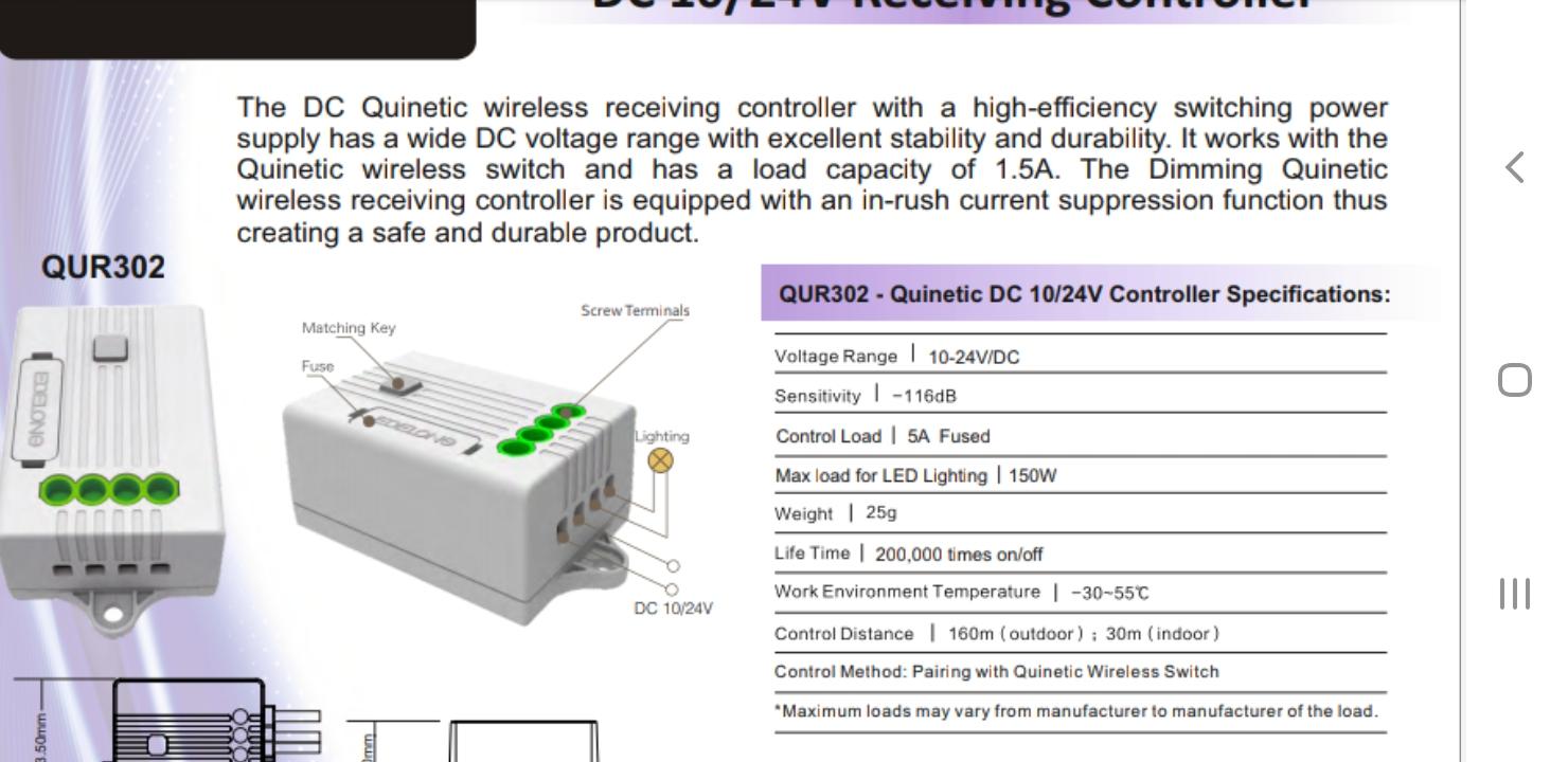

Onoff Posted October 8, 2019 Posted October 8, 2019 (edited) To control a single set of lights you'll need to go: 230vac > CV05 > input (230vac) side of transformer > "fairy lights". So one transformer per set of lights. If using Quinetic you can get 3 gang switches even ones suitable for outside. You can also get a dual receiver, their QUR323, not a 3 channel one though sadly... or You CAN also get the QUR302 DC receiver that'll switch 24v DC at 5A. So trannie output into the DC 10/24 side. I'd stick with separate trannies (& receivers) or it's one out all out. Edited October 8, 2019 by Onoff 1
efunc Posted October 8, 2019 Author Posted October 8, 2019 Thank you, that's very interesting! So to install the two sets of lights I could either run them both off one Quinetic Wireless Switch Dual Receiver or two of the single Wireless Switch Receivers. Am I right in thinking they may be too powerful for my LED lights though and I should get something better matched? I understand that LED lights are really prone to instability and for low loads (like 4w in total) I might be better with a a regulated 12v DC power supply rather than a transformer to avoid over voltage. Is that correct? There seems to be some advice about that here: https://www.lightingforgardens.com/garden-lighting-tips-led-power-supply If that's the case I could presumably still get a couple of regulated PSUs for the LED lights combined with two of the CV05 receivers or Quinetic equivalents. There seems to be a lot of issues to consider with LED lighting, like voltage drop on long cable runs and proximity of transformer to the lamps, etc.
Onoff Posted October 8, 2019 Posted October 8, 2019 The Quinetic receiver can only handle a load UP TO 5A between 10 & 24vdc. The receiver is thus not "too powerful". The receiver doesn't put anything out per se it's about what it can handle current wise. If you try and draw a load over 5A via the receiver it won't handle it (well, probably not for very long).

efunc Posted October 13, 2019 Author Posted October 13, 2019 OK, inspired by Onoff's wiring installation I've been looking into this some more and getting closer to choosing what I need. If I purchase a 'DriBox' and place a 2 or 4 gang trailing socket can this be connected directly to the 240v power cable I have coming down from the ceiling without yet another mains socket in between? The box will house a transformer (or two PSUs) for the 2 EZVIZ security cameras, and one of the following layouts for the Techmar garden light kit I linked to previously: Or Because the Techmar transformer has a special weather sealed connector on the 21v output I would need one of their special output splitters and then cut the cable for the Quinetic QUR323 before requiring another one of their connectors to rejoin the cable for the lights. For this reason I would prefer running two of their transformers independently instead. Also I thought that maybe the residual power draw of the transformers could be contained better if they're placed after the QUR323. However TLC could not tell me what the power draw of the QUR323 when switched off, nor whether it supports 12v A/C. Would this setup otherwise work OK?
Onoff Posted October 13, 2019 Posted October 13, 2019 QUR323 is 85-260V AC input. Doubt very much if it'll work on 12V AC. I'd say in fact it won't. 1
