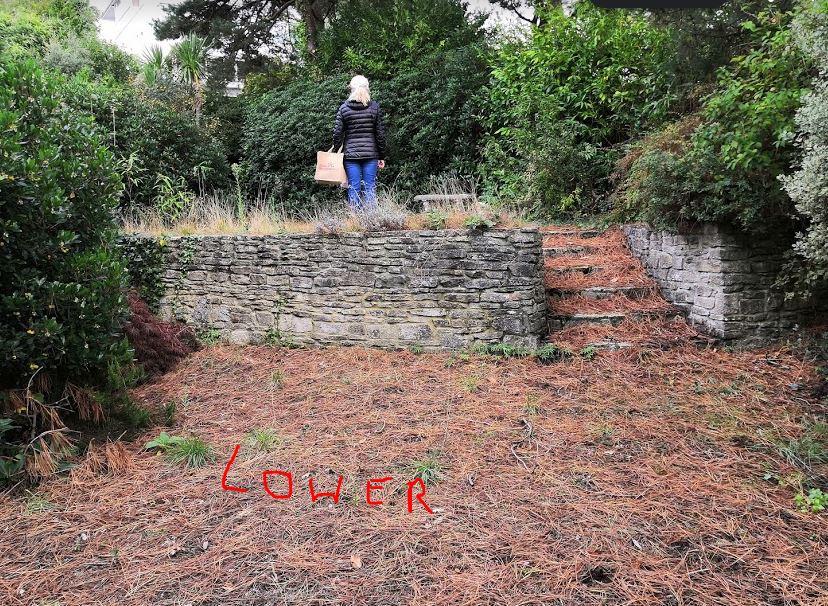

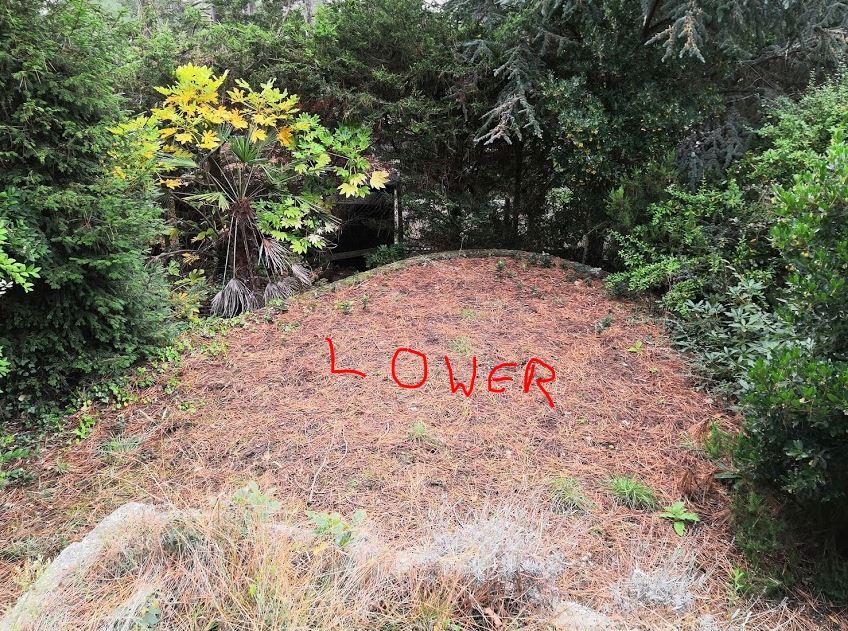

Adam2 Posted September 29, 2019 Posted September 29, 2019 Am building (demo + rebuild) and planning site for soakaway crates. Garden is on a fair old slope and I was wondering if possibility to use the soakaways to help level up the bottom part of the garden - wanted to test my idea here before going to BC (independent). If relevant, f is 0.000016 and run-off will be ~440m2 The existing garden is tiered and heavily overgrown aside from the lower area where there are 2 flatish areas of lawn (well pine needle covered moss) where the lower level is 1m down with an existing retaiing wall. I'm wondering if I could do the following: 1. On lower garden level, install a retaining wall - using gabions about 1m high 2. Remove the top ~800mm of soil for the area required from lower level 3. Put down base (if required) for crates 4. Install the drainage connection into the crates for later connection into the drainage coming down from house 5. Install membrane around creates 6. backfill with gravel etc around crates to fill in gap down to the new retaining wall (probably including some rubble from demolition) 7. replace the soil from (2) over/around the crates/rubble etc raising the finished level to match upper level - probably looking at 300mm of topsoil Crates would be surrounded by between 2 & 3m of soil/rubble Maybe would need a waterproof membrane inside the gabion retaining wall to help ensure water does not through them Couple of images one looking up from lower level and w looking down onto lower level. Suggestions on improving etc appreciated
Jeremy Harris Posted September 29, 2019 Posted September 29, 2019 Probably OK. Wrap the crates in terram before covering, so they don't end up filled with backwashed sediment. What's supporting that lower area, in terms of a retaining structure? Might be an issue with the increased surcharge from the increased height of the lower area imposing an unacceptably high load on whatever is retaining it. Not hard to do the calculations to see if it's OK, though.
Adam2 Posted September 29, 2019 Author Posted September 29, 2019 13 minutes ago, JSHarris said: What's supporting that lower area, in terms of a retaining structure? Same style of retaining wall as per the upper one in the first image. The furthest part of the lower area retaining wall (so the bit above the "W" in pic 2) is ~3m from the end of our garden so we could build up the gabions from the other side of the lower area and then not reply on the existing retaining wall supporting the lower area. Will have to see if we can get our demolition cost reduced if we use this much rubble! This will all be about 30m from the house and involves a drop of about 8m - would we need some form of intermediate attenuation to avoid the high speed water delivery into the crates?
Jeremy Harris Posted September 29, 2019 Posted September 29, 2019 The crates should work fine to attenuate the flow. If the surcharge load from the crates and backfilled area is kept a distance back from the edge of whatever is supporting that lower area then there probably won't be a problem. There's a critical angle back from the base that determines this, and IIRC it's buried in the depths of Eurocode 7 somewhere (I have a copy of that on another PC). 1
