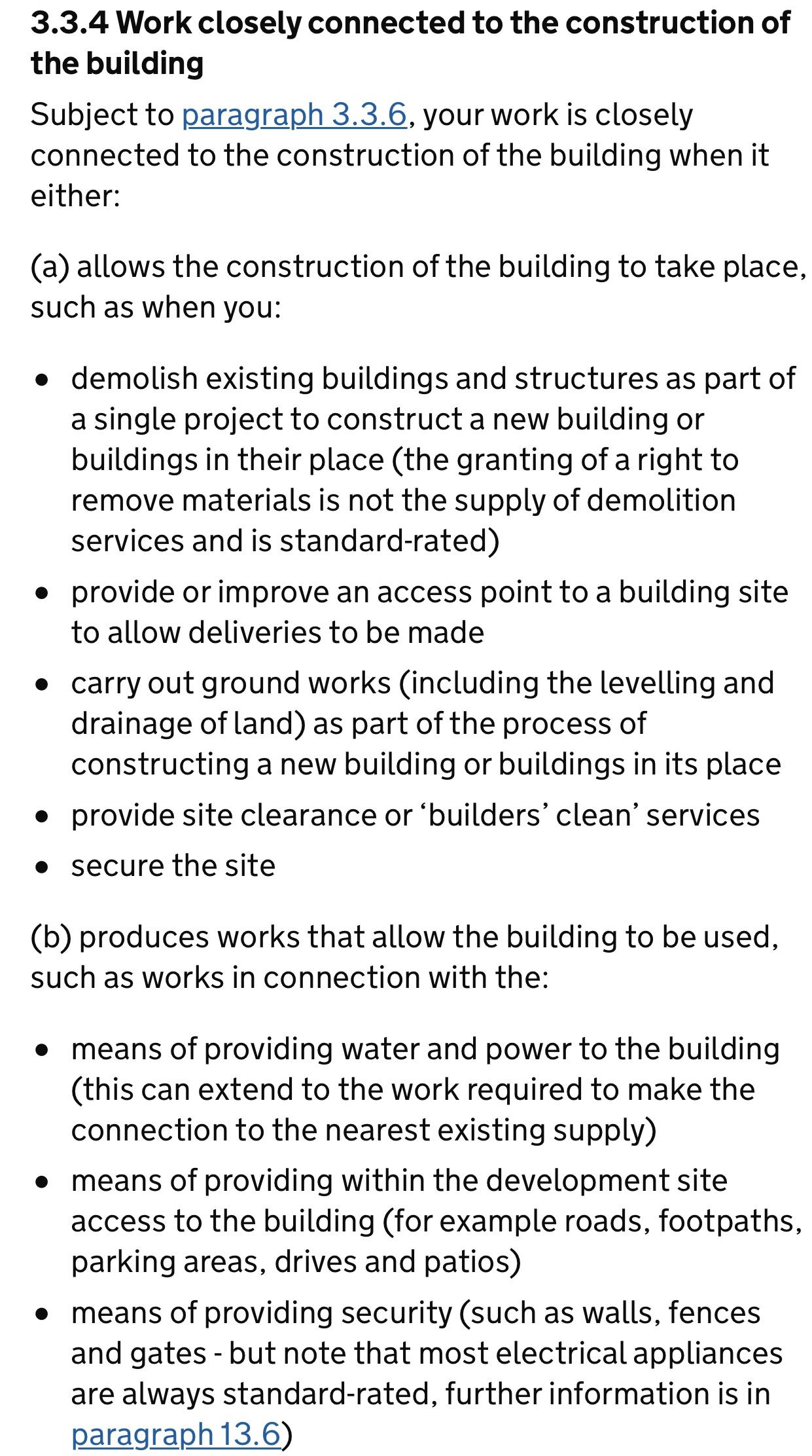

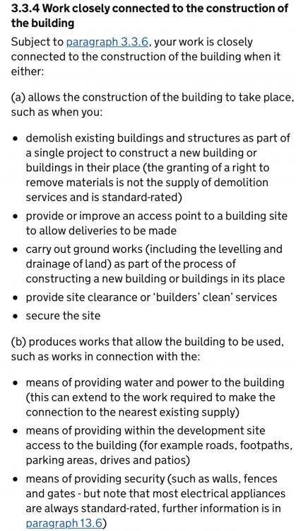

It counts as work closely connected to the construction of the building and thus is is eligible for zero rating. Point the company carrying it out at VAT Notice 708 and supply them with a copy of your planning permission.
VAT Notice 708
