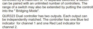

QU R323 dual receiver?
I've got one dual receiver for some garden lights, but that's not dimming, so I've got 3 or 4 dimming ones for most of the lighting.
