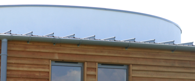

Mr Punter Posted October 29, 2019 Share Posted October 29, 2019 I have used some of the industrial aluminium stuff where they use a machine to zip the panels together onto halters fixed to the roof deck. This was supply and fix. 1 Link to comment Share on other sites More sharing options...
ianfish Posted October 29, 2019 Share Posted October 29, 2019 What energy rating did you achieve with your roof? Looks a well executed job Link to comment Share on other sites More sharing options...
