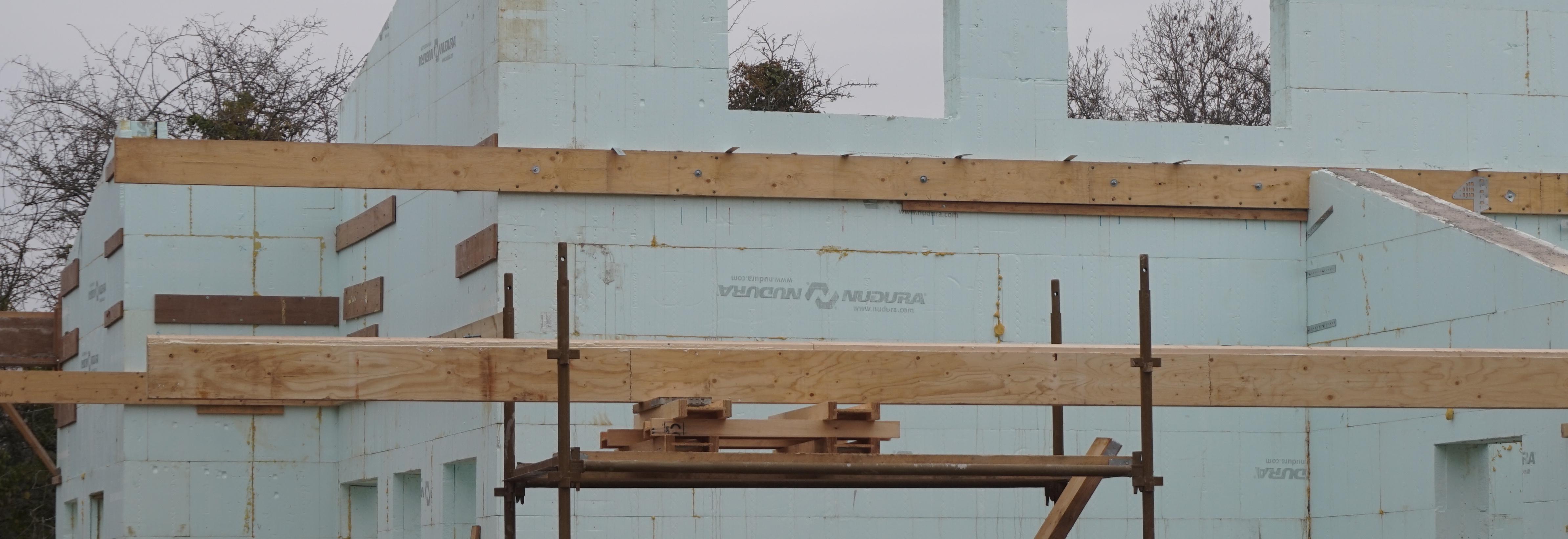

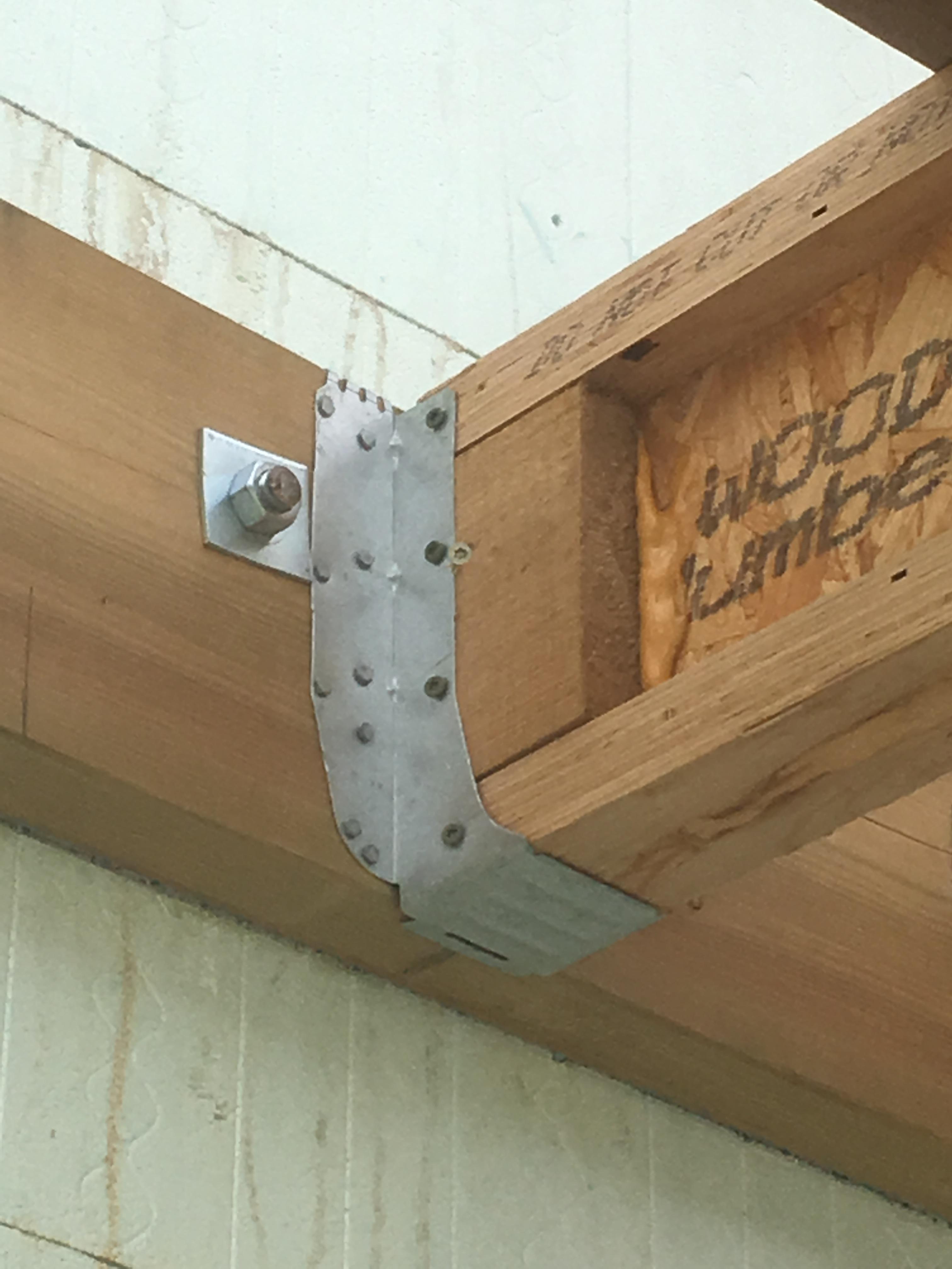

Russell griffiths Posted August 26, 2019 Posted August 26, 2019 (edited) For roof hold down 12mm spaced at 1200mm for first floor pole plate 16mm spaced either side of hangers, very over kill but they don’t cost a lot. First floor. Edited August 26, 2019 by Russell griffiths

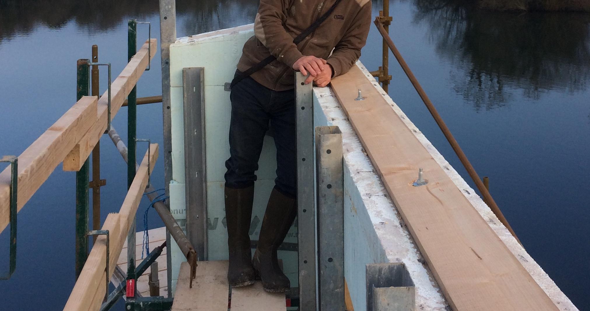

Russell griffiths Posted August 26, 2019 Posted August 26, 2019 Pole plate for roof rafters. The metal straps sticking out are restraint straps, embedded into concrete core. Wall plate for roof rafters.

Vijay Posted August 26, 2019 Author Posted August 26, 2019 59 minutes ago, Russell griffiths said: Pole plate for roof rafters. The metal straps sticking out are restraint straps, embedded into concrete core. Wall plate for roof rafters. What did you use to the wall plate for the roof rafters, J anchor bolts?

Russell griffiths Posted August 26, 2019 Posted August 26, 2019 What did you use to the wall plate for the roof rafters, J anchor bolts? not really sure what you mean by this @Vijay

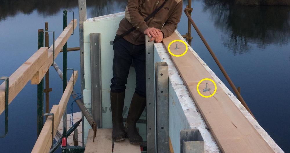

Vijay Posted August 27, 2019 Author Posted August 27, 2019 15 hours ago, Russell griffiths said: What did you use to the wall plate for the roof rafters, J anchor bolts? not really sure what you mean by this @Vijay Are the parts circled the straps you mentioned, as they look like bolts?
Russell griffiths Posted August 27, 2019 Posted August 27, 2019 Nope, the thing circled is a 12mm anchor stud, with an additional nut on the bottom instead of the J. in this pic you can see a flat strap on top of the pole plate, this is 40mm wide by 1.5mm thick it is embedded into the concrete core, I think you will only need this on a mono pitch with no ceiling rafters like mine as it is there to prevent spread.
