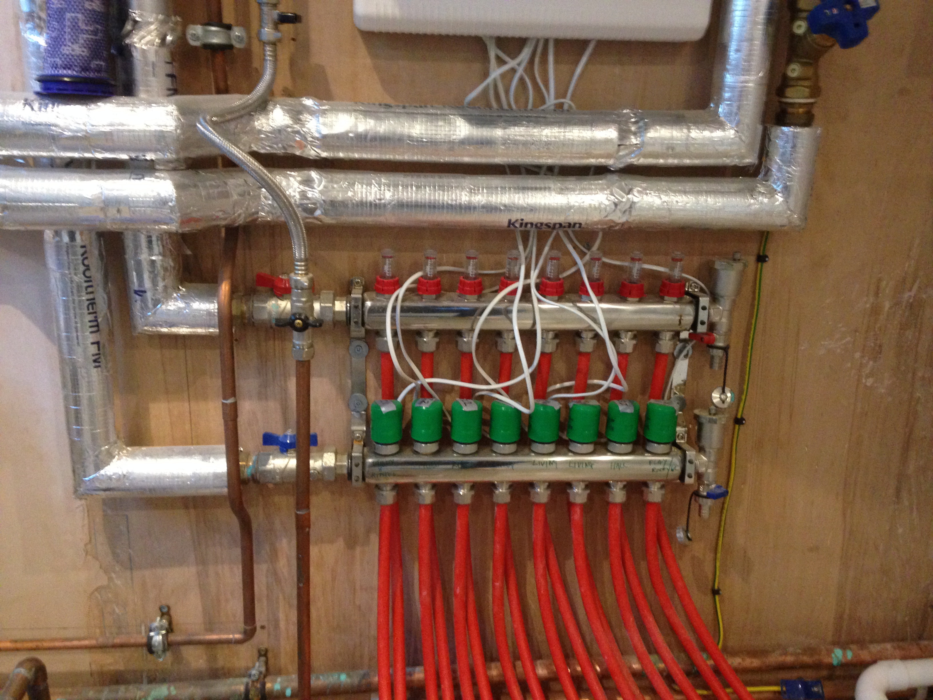

worldwidewebs Posted October 2, 2016 Share Posted October 2, 2016 We're just putting in the UFH pipes and I'm trying to work out the best position for the manifold but the best position for it is smaller than the alternative location. We have 5 zones but 9 loops (so 18 pipes in total) so I was assuming that we'd need an 18 port UFH manifold but the biggest ones I've seen are 12 port. Basically, what I want to know is what would be the length of the manifold plus pump, valves etc to suit our requirements? Link to comment Share on other sites More sharing options...

PeterW Posted October 2, 2016 Share Posted October 2, 2016 It's one port per loop as they are "stacked" on top of each other. A quick measure of mine it's about 40mm per port and then around 220mm for the pump etc so you would be around 600mm for a 9 port Link to comment Share on other sites More sharing options...

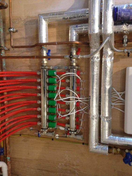

Mikey_1980 Posted October 2, 2016 Share Posted October 2, 2016 The below is a picture of our 8 port set up the total width is around 850mm Link to comment Share on other sites More sharing options...
