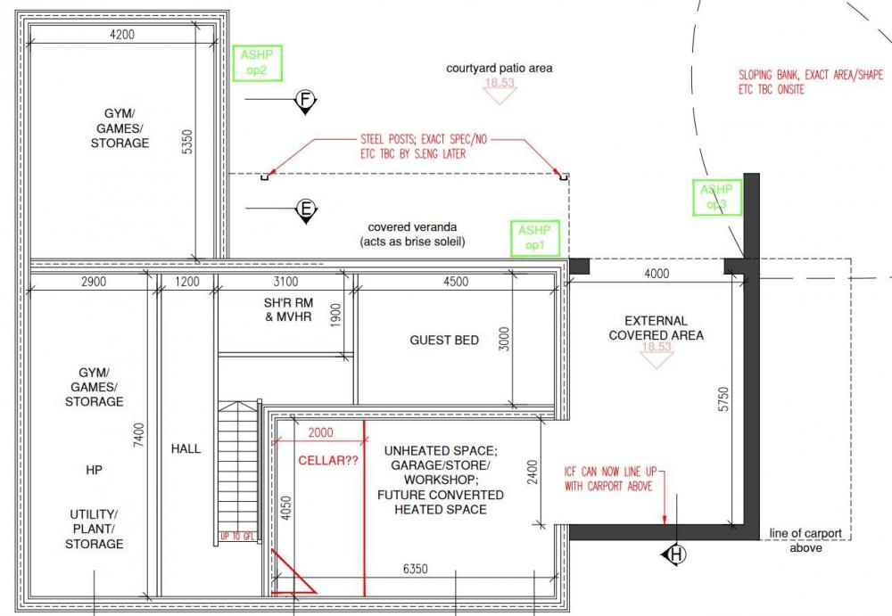

Our design has a partial basement that is only open to the south side. Space is precious on the ground floor and ceilings are vaulted on the first floor... So basement is only option.
Architect is proposing inlet and outlets of MVHR to be on the southern basement wall. Not ideal, but not a huge issue. ASHP also to 3b close by.
Issue I've raised is that these are all underneath a ground floor balcony. It will be 3m above the basement ground level and will only project 1.5m out and will be a slatted deck. Is air recirculation a potential issue here? We can still get the pipes 2m apart, but both will be under the covered area. ASHP can be about 4m away, but still under the covered area.
Very rough sketch landed in there now. MVHR ducts would be around the area annotated "E" on the drawing.
Thanks
Edited by Conor
I'd say there's probably a pretty high risk of some recirculation by having the external terminals under a covered area.  The main issue might be drawing in cooking smells, plus having cooking smells trapped under the covered area, I think.  I don't think there's an issue with having the fresh air intake under cover, the main concern I'd have is with the exhaust.  Is there any way you can somehow extend the exhaust beyond the covered veranda, or maybe up through it somehow (might look a bit messy, though)?
The ASHP will be fine under a covered area that's fairly open, but it may well locally cool the air a fair bit in winter (ours does, and that's in an open pathway about 2m wide, especially on still days).  Having the MVHR draw in air that's cooler than ambient is going to reduce its effectiveness a bit, so my inclination would be to try and position the ASHP as far away from the MVHR fresh air intake as you can.
