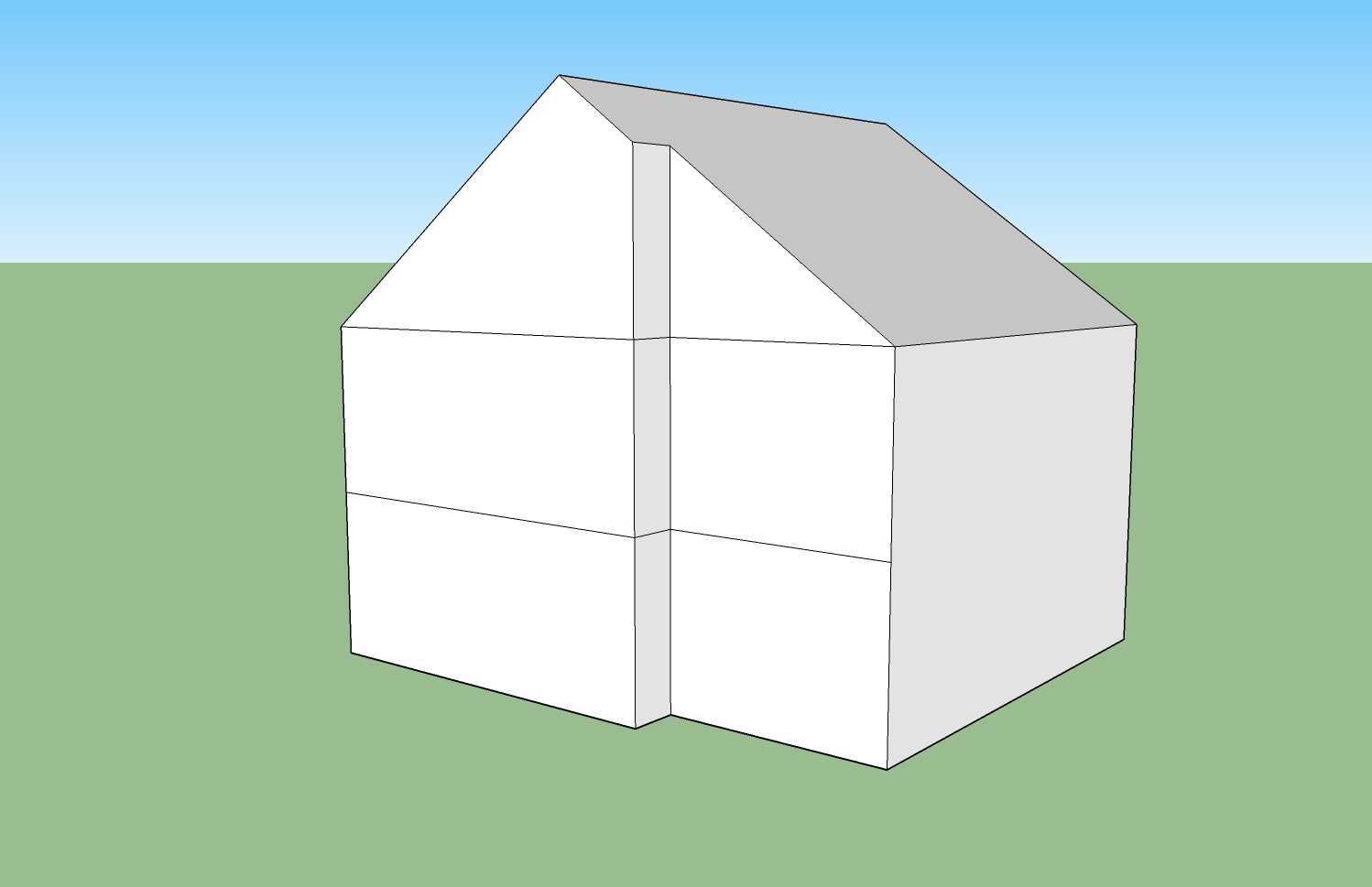

I have had a visit from a BCO who confirmed the foundation of our bungalow seems fine to take the load of an extra floor. Not sure whether I need to get it confirmed in writing but it is something for now. So I started looking at our plans more carefully.

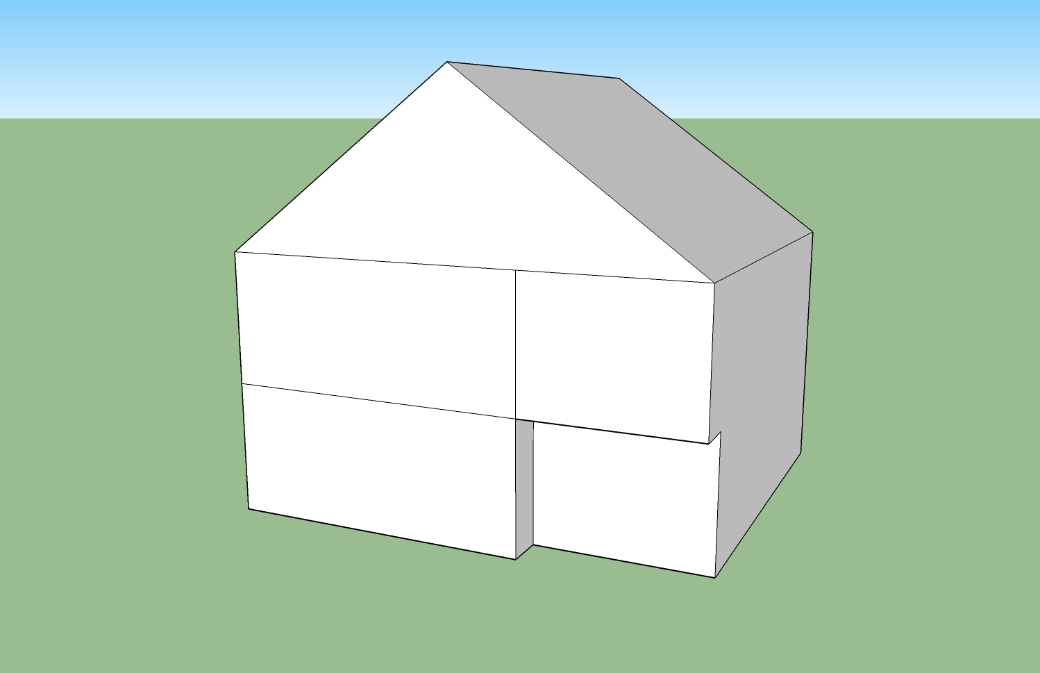

The option that we have so far is primitive : the first floor will have the same footprint as the ground floor with the exception of the bay window - see primitive sketch one for the view from the back, which is almost exactly east side. But that means we will be blocking already limited light for the large room on the right, like it is currently blocked for the living room on the ground floor.
So what if we go for cantilevered option - it only need to go out by about 1m. It seems to make certain bits much simpler but probably requires a steel support. Would it be substantially more expensive to build? Any advice please?

I would seriously look at extending the ground floor by that 1 metre so it enlarges the living room and solves the shading issue of the living room window and obviously solves the issue for upstairs as well.
Yes it's a new strip of foundations for that bit but probably no harder or more expensive than trying to cantilever the upstairs (which would only solve the shading issue for upstairs anyway)
I sometimes despair why the original designer stepped it back like that without regard to the shaddow it would cast.

That's what I said! There is about 50m of the garden, why not make this side longer rather than shorter is beyond me.
What extra cost (very roughly) are we talking about here if I were to extend downstairs? Digging foundation very close to the existing one, building 5m of the new wall probably with ICF? Will we be able to reuse the window and the door or will we have to buy new ones?
It's going to cost no more to extend the downstairs floor than build a cantilevered upper floor. Hard to say exactly, a few thousand pounds. The cantilever will have to hold up the whole wall and roof weight above. Often the cost of extending out the ground floor is steel support for the upper floor. In this case you are avoiding that. You are also fixing a problem that you have with shading. If anything you might want to extend that area to stick out past the rest of the house and then put in a  window that faces south.

I did think about extending this side more because it would cost almost the same and there is plenty of space. The only small downside is since we are on a slope from the garden towards the road some landscaping would be required. As long as the cost is manageable we will definitely consider it.
