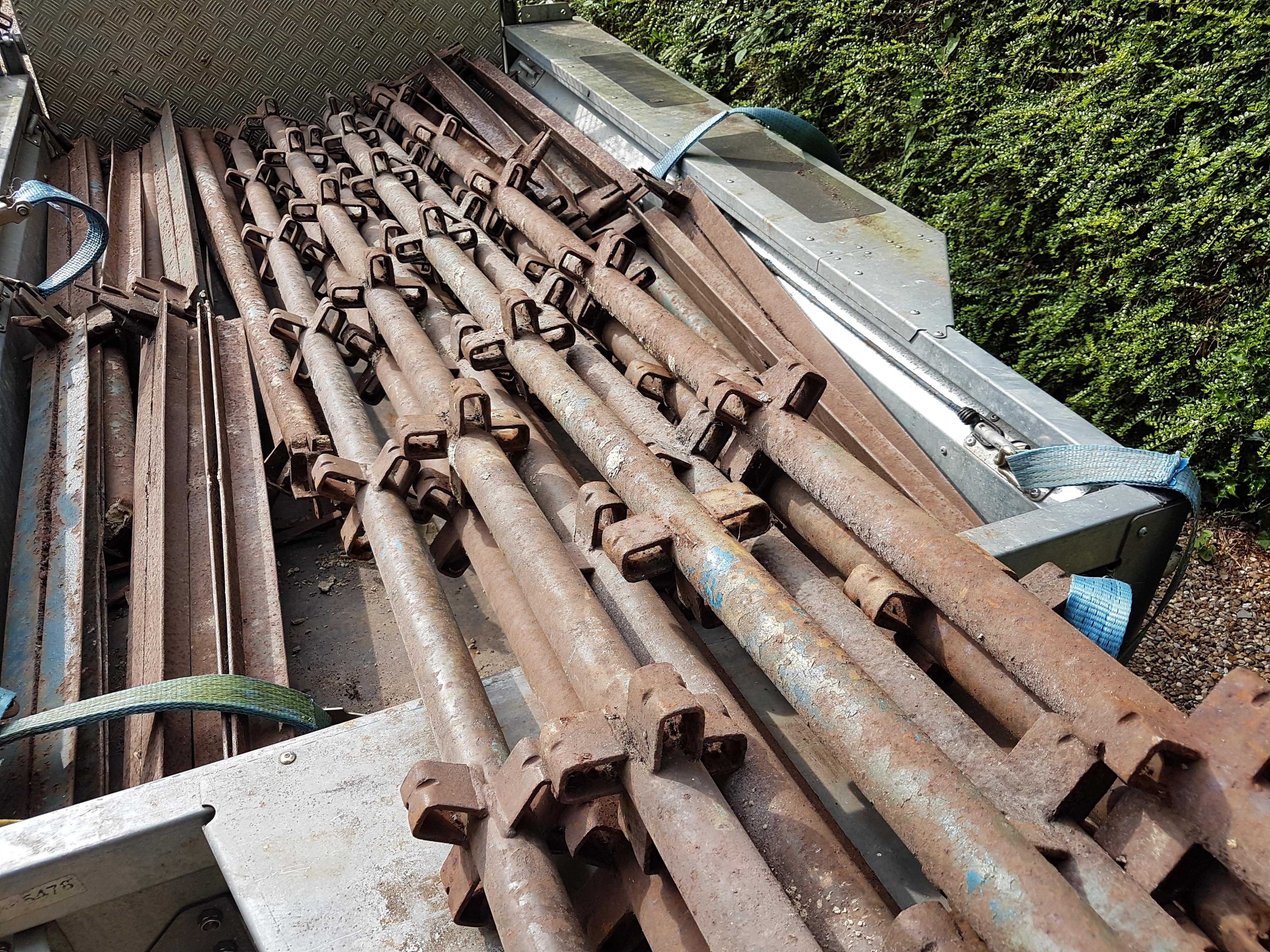

MikeSharp01 Posted August 3, 2019 Share Posted August 3, 2019 My brother in law offered me this stuff but although he has loads of it I am not sure he has all the bits so I thought I would see if I can find a manual. Sadly my googling has failed me - so not sure what it is so thought I would seek the collective wisdom. It is like kwickstage but has square pockets. I am using Kwikstage on site but this looks like it will be ideal for internal works. Link to comment Share on other sites More sharing options...
ToughButterCup Posted August 3, 2019 Share Posted August 3, 2019 It may well be old-design KwikStage. The transoms look familiar. For internal works get yer self four wheels. ?? Link to comment Share on other sites More sharing options...
ProDave Posted August 3, 2019 Share Posted August 3, 2019 Definitely an older variant on Kwikstage. When I was needing some planks I went to a local scaffold hire company. I did indeed buy some food used Kwikstage planks from him. He did a good job (but failed) of trying to sell me some of this square peg variant Kwikstage but I declined. It is okay for what it is as long as you have all the bits you need and accept you may never find and more of it, and can't mix it with the other stuff you have. Link to comment Share on other sites More sharing options...
