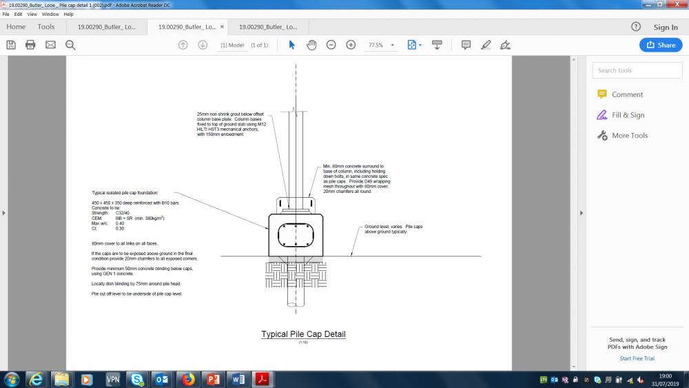

redtop Posted July 31, 2019 Share Posted July 31, 2019 (edited) so we have the design for the pile caps, need to decide whether to do ourselves or contract out. on top of the caps will be steel posts which lift the building off the ground; all designed by a SE. In the meantime can anyone explain in idiot speak the process for fitting these? I assume: put some hardcore around pile shutter and lay binding layer, let it go off fit formwork for cap fit steel re-enforcement inside formwork pour concrete fit 4 bolts using template so they will fit steel posts later leave to go off rinse and repeat 41 times ? we are getting levels, etc properly marked out, but does the above sound right and does anyone know what the term 'dishing' means? Also any idea re the hardcore depth? cheers all Edited July 31, 2019 by redtop Link to comment Share on other sites More sharing options...

redtop Posted July 31, 2019 Author Share Posted July 31, 2019 in particular what does 'locally dish' mean? Link to comment Share on other sites More sharing options...

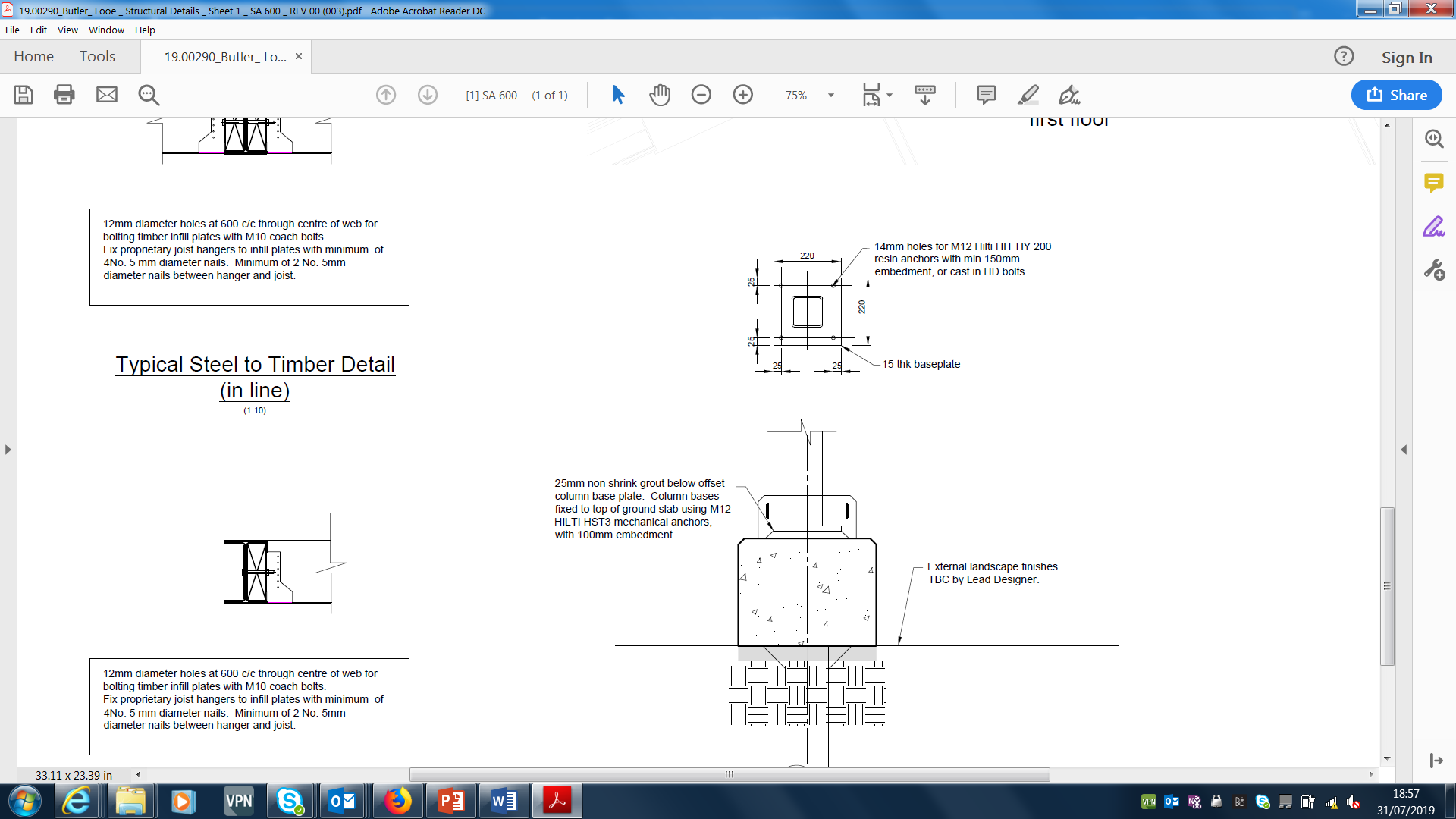

redtop Posted July 31, 2019 Author Share Posted July 31, 2019 have had quote for pre-formed rebar which i was going to use, but couldnt really understand drawing. I get 51 shape, easy to google. But is it 3 per cap and are tey connected via bars? Just want to make sure i order right ? Pre-formed shuttering.... never heard of such a thing Link to comment Share on other sites More sharing options...
Russell griffiths Posted August 1, 2019 Share Posted August 1, 2019 Have a look at SWIFTFORM from total construction supplies, mention me if you talk to them, it’s my footings on their website. Have you got a steel layout drawing and a bar bending schedule. If you have the bar bending schedule it will make your drawing make more sense for example. You have 41 caps, if your schedule says 123 links then it sort of gives the idea that you have 3 links per cap, if it lists straight bar then that will give you a rough idea that they may be joined with bars, go back to your drawing and it might get clearer. If you are casting bolts into the top of the cap are you aware of all the products you can use that allows bolt placement with a degree of movement so you can line up your steel before you grout. Link to comment Share on other sites More sharing options...
Russell griffiths Posted August 1, 2019 Share Posted August 1, 2019 Just looked at the drawing you put up it shows links with 6 bars in them, this might just be an example so look at the exact pile cap drawing. Link to comment Share on other sites More sharing options...

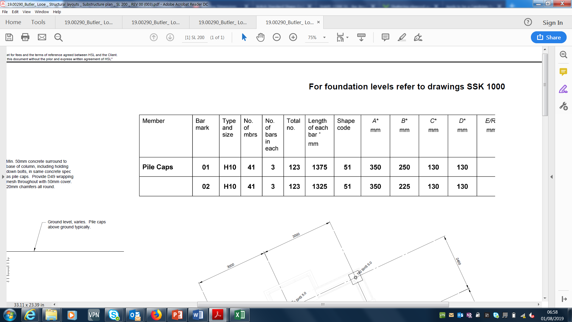

redtop Posted August 1, 2019 Author Share Posted August 1, 2019 so it says:- Link to comment Share on other sites More sharing options...
Russell griffiths Posted August 1, 2019 Share Posted August 1, 2019 (edited) You will need a drawing to confirm this but looking at that schedule bar mark 01. Is 350 x 250 bar mark 02. Is 350x225. i am presuming here as I cannot see everything but I would think the 3 smaller links insert into the 3 bigger links, at 90 degrees to them so 3 links one way and 3 links the other, they will all need tying on the corners to keep it square. You finished rebar will look like a box or like a very very poor example of a bird cage. Edited August 1, 2019 by Russell griffiths Link to comment Share on other sites More sharing options...
redtop Posted August 1, 2019 Author Share Posted August 1, 2019 i cant even see where bar mark 1 and 2 are lol. SE is away until end of aug so i guess it will have to wait. there are 41 piles and they are all the same Link to comment Share on other sites More sharing options...

Russell griffiths Posted August 1, 2019 Share Posted August 1, 2019 5 hours ago, redtop said: i cant even see where bar mark 1 and 2 are lol. SE is away until end of aug so i guess it will have to wait. there are 41 piles and they are all the same Bar mark is in the first column of your steel schedule Link to comment Share on other sites More sharing options...

redtop Posted August 1, 2019 Author Share Posted August 1, 2019 i know the answer to the second option was due to twisting forces in the piles as they are quite narrow. no idea re steel pile cap. I have gone through the drawings and still have no idea of where the bar marks can be found in the drawings. As there are only 41 piles why do i have bar 01 and 02 each with 41 piles and a slight dif in the rebar lengths... Link to comment Share on other sites More sharing options...
