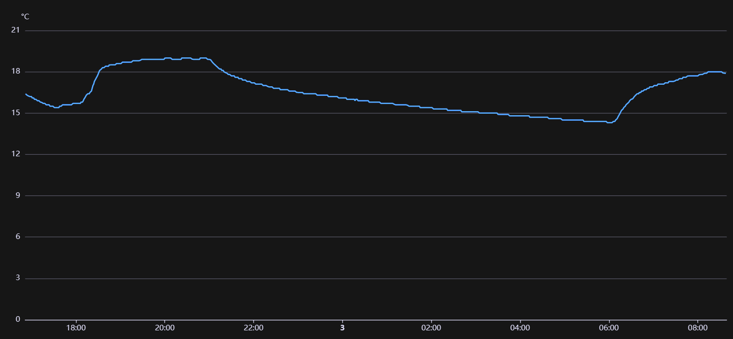

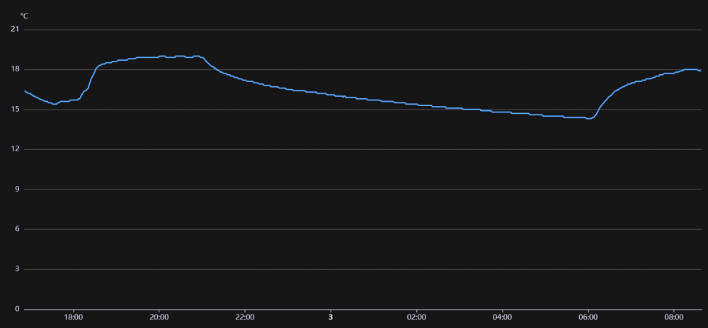

Gooman Posted November 3, 2021 Author Posted November 3, 2021 FYI, a classic temperature curve with warm-air heating ... you can clearly see how the system throttles back the heat demand as it warms up and even spot the cycling of the temperature to within 0.1 of a degree once it reaches temperature.
SteamyTea Posted November 3, 2021 Posted November 3, 2021 52 minutes ago, Gooman said: you can clearly see how the system throttles back the heat demand as it warms up Or just follows the heating curve formula. T = 1-(e-kt)
Gooman Posted November 3, 2021 Author Posted November 3, 2021 Yes indeed, but that's not the way that a traditional gas boiler+radiators wet system behaves. This is what you get with a traditional on/off thermostat: Opentherm improves things somewhat, removing the overshoot: (both graphs from https://theevohomeshop.co.uk/content/21-What-is-OpenTherm-and-why-use-Honeywell-evohome-with-it) But you'll notice in both cases that the temperature increase is linear. By contrast the rising curve on the warm air system changes gradient as it gets close to the target temperature.
