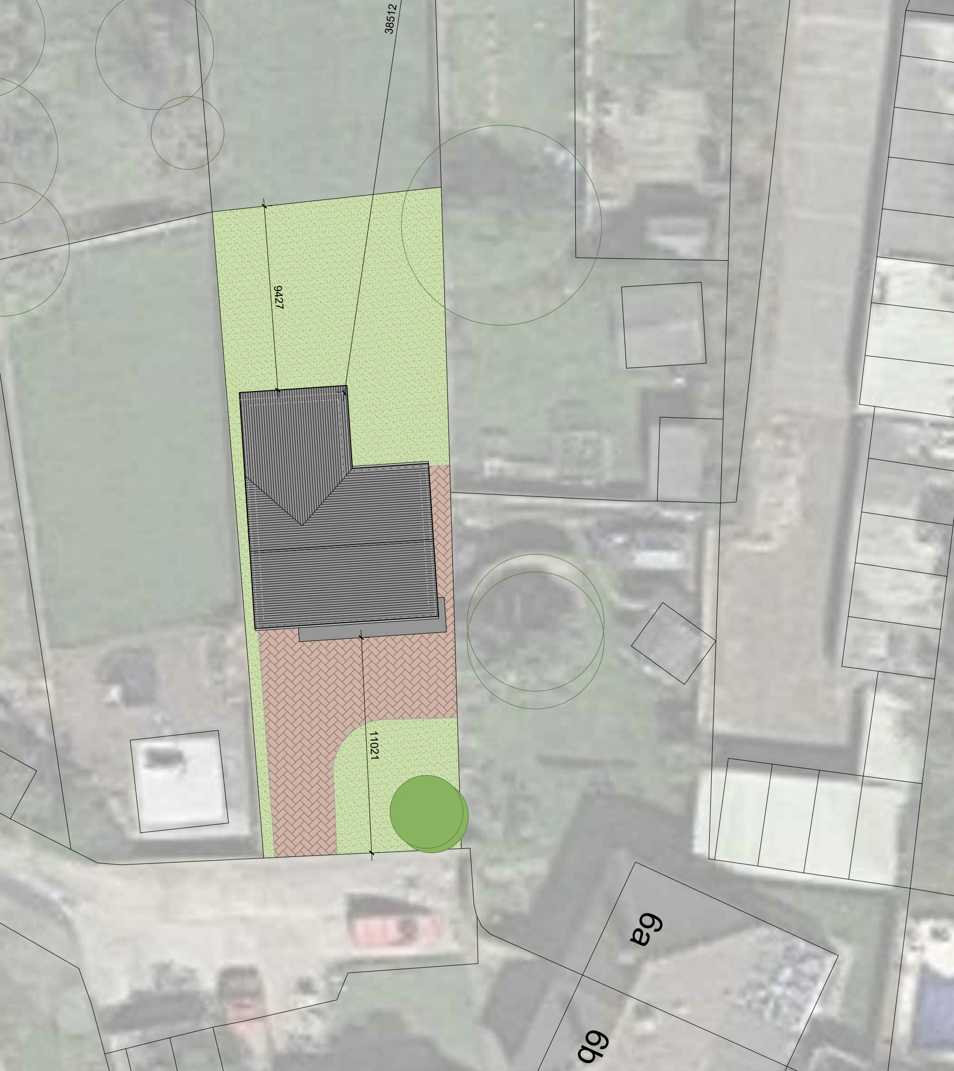

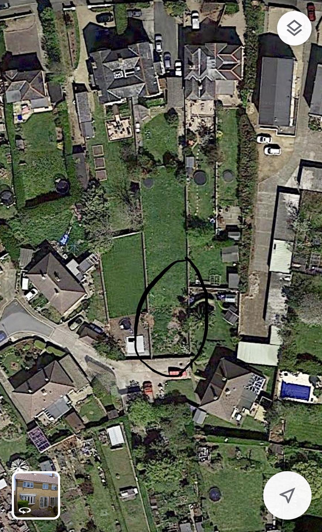

SteamyTea Posted July 22, 2019 Share Posted July 22, 2019 Is it just me or does it seems a small plot to put a £200,000 build on. 3 hours ago, BrettW said: Link to comment Share on other sites More sharing options...
BrettW Posted July 22, 2019 Author Share Posted July 22, 2019 4 minutes ago, SteamyTea said: Is it just me or does it seems a small plot to put a £200,000 build on. That circle is super rough. It’s actually 10.5m by 30m plot. Cheers Link to comment Share on other sites More sharing options...

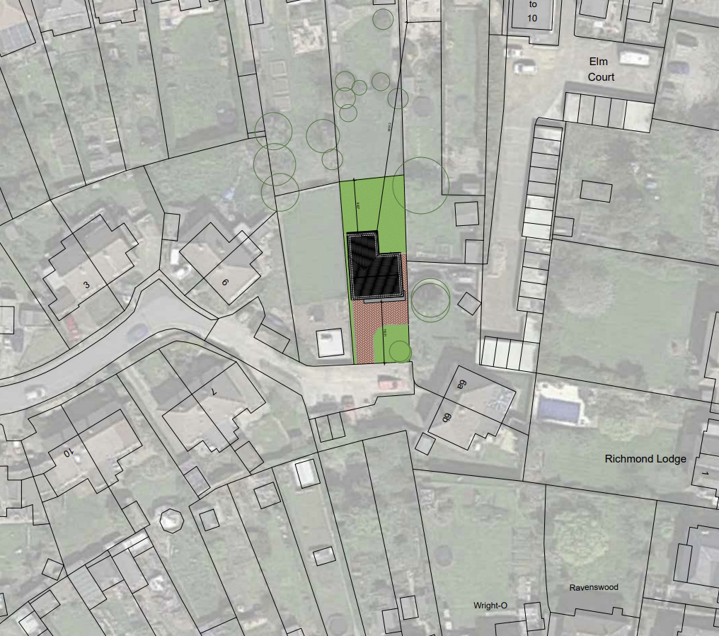

BrettW Posted July 22, 2019 Author Share Posted July 22, 2019 (edited) You can see a very early draft example (THIS ISNT THE HOUSE WE ARE PLANNING, PURELY BOILERPLATE 4 BEDROOM DETACHED DWELLING TO SHOW THE NEIGHBOUR ) .. Brett Edited July 22, 2019 by BrettW Link to comment Share on other sites More sharing options...
Ferdinand Posted July 22, 2019 Share Posted July 22, 2019 (edited) This looks like a good project, with a number of potholes on the way. My brief comments 1 - Get a formal valuation at the point of gift. It is a matter of judgement whether to maximise or minimise this within justifiable guidelines, depending on your parents’ estate size and if they are in their last 7 years. Logic probably says minimise and get the uplift in your name. Will really help with all kinds of future conversations with authorities. 2 - You may be shocked by the access bill. Case law says it can reasonably be a third of the uplift it generates in the value of the plot.So begin recording irrefutably everything you spend, so in theory expenses can be deducted. But he may just alight on a price, and in a sellers market of one you are probably a little powerless. Grin and bear it. 3 - Get used to holding a poker face and reflecting before reacting, even if someone says they are going to insert a porcupine in your posterior, backwards. The pause to think, and keeping stum, are really critical skills. 4 - Talking about land as a deposit is confusing. I would suggest ‘equity’ is a better word. Their are BSs out there that will treat it just the same. Try Penrith for one. Ferdinand Edited July 22, 2019 by Ferdinand Link to comment Share on other sites More sharing options...
BrettW Posted July 22, 2019 Author Share Posted July 22, 2019 Thanks @Ferdinand great advice! Glad you see it as a possible/positive project, i appreciate its access thats key right now.. Yep planner made us aware about it being a third of the uplift plot value, curious to know more about expenses though? What kind of expenses can be 'included' right now ive paid around £270 in getting a planner round and a quick sketch as above...keen to not go for planning until we know we have access, would an agreement with the neighbour be a conditional agreement? Thanks again Brett Link to comment Share on other sites More sharing options...
Ferdinand Posted July 22, 2019 Share Posted July 22, 2019 (edited) 42 minutes ago, BrettW said: Yep planner made us aware about it being a third of the uplift plot value, curious to know more about expenses though? What kind of expenses can be 'included' right now ive paid around £270 in getting a planner round and a quick sketch as above...keen to not go for planning until we know we have access, would an agreement with the neighbour be a conditional agreement? Sounds like you need to apply a little cost-control to your planner, or at least some discipline. Unless there is a hefty copyright fee or something else in that £270. £270 should be the best part of a day for a normal Plannign Consultant, and that plan did not take a day (imo). Whatever you negotiate and he accepts. It would be reasonable to include eg survey costs, valuer costs, legal costs as things to count against the uplift imo. If you ask your legal advisers they may have a schedule of normal practice. Just do not put yourself in the position where there are things on the list you cannot prove. Again, the agreement is what you negotiate, though without PP there would be no uplift so a conditional agreement is likely. If you get him to accept a fixed price offer, then you make a judgement call based on your estimate of what you can achieve vs what he wants. You also need to check just in case you already have prescriptive access for what you need to do down that route. eg if you have the right to drive down it then potentially services could go the other way and you may just need to say "I'm building this house and wanted to let you know I will be building a drive", rather than "I accept I may need to cross your palm with silver." The sort of games you can play are to get agreement for access to a rear entrance to the existing for say a garage, or something that only applies to one PP and do it in 2 jumps with a small uplift first, or carefully worded such that it covers the both. But that would be sharp-elbowed, and not a good thing to do to neighbours. For all of that you want a local recommended property type experienced solicitor who should have all the agreement boilerplate in their computer, and will be a great help. Look at local firms with one to perhaps five branches who have several partners and someone specialising in property. If you get up to a regional firm with a corporate car park in the local city your wallet will definitely know about it. I always say that for a recommendation ask a qualified professional surveyor ideally a RICS at your established local estate agent. You want to talk to the hoariest old git in the back office - the one who looks either heavily stressed like Captain Pugwash with a pepper-and-salt beard and 6 unwashed cups of tea on the desk, or the one who looks relaxed and extremely well-lunched. But in any case the one who has been there for 15 years or more. F Edited July 22, 2019 by Ferdinand Link to comment Share on other sites More sharing options...
BrettW Posted July 22, 2019 Author Share Posted July 22, 2019 10 minutes ago, Ferdinand said: Sounds like you need to apply a little cost-control to your planner, or at least some discipline. Unless there is a hefty copyright fee or something else in that £270. £270 should be the best part of a day for a normal Plannign Consultant, and that plan did not take a day (imo). I should clarify, ive paid £140 + VAT (£168) for the planner to come to the plot, give his opinion, create a full report with research and his viewpoint (thinks planning permission is achievable) And ive spent £100 for my architect (whos also a friend) to do that plan plus he's helped on a few other bits... Cheers Brett Link to comment Share on other sites More sharing options...
